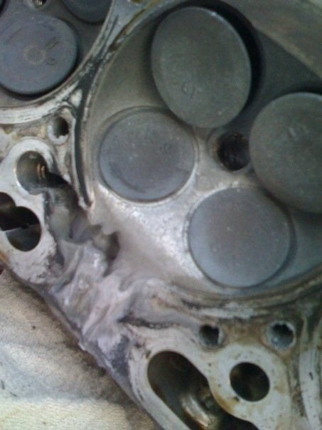

They also like going full soft and melting when they are overheated... This happened during a time attack when our driver didn't like to look at the gauges... lol

That's more than just elevated coolant temps, it looks like some nasty preignition. Usually it's either the head/block deck or the piston crown that ends up with a hole in it. Heavy preigntion won't get picked up by a knock sensor in some cases.

Thats simply the headgasket having a full failure, at which point combustion gasses make themselves a nice little ventilation port and cut/melt the head as they go out.
Hahaha, I know, I was being dramatic. I'm also not wrong in my statement, it got really hot and went soft. :P
It was indeed the HG then the steam got to cuttin'... while the driver ignored the temp gauge. The only thing that caught his attention finally was the white smoke coming out every where.

Yeah it happens some times. And that amount of damage can happen much more quickly than you think once the gasket lets go.

Yeesh, Ive blown quite a few head gaskets over the last 20 years of 4G63 playing but never bad enough to do that. Granted, E85 and moderate boost/timing typically keeps things safe. But just seeing that makes me happy I pulled the head for some cleanup.
