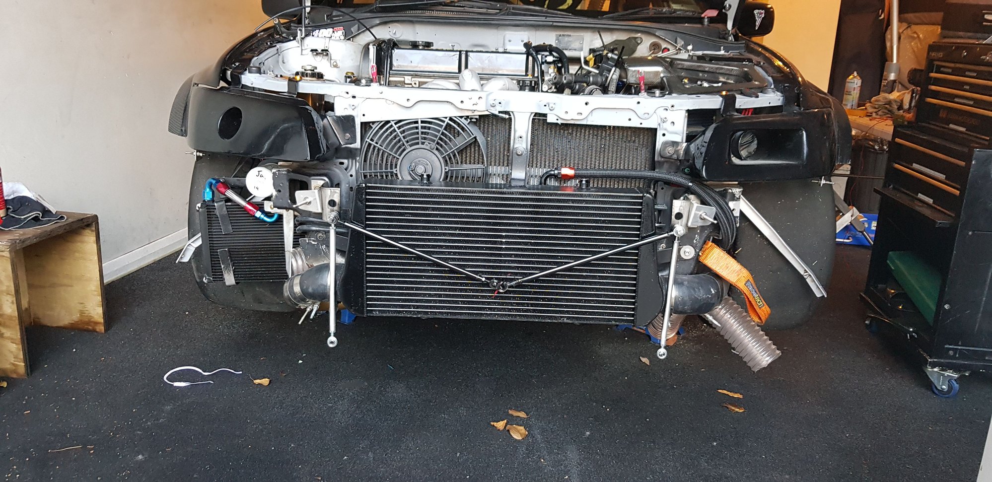

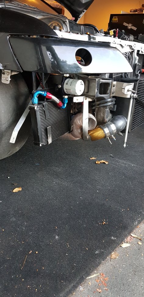

Heres a couple photos of my splitter. think im one of the people you mentioned whos already posted them before but got lost further up so heres a refresher
Bascially 4 tie rods with adjustable length ball joints on the end. the 2 middle ones infront of the intercooler are just cable tied out the way and normally they attach to the middle of the splitter behind the bumper. They are held in with 4 quick release pins similar to these: http://www.wdsltd.co.uk/product/5245...-pins-wds-954/
The 2 angled strips infront of the tires are held with a screw to the bumper itself for rigidity. we found the splitter was making downforce and sucking back into the tires. the bumper is on quick latches and gets screwed to the splitter along the front and side. takes about 5min to remove bumpe rn splitter completely

I like the idea of grabbing air for the brakes from the diffusers. That solves the mess of snaking around the oil cooler/ACD pump.
I know I can make my own.. but if someone would do a how-to or at least post a recommended parts list, I'd gladly pay. I have to order most, if not all my hardware, as I don't have any decent stuff locally. Ordering, getting the wrong thing, then re-ordering is expensive and extremely time consuming.
FWIW if I buy one from ayoustin, I'd swear myself to secrecy and not give out the build info. ... and probably still finish mine, for funsies
I'm hoping to not need brake ducts with the built X calipers and 2pc rotor. But this is a nice solution and you can still close off the front with shutters.
Depends how long your on track for and how much power etc etc. my stock brembos would cook after 3 laps.
Yea works real good cause its not often we actually remove the splitter itself normally just take the bumper off to service which means we can keep the ducts hooked up. it also means u dnt have to try snake em through
