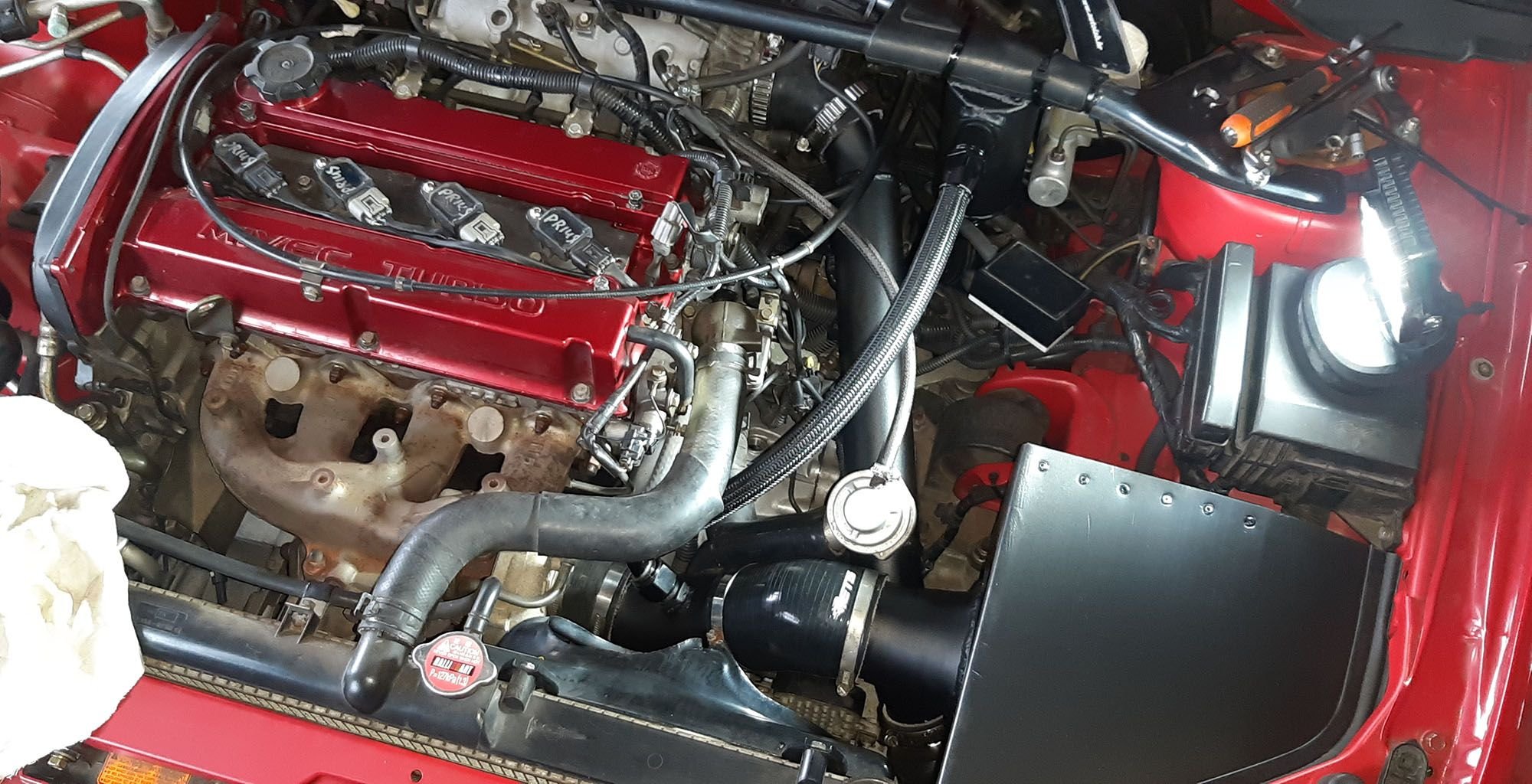

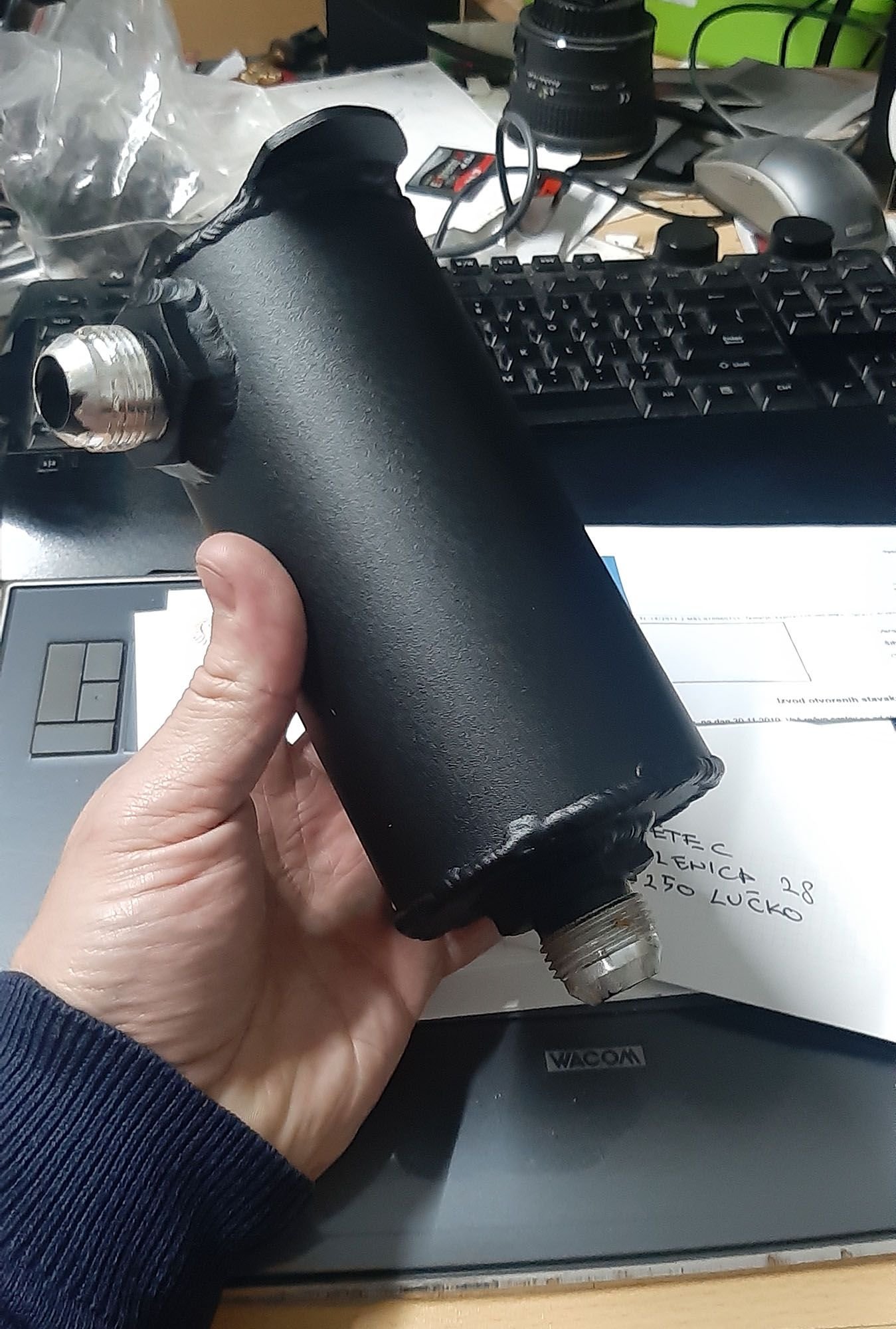

Finishing up the forged hks 7460 kai build for a friend. This car uses my block that I drilled and welded on a 12AN vent. So I built a oil separator with interior baffles that drains back to the block. Used some nice plastic sheet to form up a air box and finished the intake piping. The ETS intake went to the bin, apart from the silicone elbow. The local powder coater has some nice rough finish available.. almost crackle finish, so I used that on the intake..

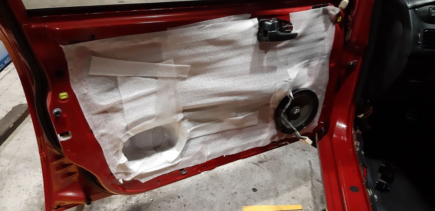

from the "nothing to do with motorsport" file... The clear plastic film that is installed on the doors got ripped apart when we took the doors apart, so I managed to find this stuff made by Foerch in germany. Self adhesive thin foam made for just this purpose.. Adds a bit of sound insulation and doesnt weighh anything.. almost..
