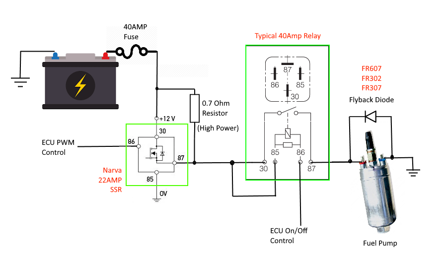

Here is how I did my fuel pump wiring setup with the Emtron.
OEM high power fuel pump resistor, using a Solid State Relay (SSR) to increase fuel pump voltage as I need it with PWM.
Not all the current goes through the SSR, as I was having relay overheating problems (80ºC).
The Emtron uses fuel temp and pressure to work out fuel mass. So even if there is pressure drops or spikes, the ECU does all the compensation work for me.

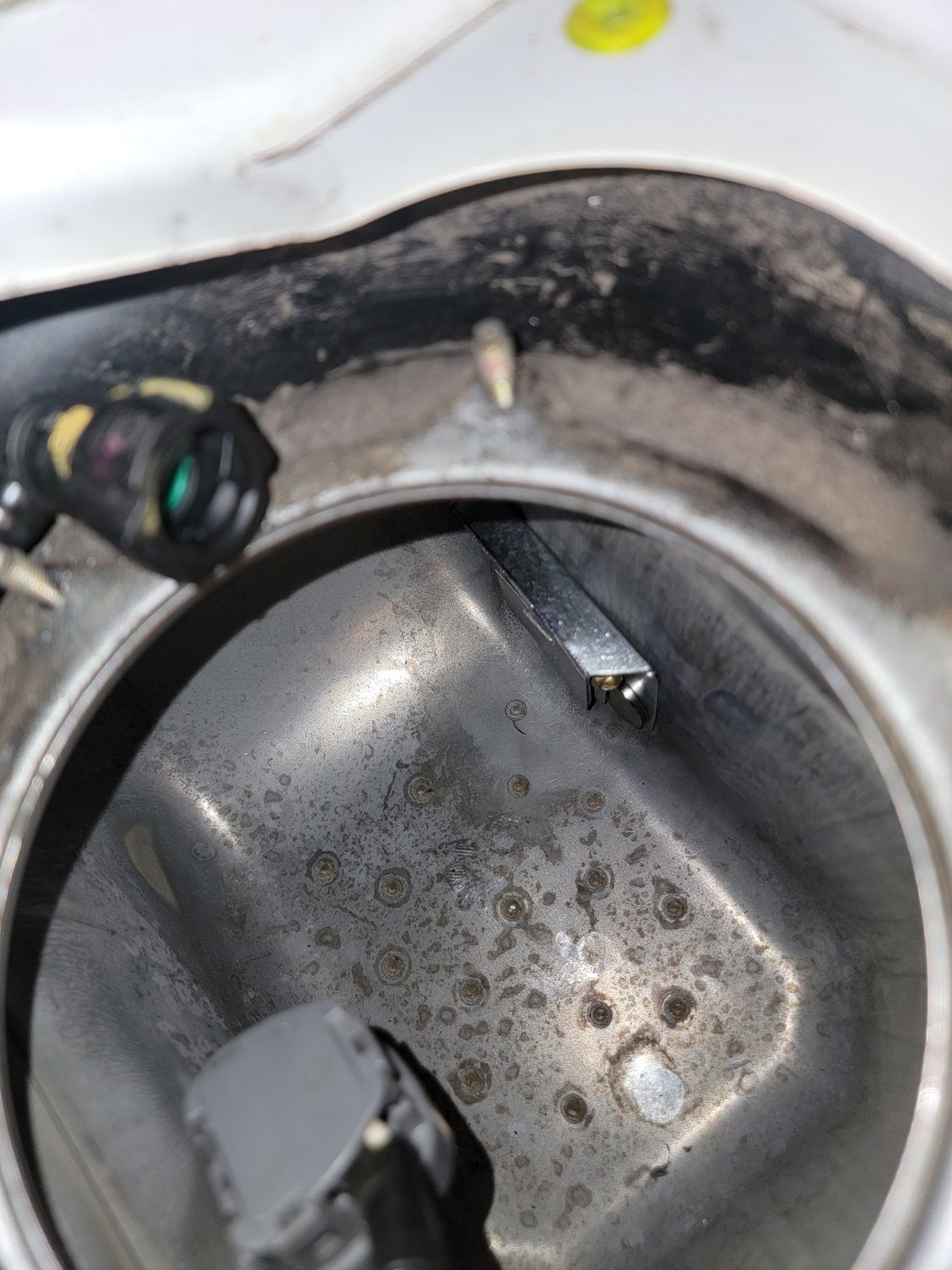

Speaking of surge tanks, this was my winter project/experiment... to try and turn this thing into a surge tank. I'm using strong magnets and non-magnetic materials. I have these materials submerged in e85 for over a month to test. Not tested with gasoline yet. Anyway as expected, when i fill this bowl it takes over a minute until it stops draining out. i'm not sure yet how the DR side syphon thing works at aroud 1/4 tank but i'm open to pumping fuel from the drain plug to the return hose, to ensure this bowl is filled.

just mount a swirl pot in the boot like all us simpletons do lol.
I can't find any configuration I like. too many damned hoses and fittings lol
