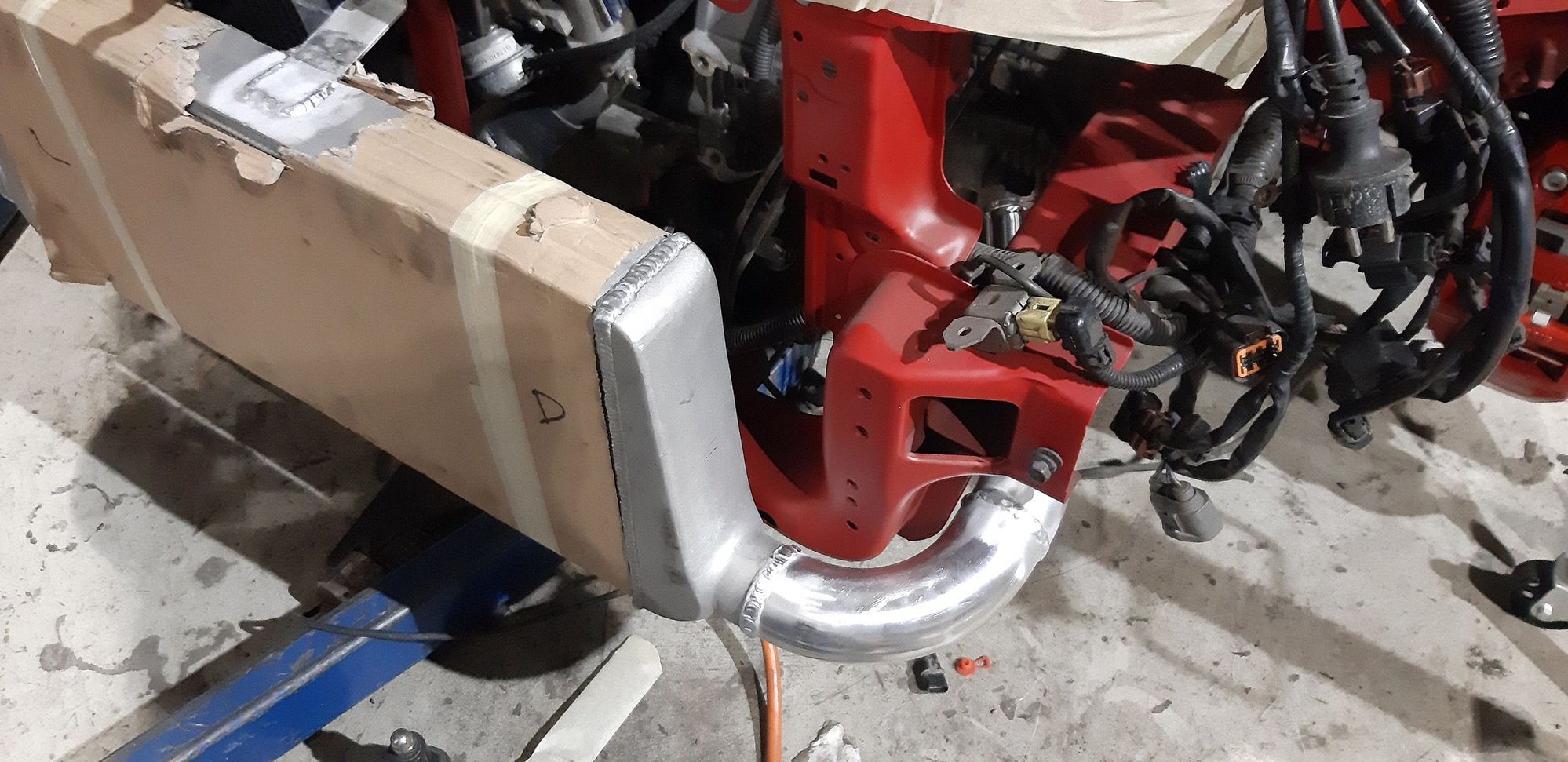

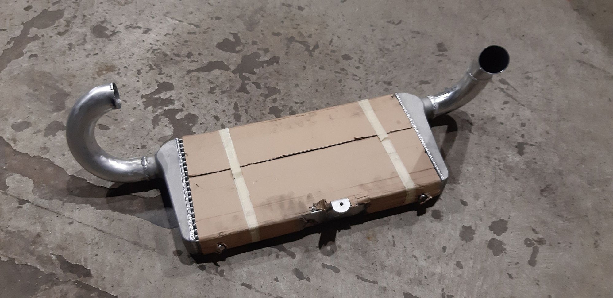

I have been busy not working on my car but rather doing a major overhaul / restoration of a friends evo 9. One of the things we did was put on a new tube and fin IC (rather cheap one really) but instead of just clamping everything togeather with numerous clamps and silicone hoses I welded on the first few bends so it is a bit cleaner install with less points of failure.. Upper IC hose has the DV welded on too (OE DV)... Will put up that pic later, when it is installed..
I've actually wanted to do the same. Not on the FMIC, though since I'm afraid I'd damage something and then have do more cutting/welding on a pricey part. Seeing how you guys are using a cheaper one, though.. maybe not that big of a deal. But yeah.. less clamps = more awesome. I'm still on the OEM stuff, so lots and lots and lots of clamps

The first core had less tubes and thicker core, but still was a nice tube and fin design with solid ammount of thin fins on the inside and outside. Then I bought this "improved" verrsion, with thinner core, but more thinner tubes... The first one worked well (I do measure inlet temps and temp rise) so I wanted to clean up the inlet piping and do something I wanted to do for my own car really... On my car I will probably fabricate the end tanks too.. As for cheap... this is a 176 EUR IC... which is what.. 190 USD.. and that is with 20% tax..
https://www.turbozentrum.de/Intercoo...BOOST-products

Since the intercooler core is hard-mounted to the chassis and the piping connects to the engine, which moves around, are you at all worried about stressing the core or losing too much flex in the system by welding those piping connections? Maybe having stiff engine mounts would alleviate that concern.
each tube connecting the IC to the engine has a flexible silicone tube at each end.. so there is room for the engine to move.... I am usually overzealous about engine movement.. My downpipes have 2 felx joints..
Will post pics when I am done..
Yep basically as long as u have silicone somewhere ull be fine. I have silicone off the intercooler and a wiggins at the throttlebody and its fine. Rigid mounts help also with this however
