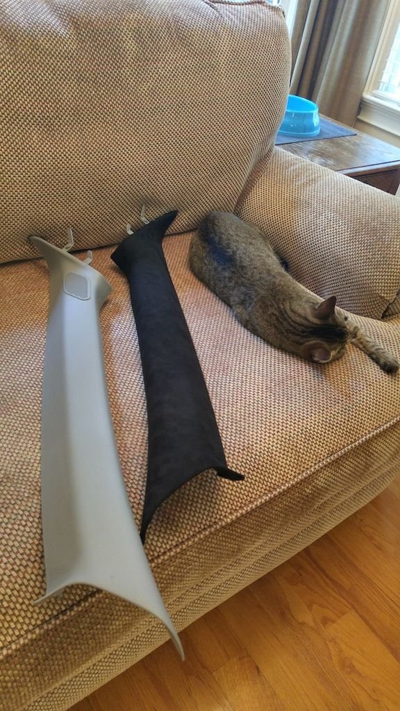

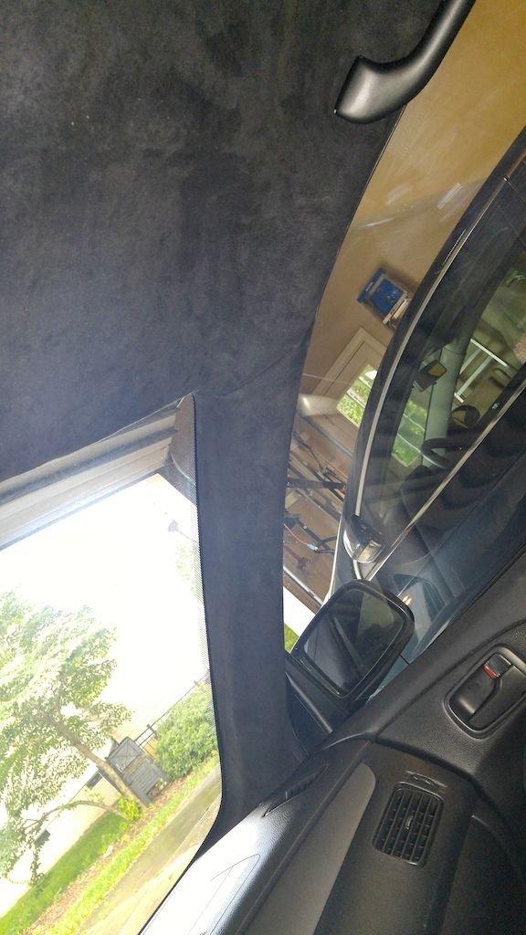

Wrapping the A-pillars

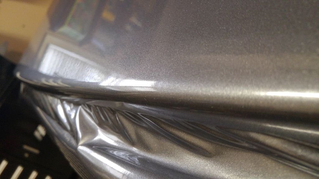

I don't know what I'm doing
The vinyl-wrap learning curve is quite steep.
Close up shot of the 3M Anthracite gloss

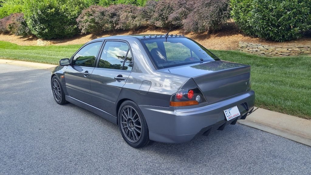

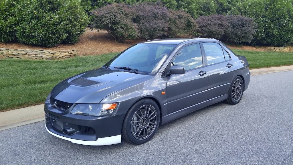

DMV SUCCESS!
Forgot to post about my recent triumph
The Evo is inspected, titled, registered, and insured!
I also wrapped the rear bumper cover and trunk
And a shot of the front, since it has been a while

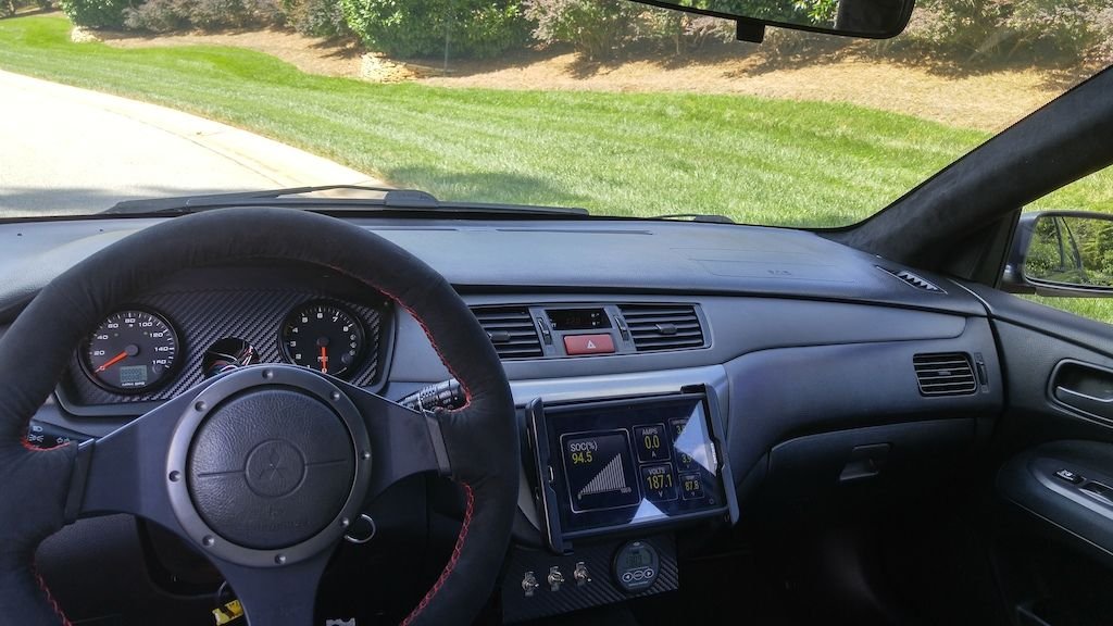

Guess I was pic happy
so here are a couple of side-project updates
FULL interior is 100% reinstalled, much more comfortable now
Testing a 40 cell (82V) portion of the gas-tank pack.
