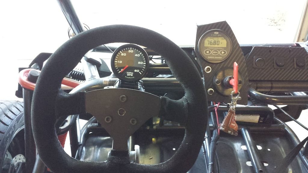

I've already built and quite thoroughly tested a single gear EV. It had a torque to weight ratio of about 1:9. What I learned from that build has been used in this Evo project. Some of my observations from that build:
-In order to overcome the vehicle's inertia, the motor controller had to pull unacceptably high current from the battery which: increased motor temp, increased controller temp, increased commutator/brush wear, decreased range, and decreased overall efficiency.
-To hit the vehicle's intended top speed, I had to spin the crap out of the motor which: increased back EMF, increased motor temp, and decreased efficiency.
-Thus, I had to play the balancing act of top speed vs low end torque all while minimizing losses to thermal inefficiencies. To achieve a decent balance, I varied my drive and driven gear ratio (went through about 6 or 7 different combinations). I was never totally satisfied with the motor's performance, which was the top of its class but also a budget-conscious purchase. I either had to sacrifice low end grunt for a satisfactory top speed or accept a relatively low top speed for exciting off-the-line acceleration. Adding just one more forward gear would have drastically increased vehicle performance, even when accounting for transmission losses.
*It's worthwhile to note that the motor/controller package for my single gear vehicle cost around $1100. If I had been willing to spend $6000 on a motor/controller package, I would have likely been pleased with vehicle performance despite the single gear. In the end, budget is the limiting factor. If budget wasn't a concern, I'd walk right into the Mercedes F1 team and hire them to build an electric powerplant for my Evo
A single gear is a hugely limiting factor, especially when coupled with a motor that makes all its power in a restricted rpm range (consider the necessity of multiple gears in diesel semi-trucks). A 5 speed transmission is a relatively inexpensive means to increase motor usability, increase vehicle range, decrease system operating temp, and retain AWD. Tesla really is the benchmark for EVs, so I completely understand the inclination to compare my Evo to one of them. I really admire Teslas, but my Evo is nothing like them in design, function, and (most importantly) price -I could build 6 of my Evos for the price of a Model S.
Here are a few videos of my single gear experiment.
1. 0-Vmax run with 3.9:1 gear and heavy prismatic battery. Not geared for top speed or best acceleration, but a happy medium.
http://www.dailymotion.com/video/x2o87bl
2. Some features of the build with its large 7.7kWh LiFePO4 pack.
http://www.dailymotion.com/video/x2nmaa4
3. Cold weather testing an early iteration, light weight and low power.
http://www.dailymotion.com/video/x2i2ycu
Here are a few pictures
