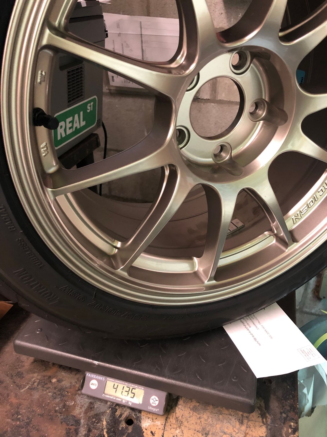

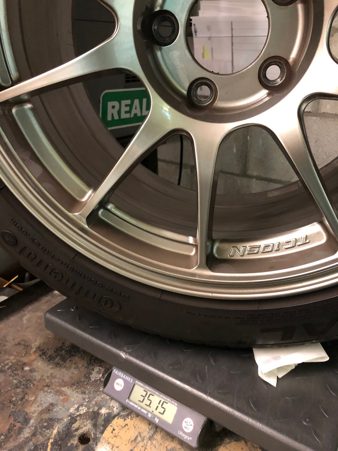

So after running some borrowed RE71R's at the autocross a few weeks ago I wanted to compare them to my Continental extreme contact tires. I bought the Conti's years ago since it was a lightweight tire and handled well in the wet Florida summers. I had also gone from the stock 4.53 final drive to the 4.11 final drive and wanted the lightest 25" tire possible to try and regain some of the acceleration I lost. I like to keep rotational weight down so its easier on the driveline. Now, These are two different sets of wheels so assuming the wheel weight is the same the new RE71R weighs 5-6lbs more then a nearly spent Continental. Same 255-40-17 25" tire The RE71R's are a MUCH better tire for auto x and high speed stuff. Stiffer sidewall and a heavier duty tire for street/track use. They do pickup everything and sandblast the cars paint going down the road. The Conti's hooked really well with the 4.11 gearing but now struggle with the 4.31 gearing in first and second . The steering isn't as sharp with them but they still work well on the street and will slide on request . The ride quality seems slightly better with the Conti's with the softer sidewall.
