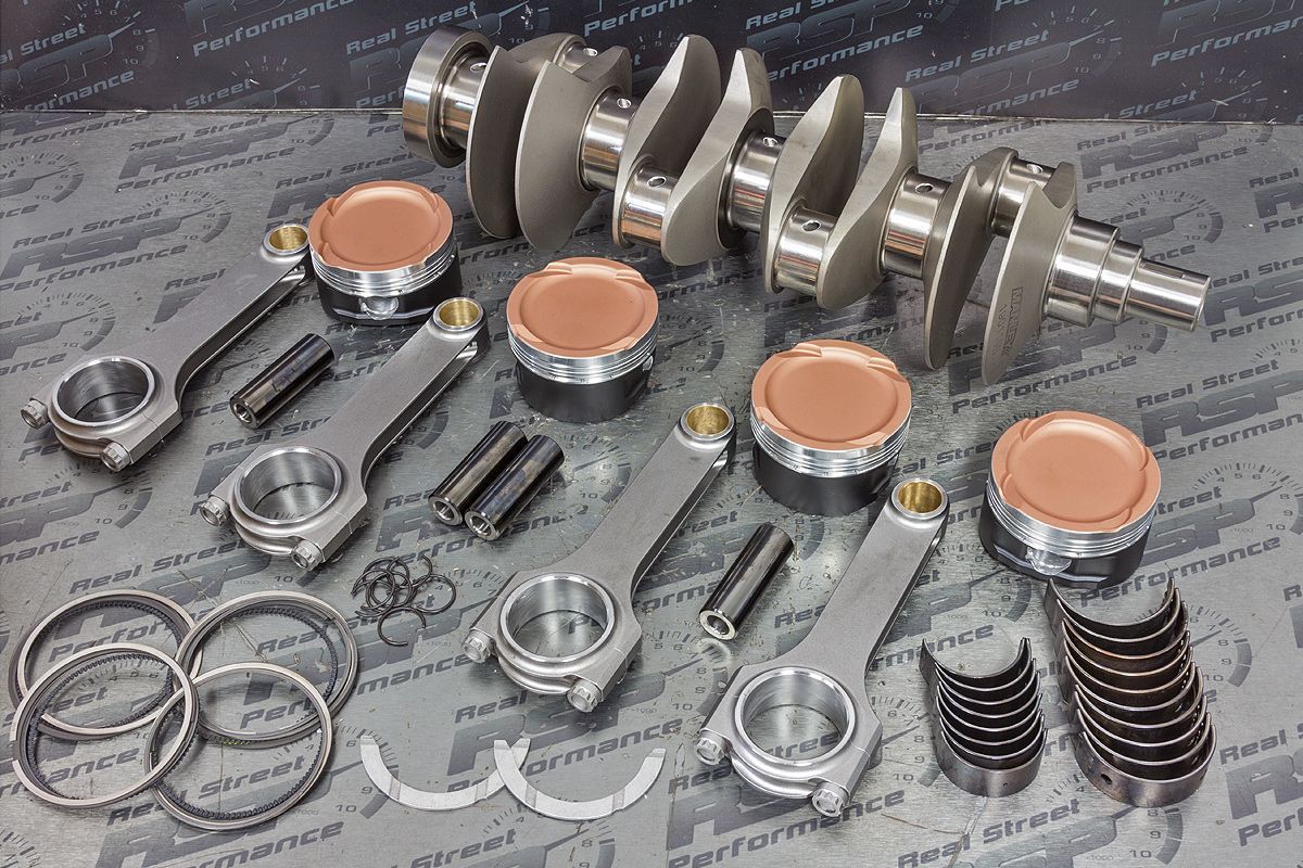

Thank you. Its a high compression engine with a small turbo. Its run on Ethanol 99% of the time. I don't run it hard on pump gas but would expect 450-500whp or so. Here are the specs.
New Evo 9 Block STD bore
Manley Billet 94MM Crank
RSP Spec 153MM Carrillo Rods
RSP Spec Custom 10:1 CP Pistons with all the options
ACL Bearings
OEM Gaskets
Head Games "Pocket ported" Mivec Cylinder head
GSC Billet S2 Camshafts
Full GSC Valvetrain
HLA
Built by Jay Meagher of Real Street Performance

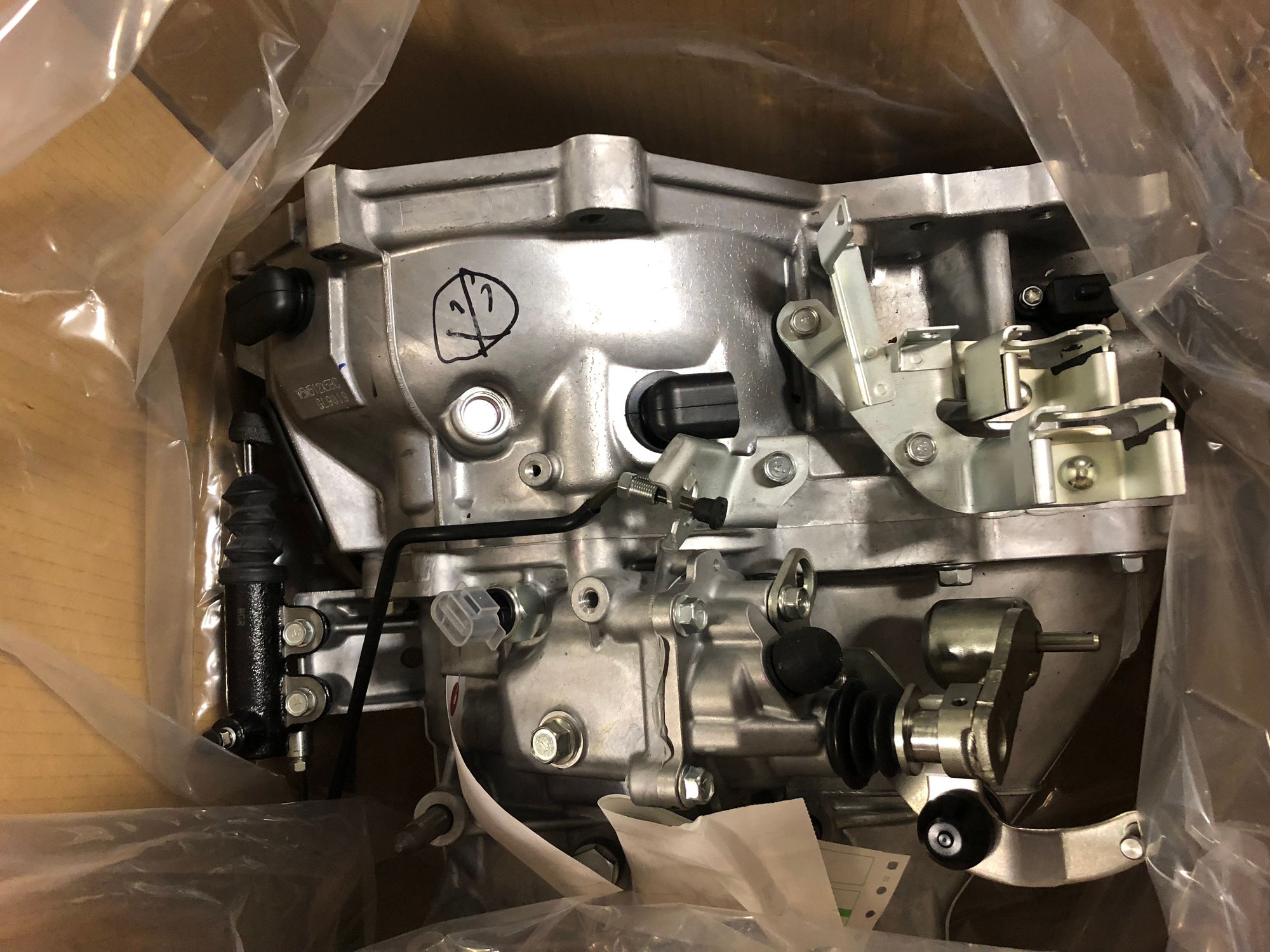

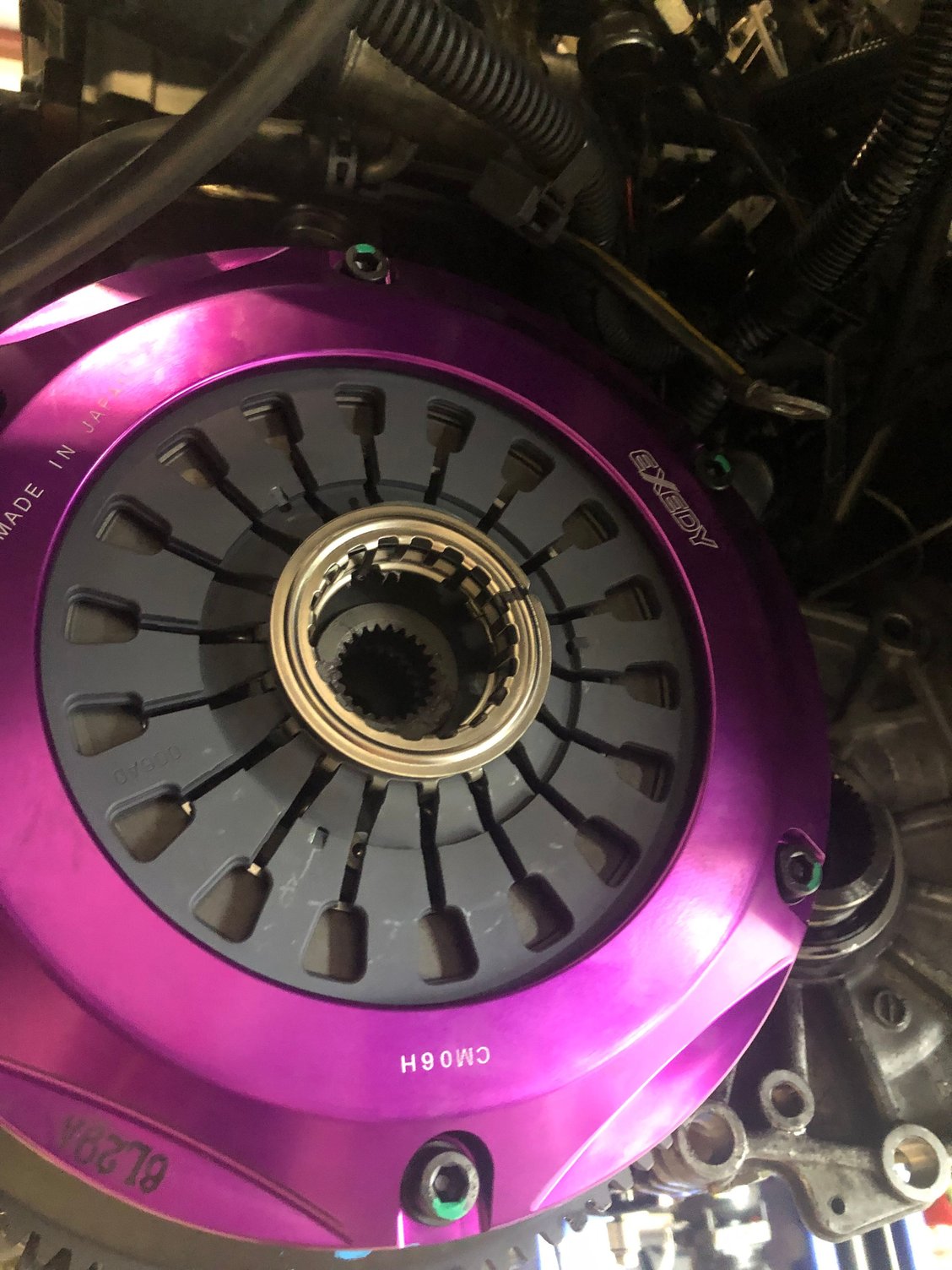

November update. Car has been running well but the 6 puck is getting tired. Between the 4.11 Final drive, 20K miles of abuse on the pressure plate its not happy about it. I had some slip in 4th the other day.
With this platform being over a decade old I'm growing a bit concerned with parts availability . I may have talked myself into pulling the trigger on a new trans just so I have a backup. I see myself owning this car for a long time.
I ordered a new evo 8 transmission and a mfactory 4.31 Final drive. I'm going to shorten the gear slightly and go to a taller tire. The small change should also put me closer to the limiter in the 1/4 mile. I'm not into drag racing much but I like to optimize my streetcar combination. I'm going to move from a slippery 300TW tire to a RE71 as well.
Trans shipped to TRE yesterday and is getting some detailing.

I’m going to imagine that’s the Japanese smiley face for ok on the trans.

Like your style there, Tim
New trans already shipped to TRE for final modifications
Dont think thats a smiley face LOL. Could be a Q.C check of some sort?

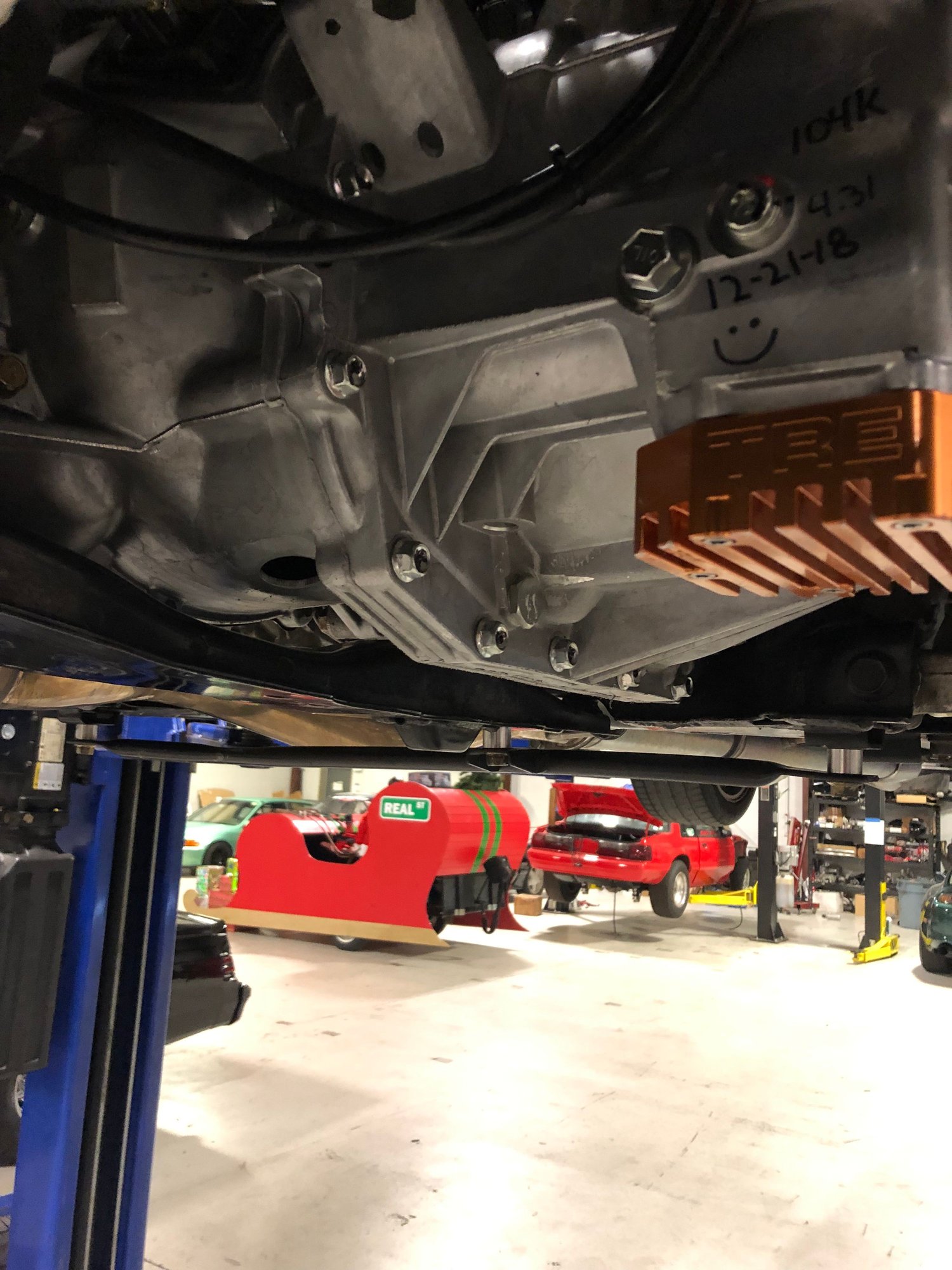

Trans came back from TRE a few weeks ago. Just have to fill fluids up.
104XXX miles on the chassis.

Went out and put a few miles on the new setup. Gearing and clutch seem spot on.

Mmmmmm that TRE trans!!!!!!!

Transmission shifts well and has about 250 easy miles on it. Exedy twin HD has a stiffer pedal but modulation and feel are nice .
