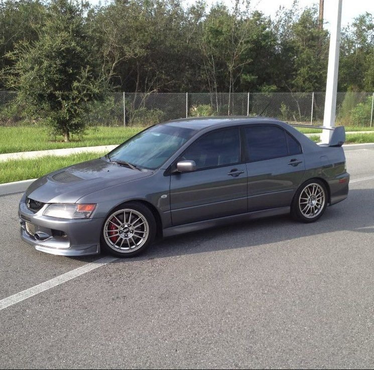

Sidenote ,Five years ago yesterday I bought this stock Evo. This is actually the first picture I took of it with my trusty iphone 4.. It was nice to start with a fresh canvas and paint the picture I wanted . Each and every modification it picked up power or handling . Alot has changed over five years but this platform continues to deliver an amazing Fun per dollar ratio. From 250whp to 650whp its been reliable and rewarding to drive on the street, road course,1/2 mile and drag strip. Thank you to Jay, Geovannie, Mark and everyone at Real Street Performance that had a hand in this build 101165 miles

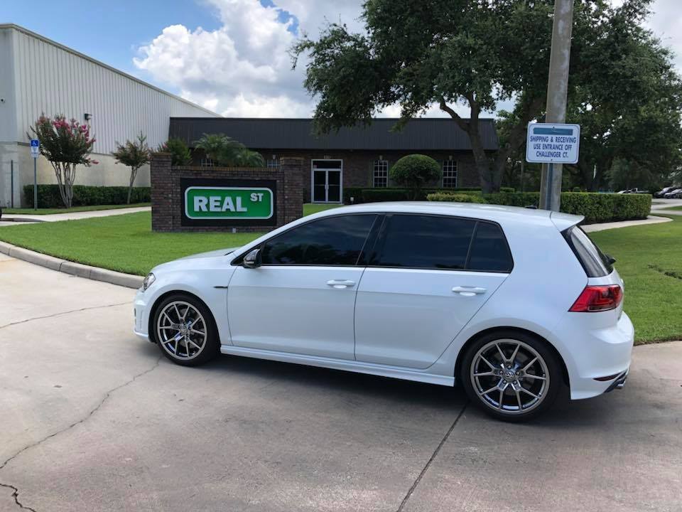

A few small changes for the Evo taking place. I was offered some money for my DD Acura and took it. As much as I wanted to step into a something else german I decided to be conservative for now. Picked up a 22K mile Golf R with a few mods from a buddy of mine. He clipped off an 11.9@112 earlier this year with heavier wheels/tires.
The sound and bluetooth systems are phenomenal. Ride quality is ok and may need to be addressed. Power and the DSG are dialed in pretty well for a street car.
