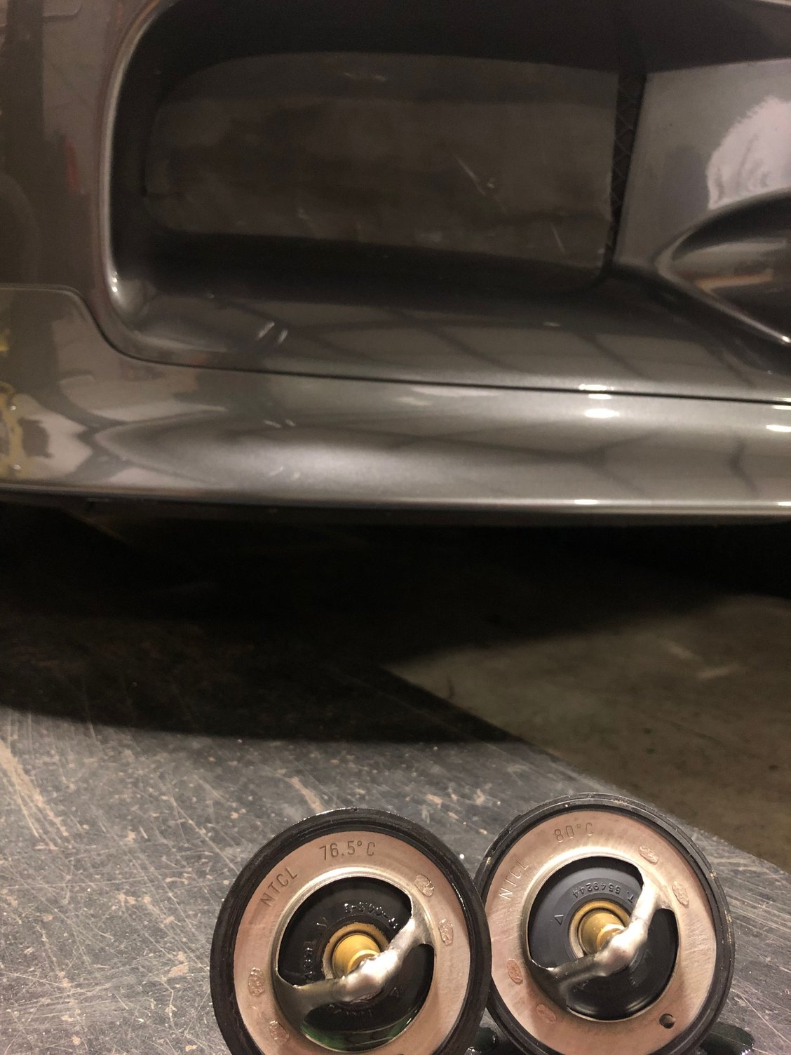

Ralliart t stat vs stock.
Getting the car ready for winter time. Changed the thermostat from a 76C to 80C.
The Evo has one of the best cooling systems ever made and with the lower temperature thermostat will run at 168-175F at night doing runs. Good thing for keeping temps under control but bad thing for having ample heat !
Going back to the stock thermostat will yield 185-192F . I’ve also got a racefab oil pan that holds ALOT of oil so the oil cooler gets partially blocked off as well. Oil temps follow water temps for the most part so it’s not an issue on this car unless it’s at the road course. These two changes get the oil up to temp twice as fast on the commute to work. Or Mexico.

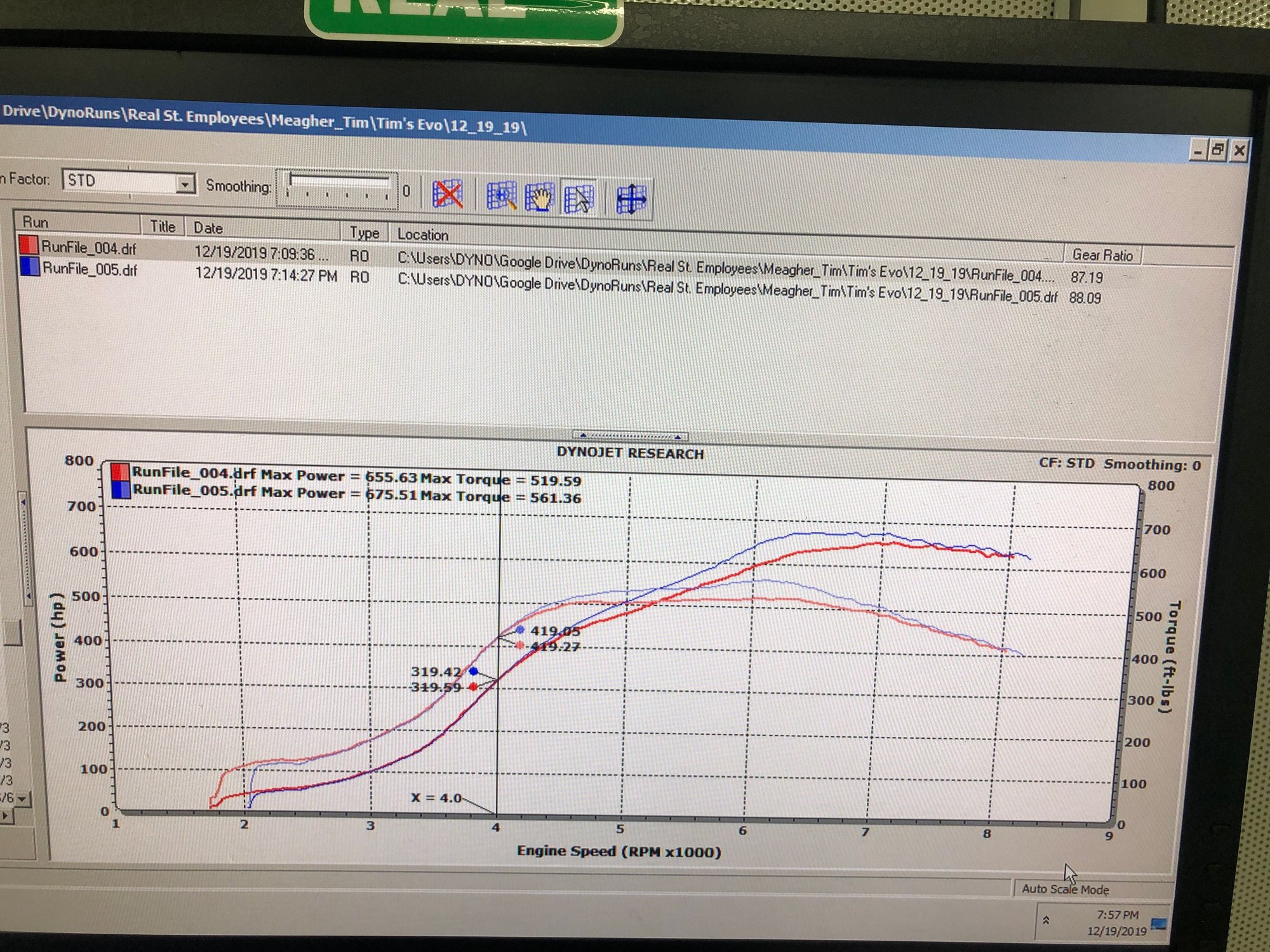

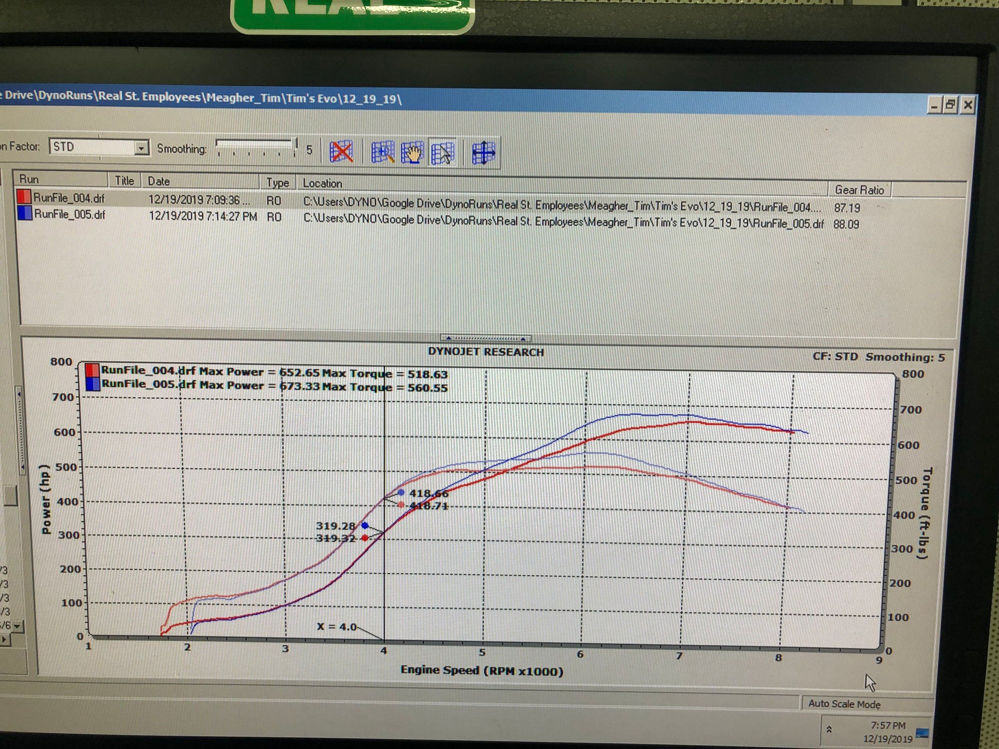

So, when I bought the htz red to upgrade from the hta red years back I opted for the ss housing. I knew it would change the near instant spool up and make a bit more out the top with less back pressure. It still has a purpose and makes power easier once its spooled up.
Most fuel stations have winter blend ethanol that comes in at 72-74 content. I knew we were going to run the car hard so I splashed in five gallons of One Ethanol R fuel. Content went from 74 to 87. Injector duty was near max. Made four runs over 600 before pinning the gate .
675/561 at 43 down to 33psi
655/519 at 35 psi tapering to 32.43
.80 lambda /11.76 AFR ID1700's at 94% at 8100. Walbro 274/450 pump @16 volts. Fuel pressure was solid.
Boost for 655 ss run
3000 5.62
3500 12.72
4000 25.54
4500 35.39
5000 33.31
5500 35.06
6000 35.26
6500 34.8
7000 33.96
7500 33.43
8145 32.5
675 run
3000 5.37
3500 12.36
4000 24.88
4500 37.62
5000 42.1
5500 43.08
6000 42.16
6500 39.22
7000 36.32
7500 34.66
8173 33.24
The transient response isn’t near as good as before and it’s 600rpm late to the party to 20psi now in the low gears.I will be going back to the mhi housing and most likely the 4.11 transmission for what I do with the car.
Smoothing 0 and 5 show nearly the same power and how clean the car is running.

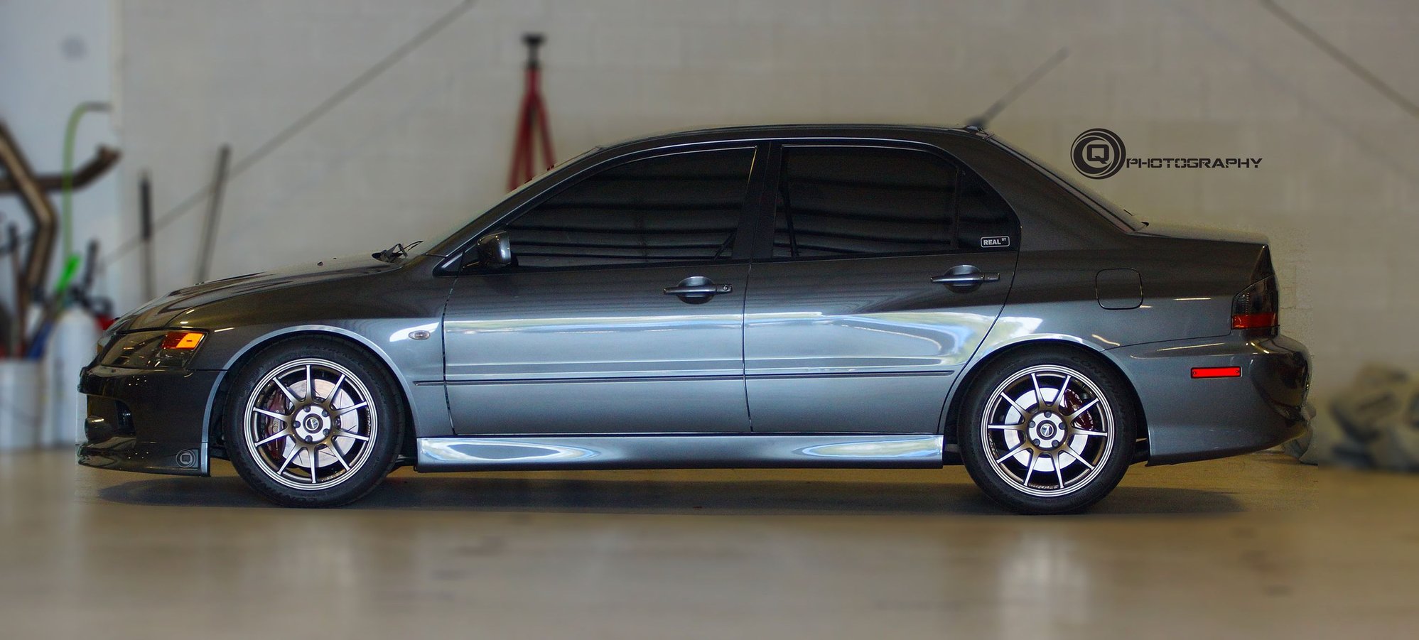

Car has been running well. Just had a 2JZ dyno day and Miguel from Q photography snapped this.
I need to refresh the brembo's one of these days.
