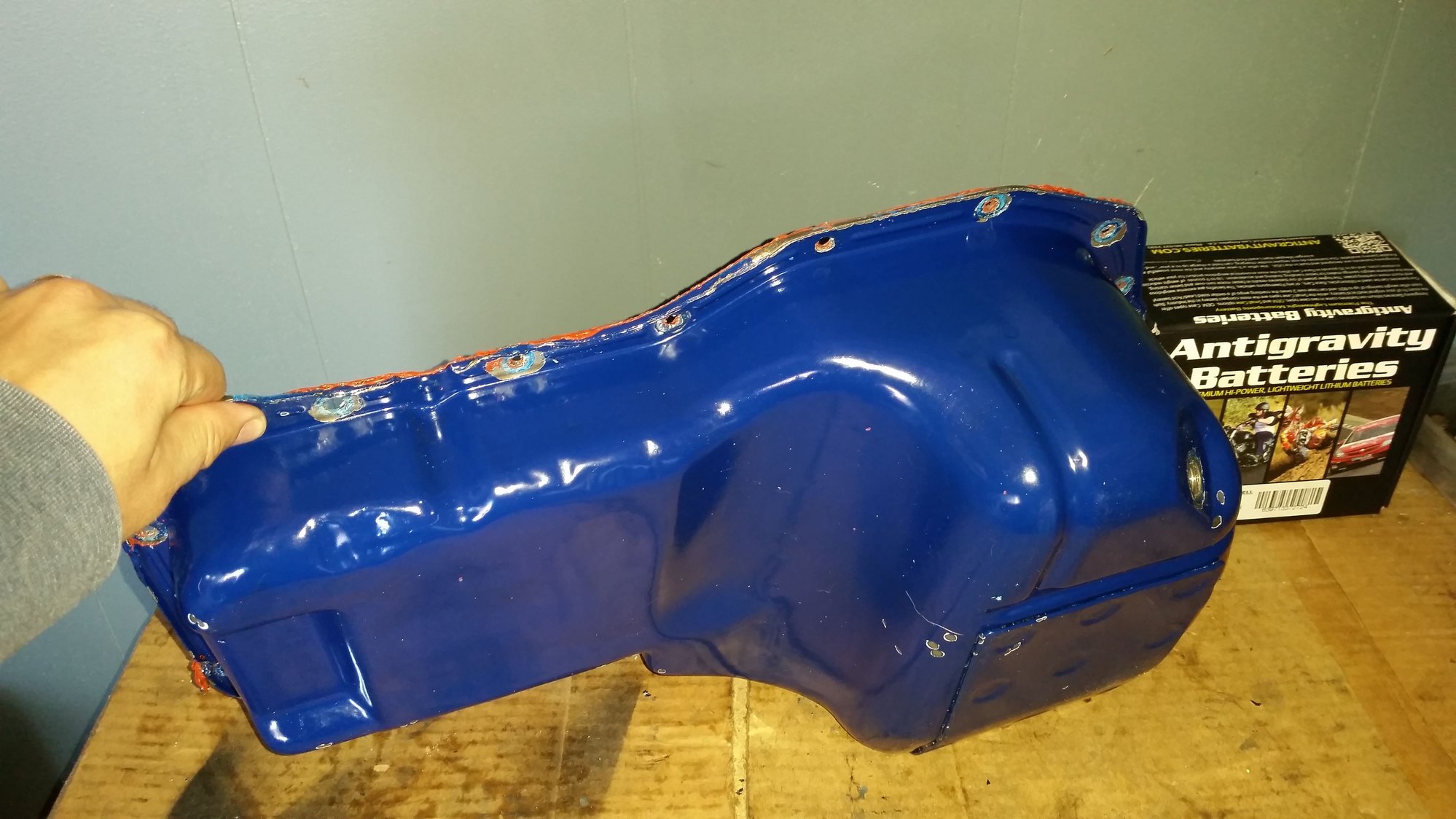

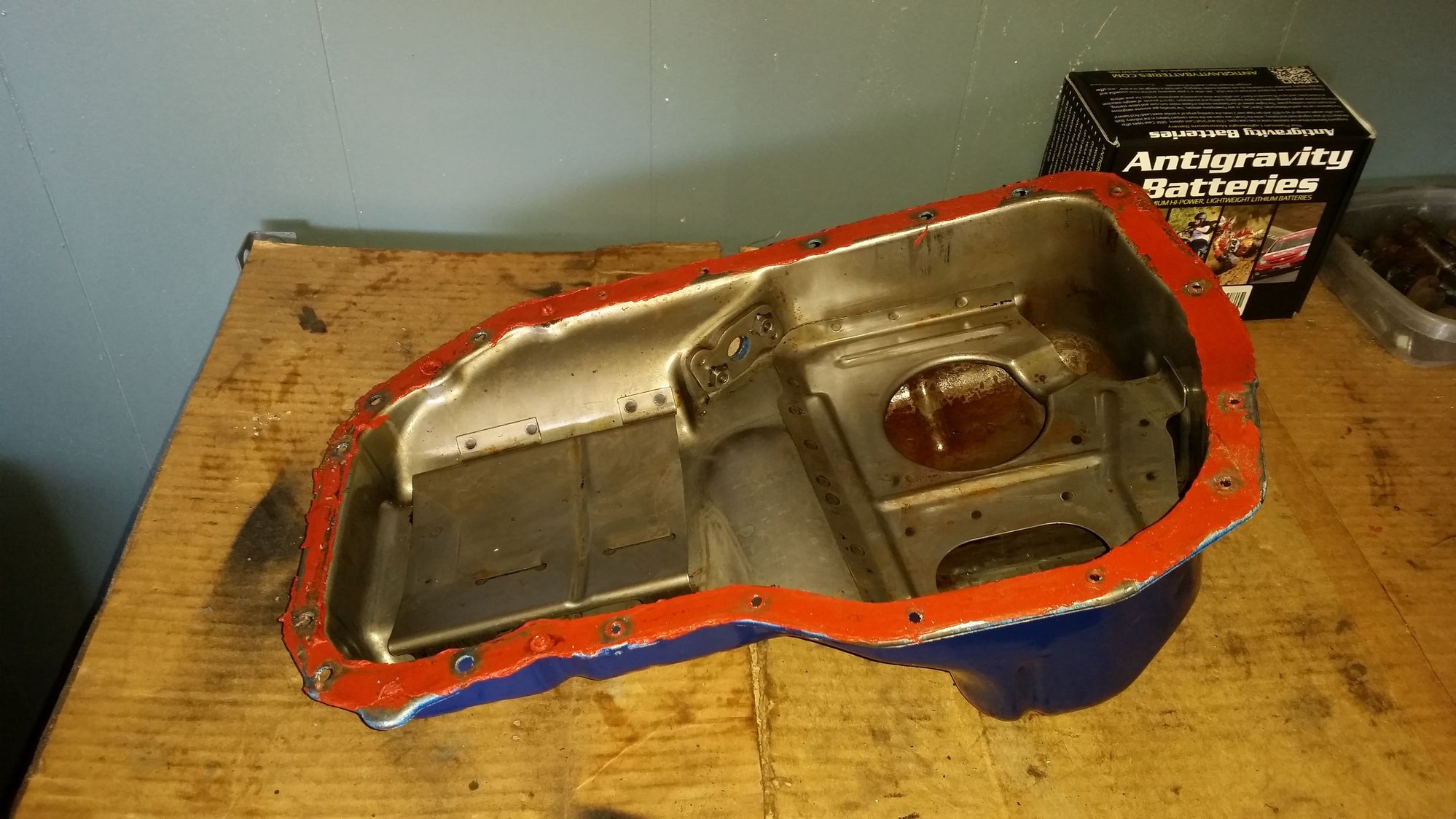

I also got a used oil pan for 75bucks to my door. The fool who I bought it from painted it blue for god knows why... I'll probably remove mine with the pickup and send those to RaceFab. Use this one in the interim just to keep dust and crap from blowing up into the engine while its immobile/vulnerable.

Where were you when I had my 5spd stuff? I had literally everything for a swap. Sold it pretty cheap. I'm assuming you have a 6spd now? Are you planning on a high HP build?
As for the oil pan, maybe the guy was a Ford fan? LOL
You will be happy with a modded pan. We did mine and the sucker holds over 6qts! Also I'm not seeing any oil pressure drops with the trap doors (under some surprisingly harsh AutoX conditions). Definitely worth all the trouble.
