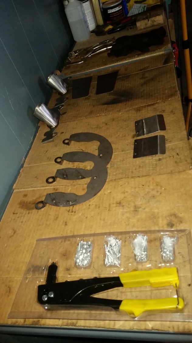

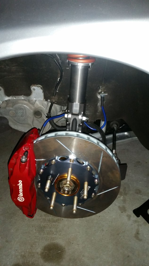

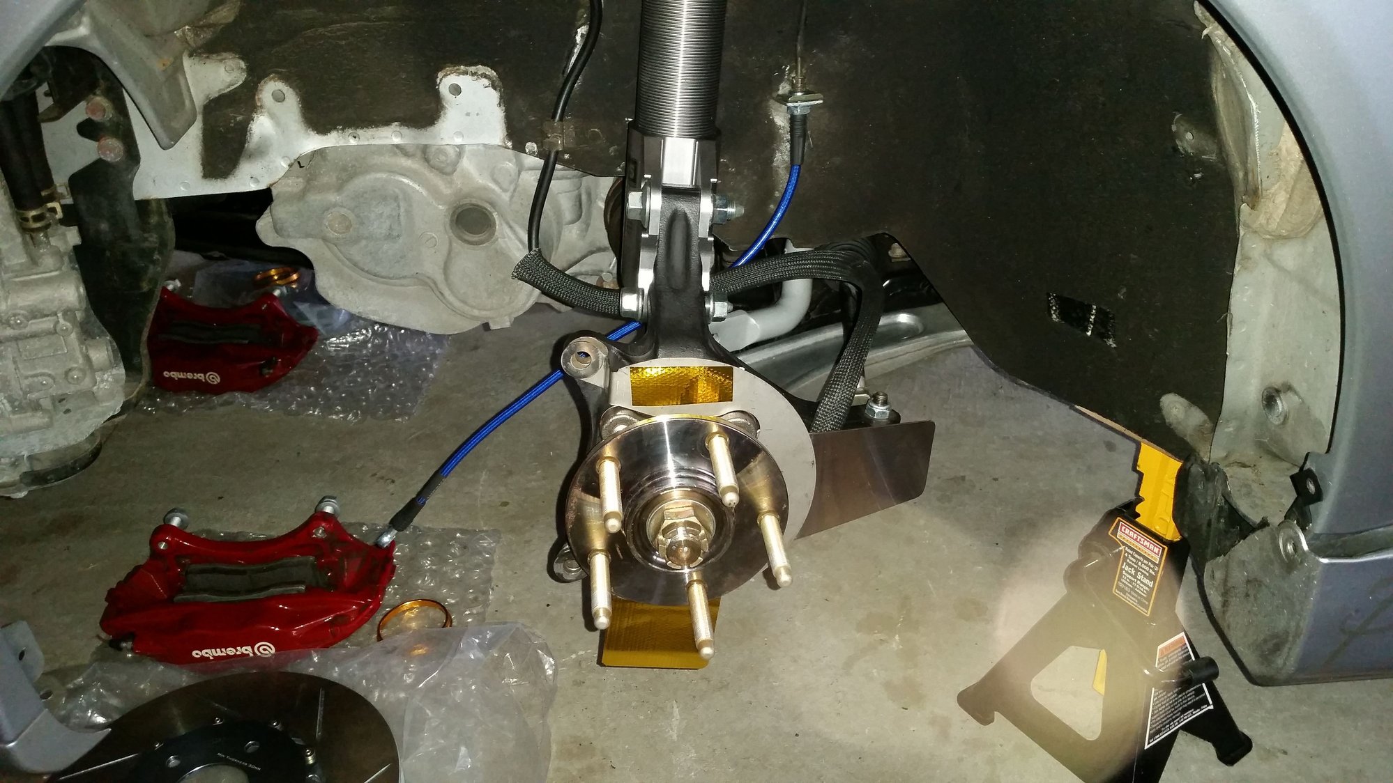

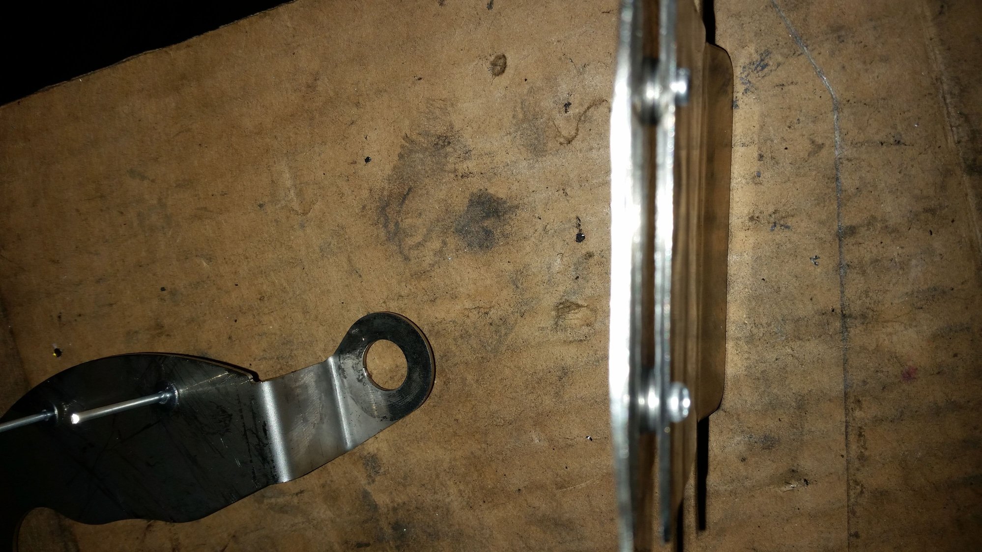

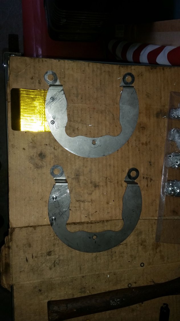

Made some changes. I didnt like how loose the balljoint sheild was in EGbeaters design. I felt like it'd make a lot of noise. Used Hondaguys solution--HERE since he too has AMS ducts. I bent and cut them. Then drilled and riveted to the AMS sheilds. Put 2 small washers between them to move it away from the rotor. They are rigid and far enough from the rotor. I accidentally did the passenger side upside-down so i corrected it and put gold tape over the holes lol.

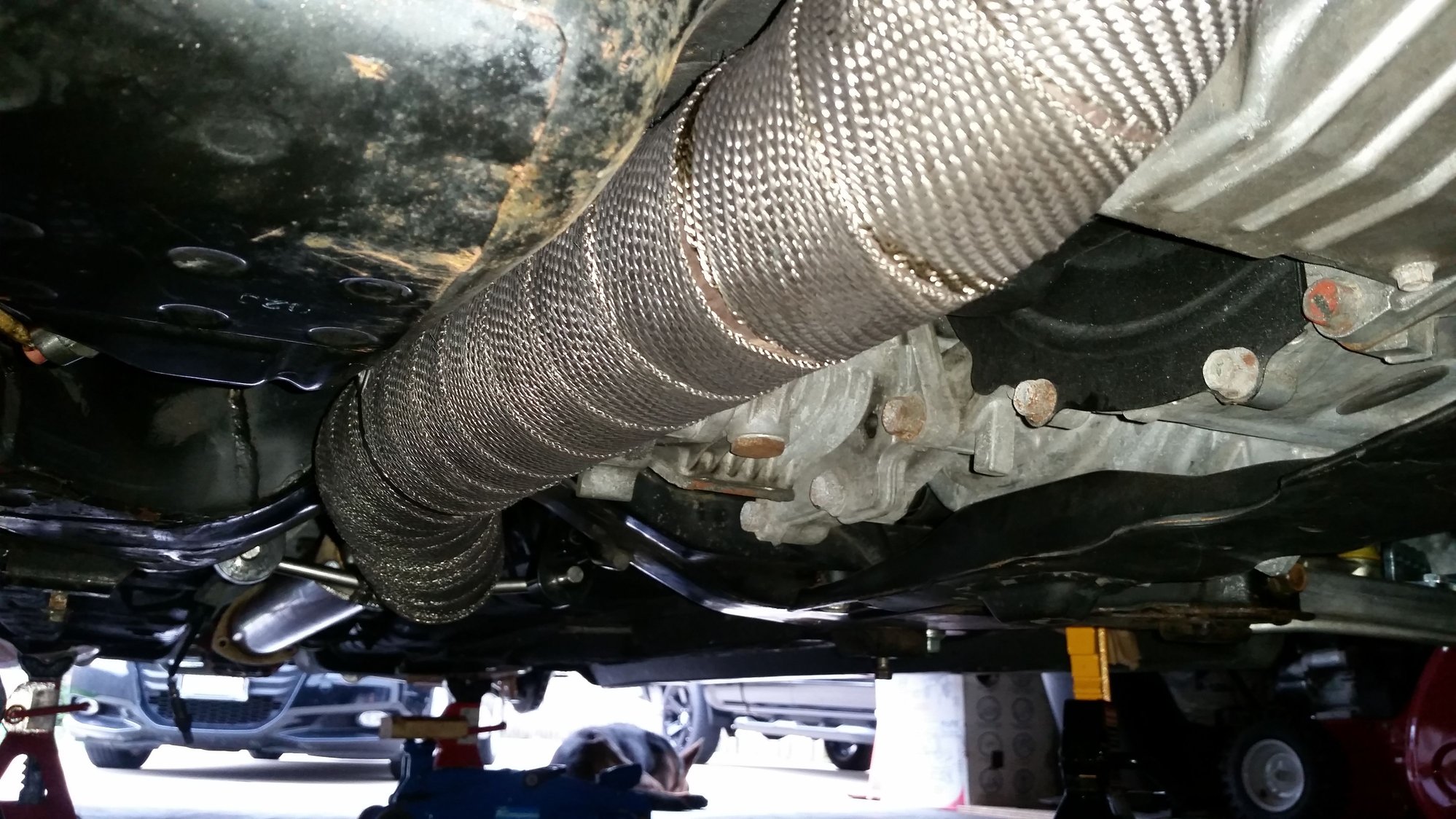

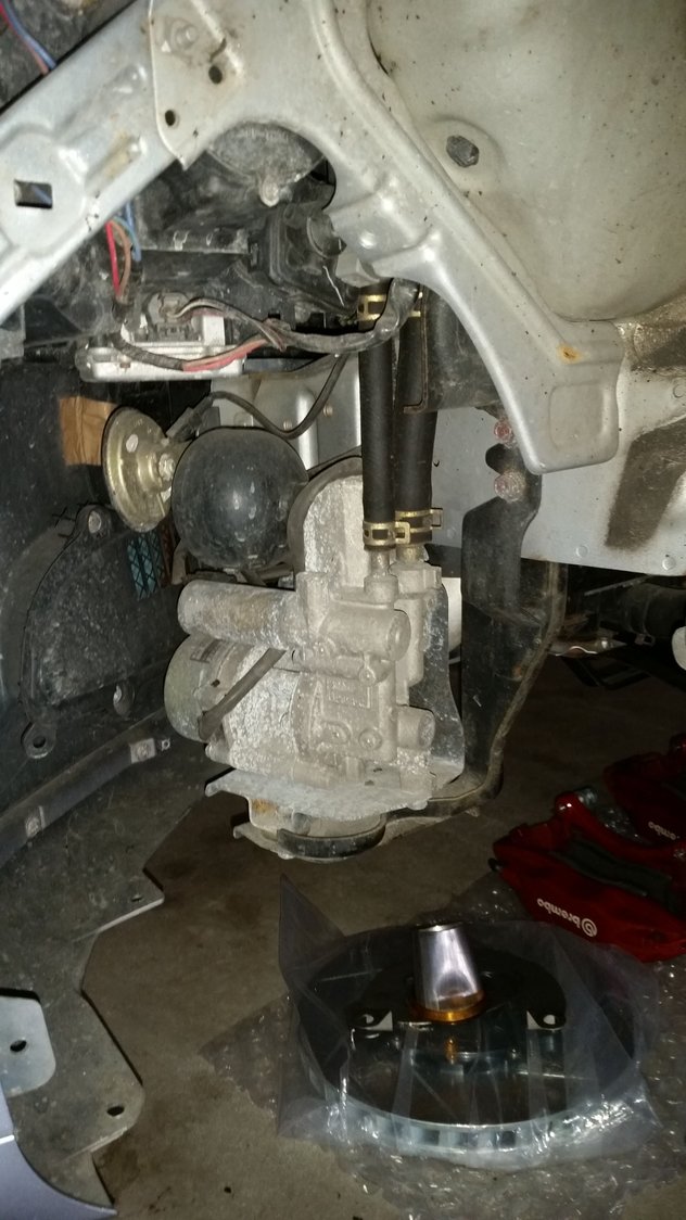

Also got most of the exhaust back on. Realigned steering column since the steering wheel was crooked relative to the wheels after pulling front cross member. Tightened various bolts to spec. Leaving most suspension bolts loose until I put the car on the ground so they are torqued in their loaded position.

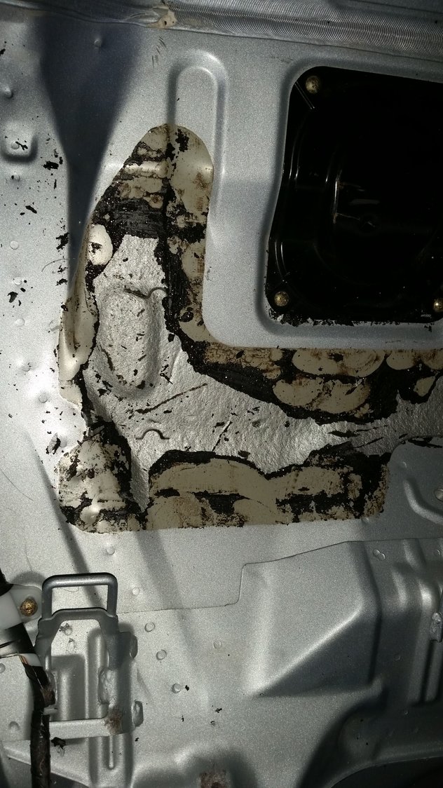

I wana remove sound deadening but the way I started it too hard. Going to get some dry ice.
Riveted to AMS sheild.
2 small washers to offset the balljoint sheild.
Assembly
Need to get some dry ice. This is too tedious...
Needs to get moved to the rear
Putting exhaust back on.

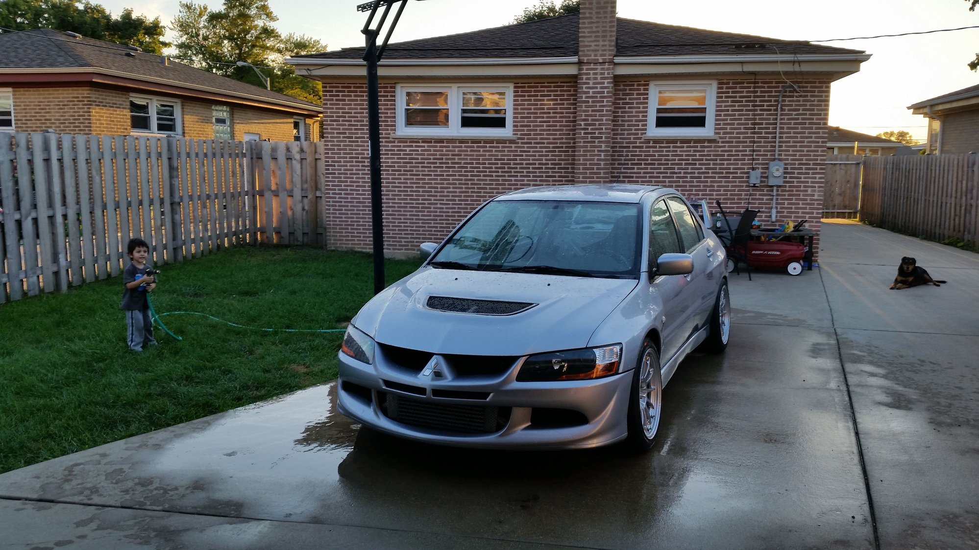

Well, I managed to get it down and moving on its own power. First time in almost a year. Gave it a quick wash and swept under where it was hibernating. No brakes, still need to bleed em. And seat not bolted down. But this is a huge milestone for me.
