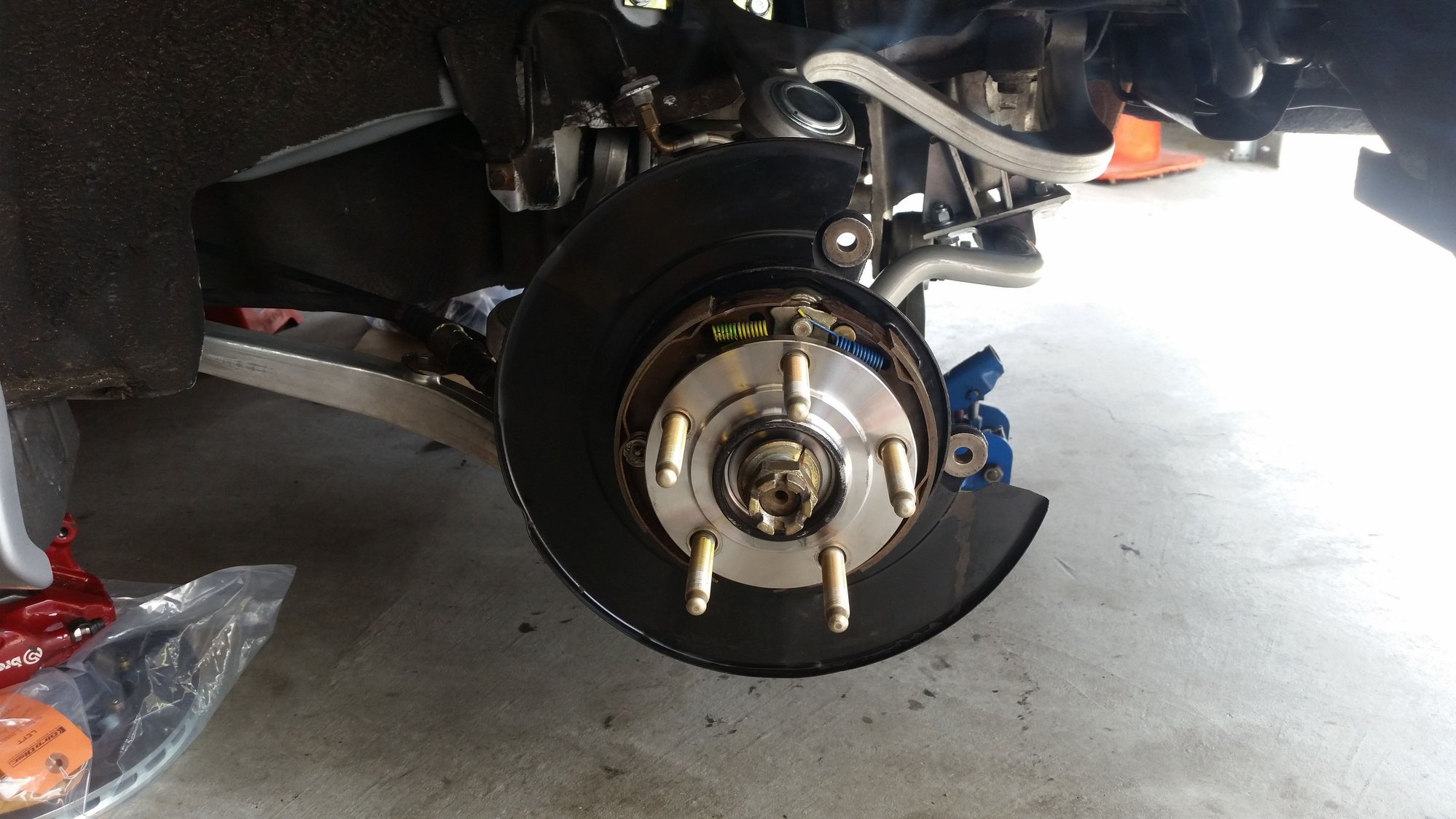

I would remove the OEM dust shields and just make heat shields for the lower ball joint and tierod end. Those full coverage dust shields keep a lot of heat in the rotor.
I'm on the fence. I'm hoping the rotors centrifugal design plus ducts will be sufficient. I'll probably run as is and if there are any signs of trouble pull them out. Will consider rotor heat paint or a temp gun when I get out to a HPDE.
The other thing I've only recently thought of is the brakes heating up the inverted tube and fluid of the Ohlins. I'm going to keep the shields until they prove to be an issue.
Doesnt that heat shied also protect the ABS sensor? And IIRC you killed an ABS sensor from heat or was it something else?

The stock dust shield provides a mount for the sensor wire. I forgot to secure the sensor wire with zip ties, So it was probably riding on the rotor...lol.
The dust shields do not keep the shock cool. There is plenty of air going through that area that something 4"+ away isn't seeing a huge effect.

I had the dust shields off on my evo 8. Made a difference in fade for sure.
One bit of insight. I used normal nylon zipties to secure the abs sensor line to the knuckle.
After 10+ track events, some in 100f+ heat, the zipties showed no sign of melting or failure. In fact, they outlasted two six speed transmissions. Lol
I took the shields off on my 10 as well.

Yup. Radiant heat doesn't mean anything when there is a LOT of air flow through an area. I went overkill on ym car and used stainless zip ties that you would use to secure header wrap. Looks like I wasted my money...lol

Well I cant argue with real world findings. I'll remove them and see what I can make to protect the ball-joint and tie-rod at least.

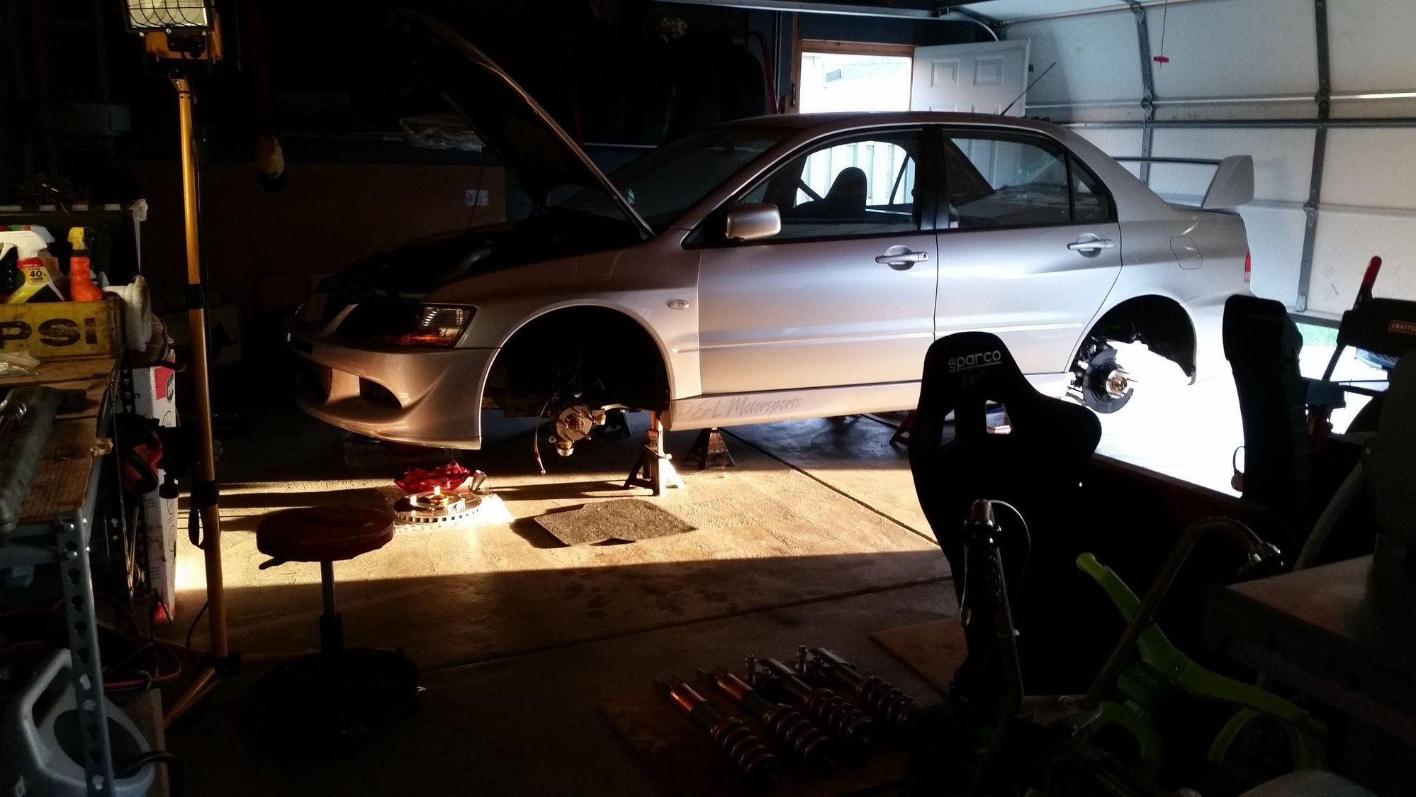

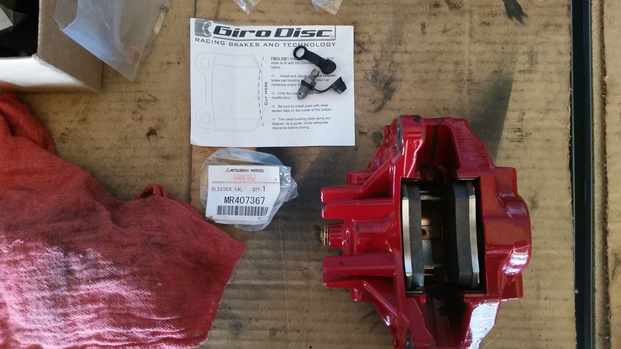

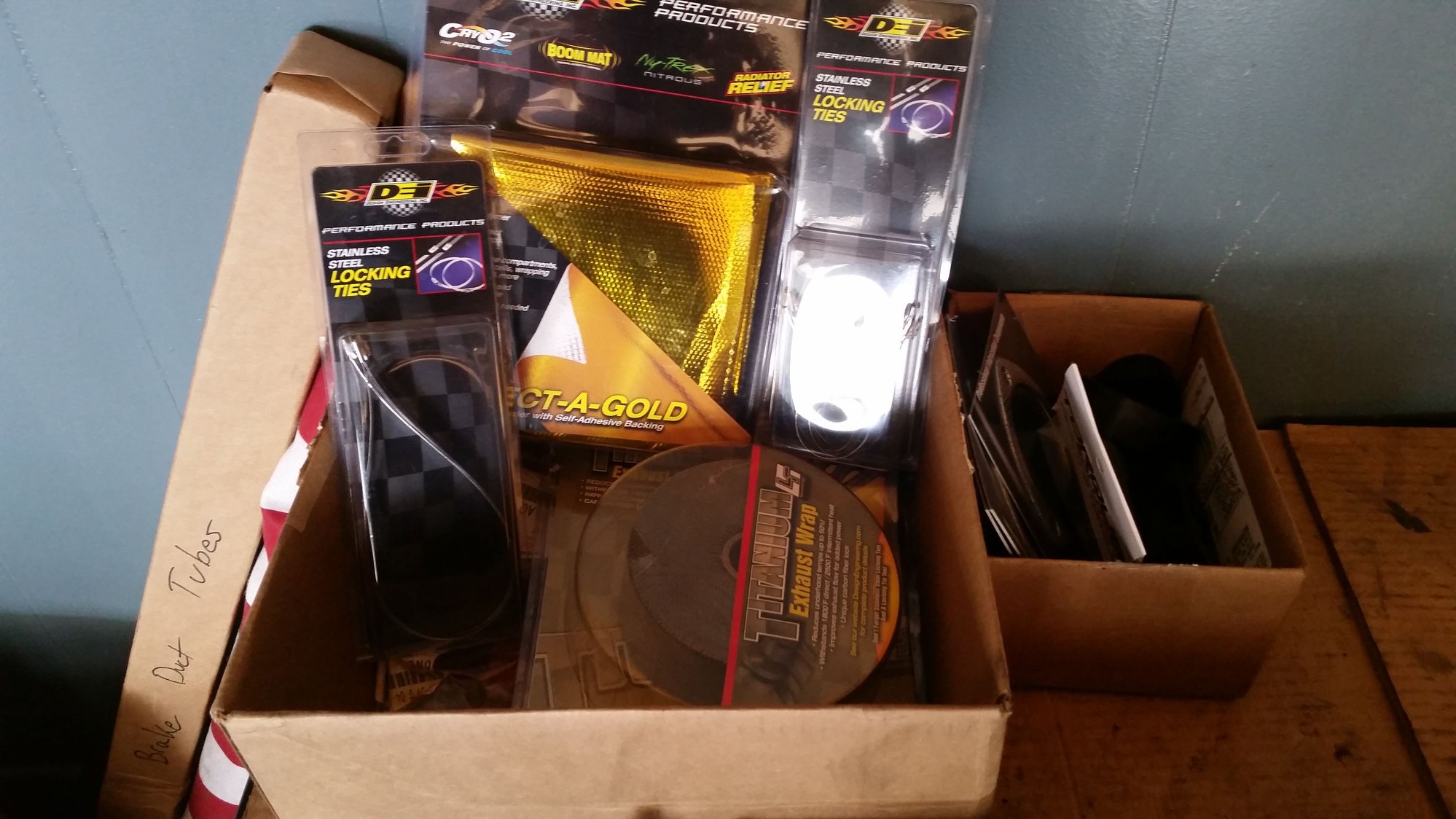

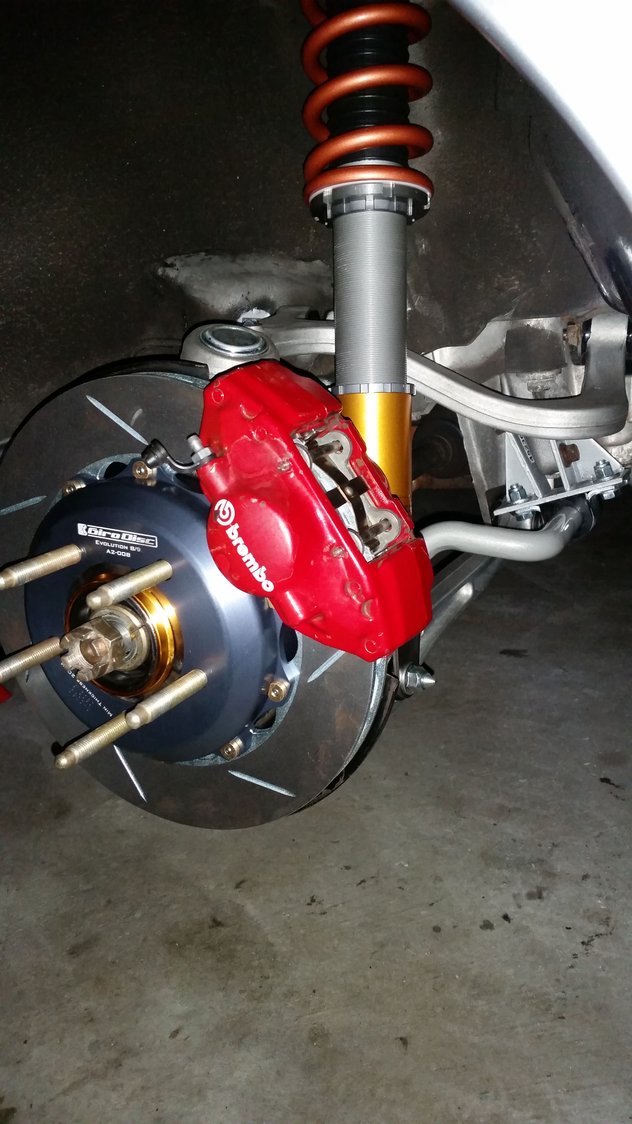

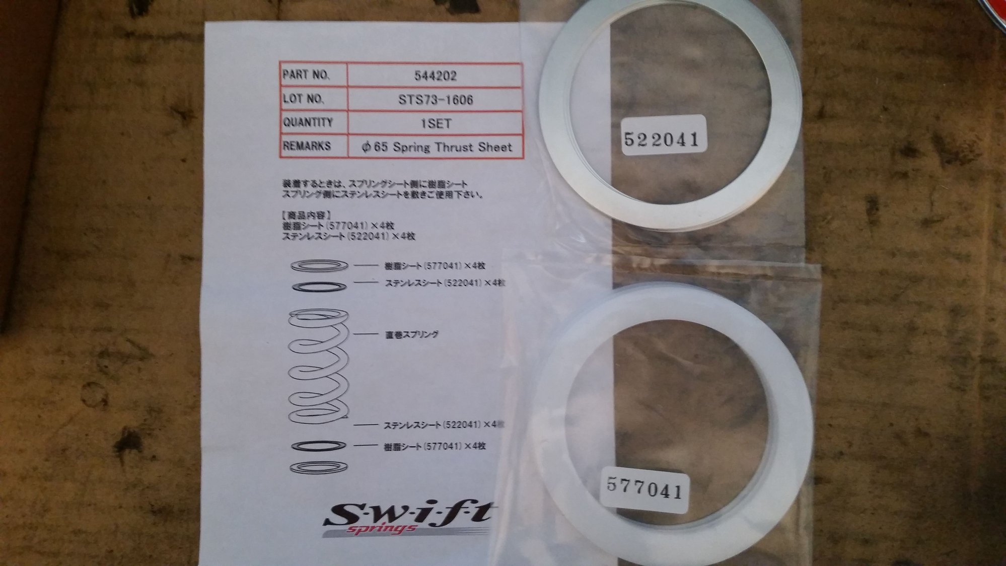

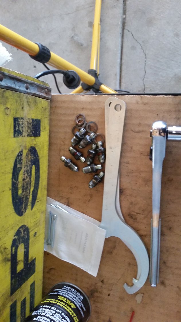

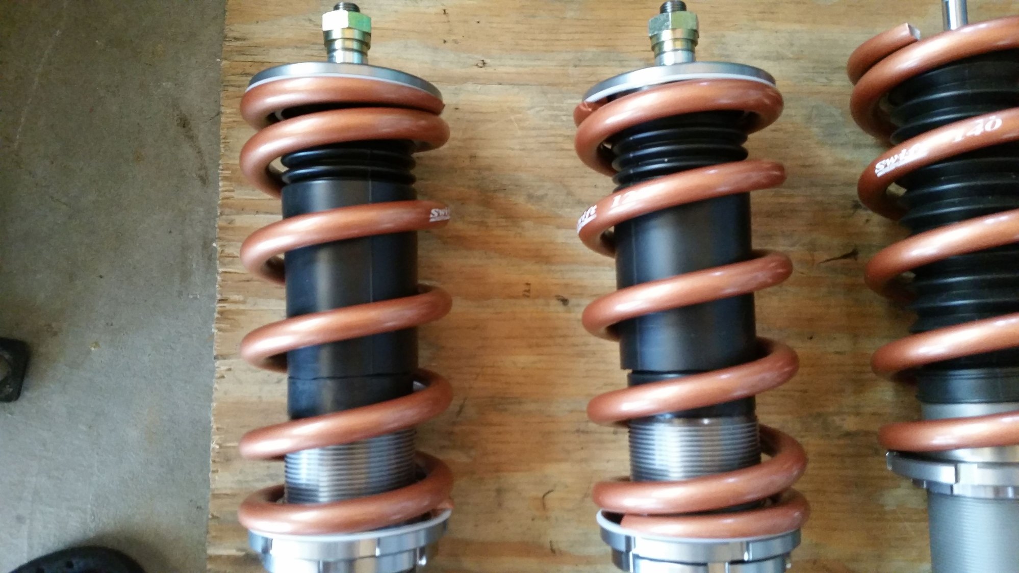

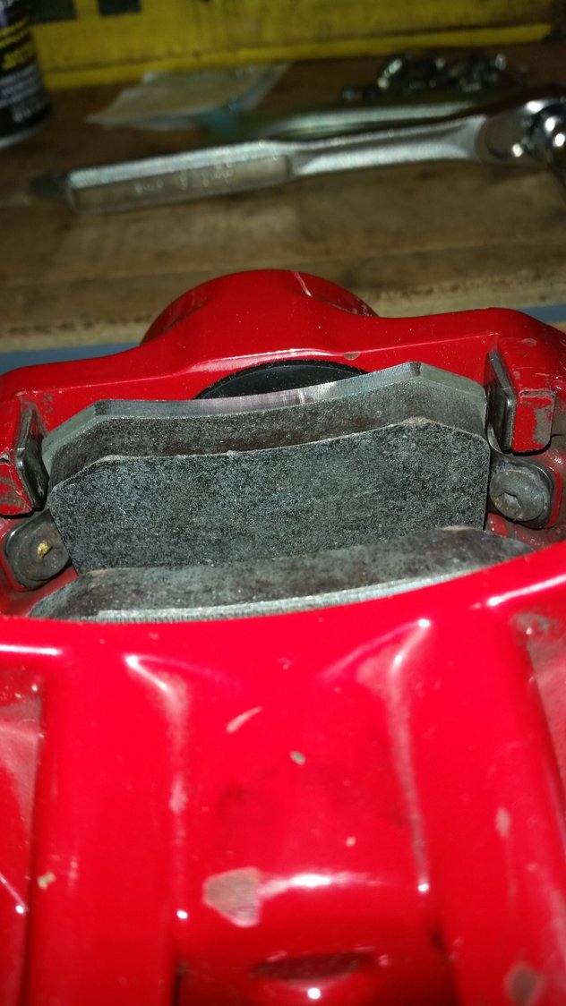

Past couple days just waiting on more parts and doing little stuff. Installed thrust washers. Completed brake rebuild with new OE bleeders and copper O rings for the line. Used old boots as they were in good shape. Also noticed the pads I got from No_Limit/Giro Disk were pre-cut which was a nice surprise. Received more misc like the wrap/ties/coating and some gold tape.
I also got the correct attachment for my dremel. I believe its a tungsten carbide bit which is perfect for porting/cutting metal. Got the ducts cleaned/opened up even larger.

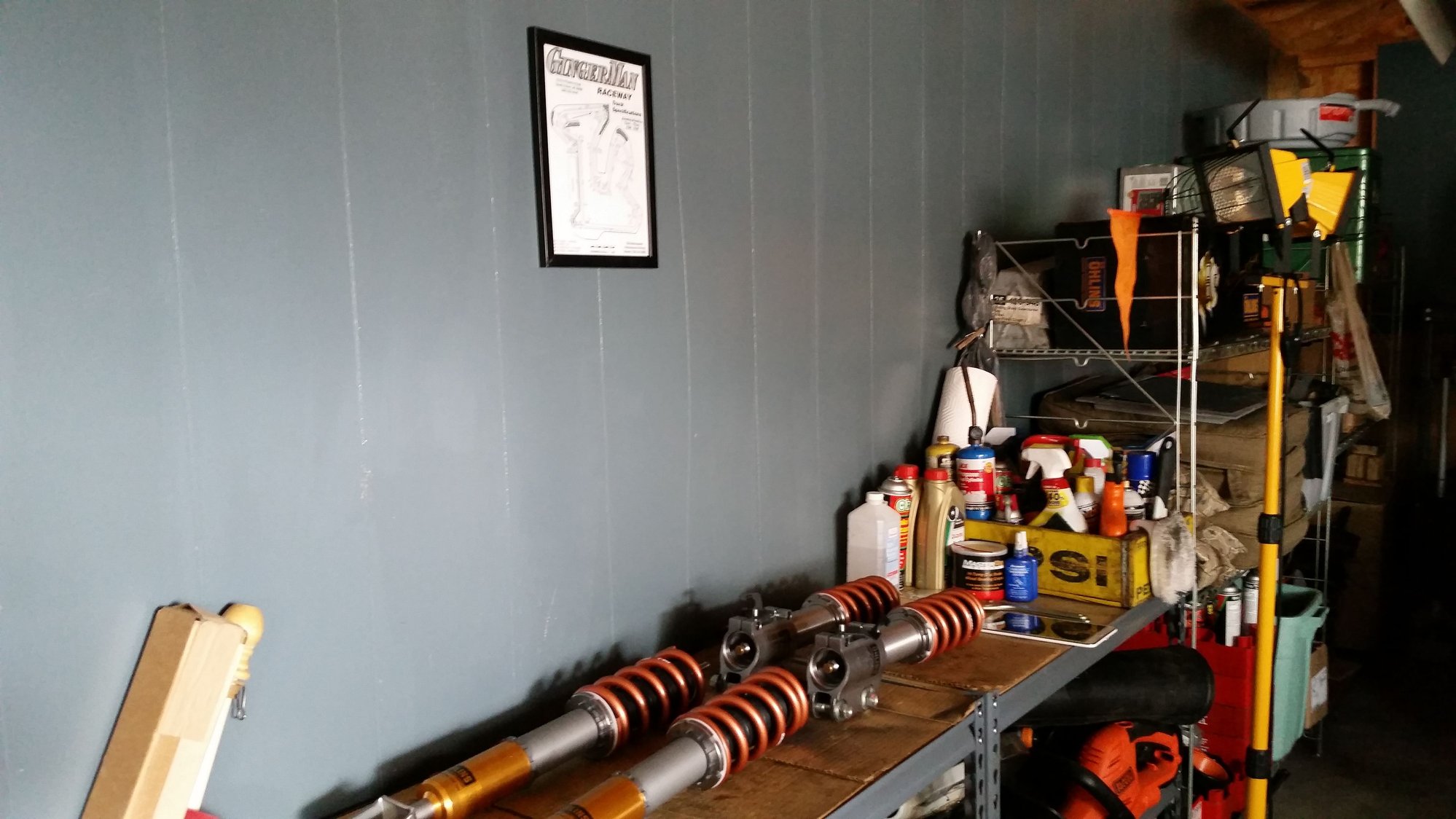

Nice photo of opportunity as the sun was setting and only had garage door cracked open.
Rounding out the brake rebuild.
Pre-cut pads!
Old bleeders and o-rings. Some of them are rounded or damaged from abuse over the years.
DEI/Torque solutions goodies. Using all new gaskets from the turbo back. New spring bolts for down-pipe. Hangers to hold everything in place.
Swift 65mm Thrust washers.

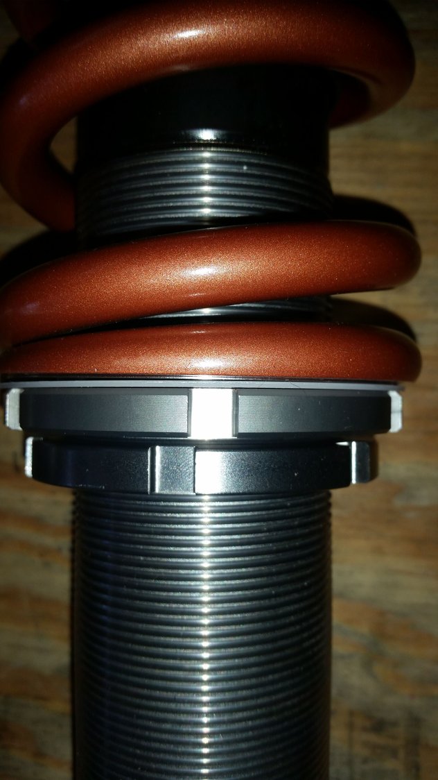

Thrust washers installed on front coil-overs only.

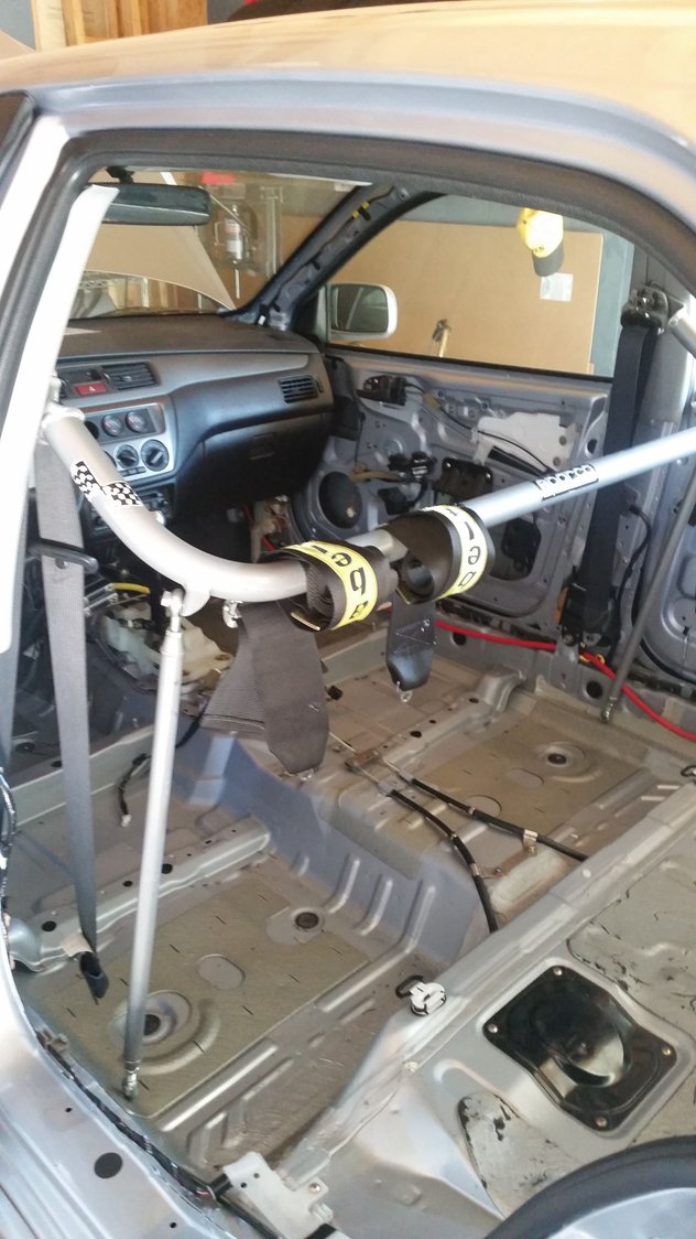

Slow going. Sorry for boring updates but this is as much about documenting for myself as sharing with others haha. I've got a friend who is making the heat shielding based on the pdf in EGbeater's thread in SS for me. Also ordered some 1/2" Insultherm for the front abs sensors.
http://www.racerpartswholesale.com/p...anelInsulation

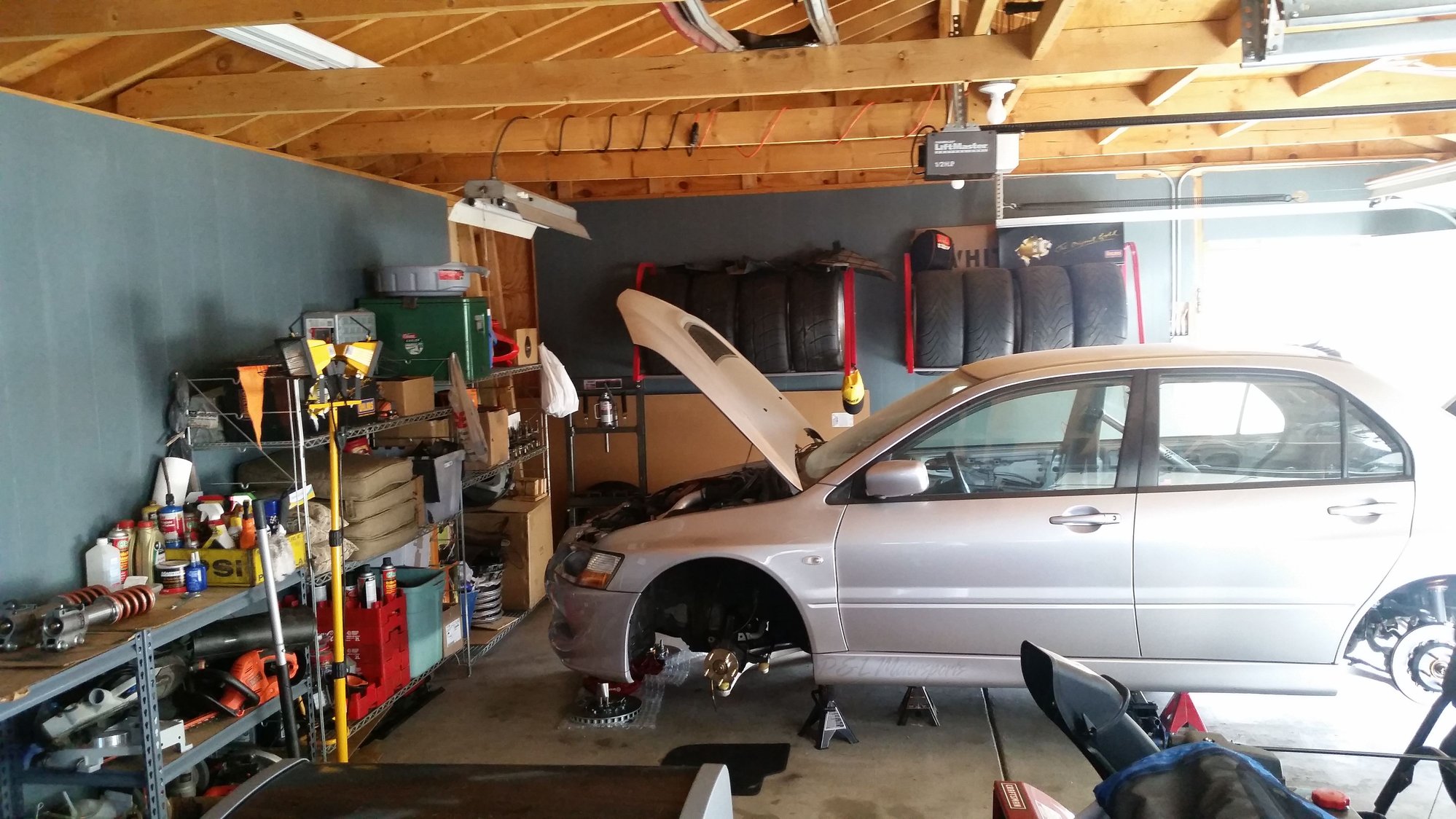

Got e-brakes back on and working. Reinstalled rear coil-overs and rear calipers. I realized only 2 of the 4 rear pads were cut so I had to remove and reinstall with the cut ones on the outside to clear the rotor hat. Received new bolts for calipers and rear struts, front brake line brackets.
Removed the passenger seat to get carpet out as well.

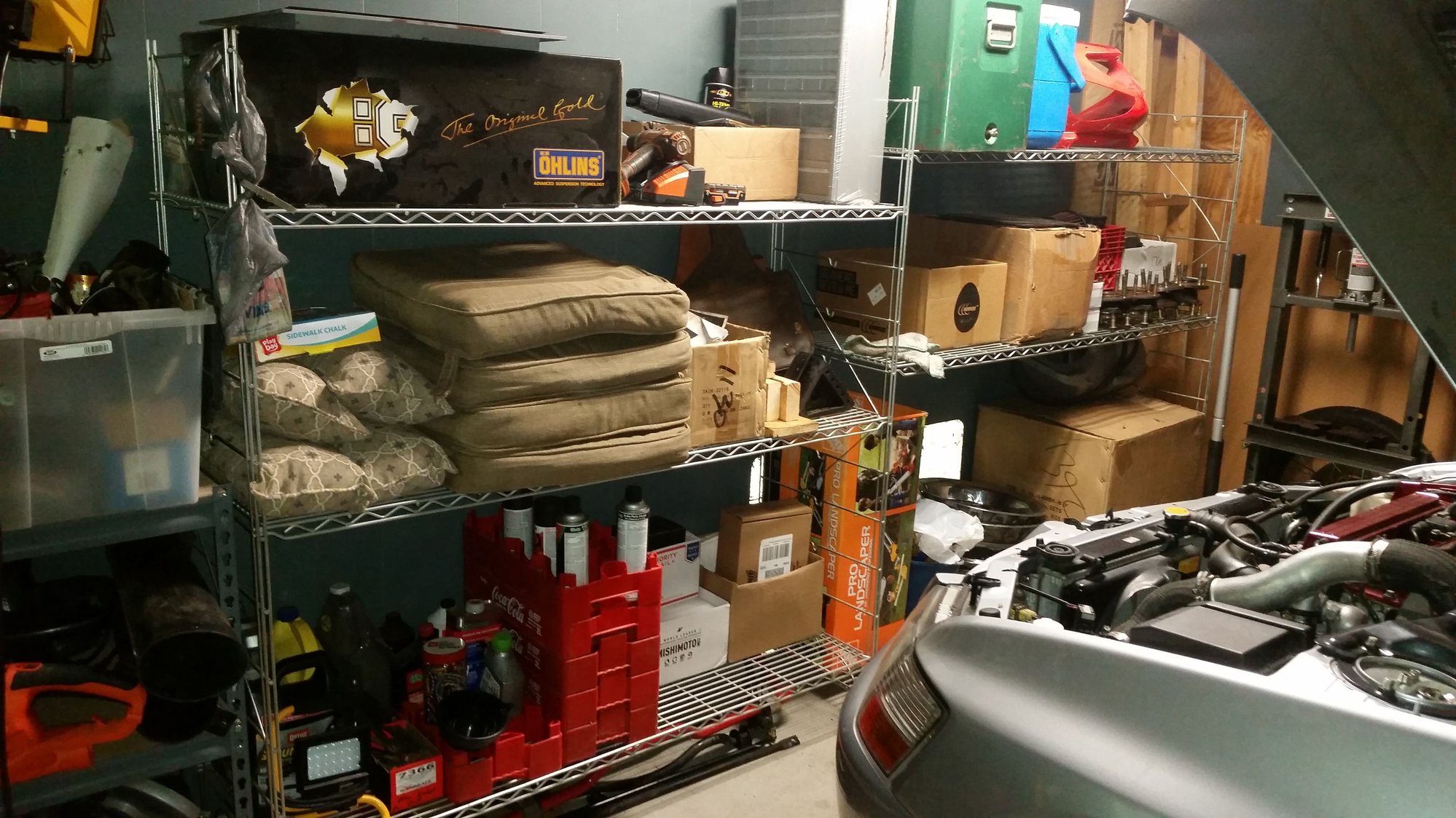

I scored 10' of wire shelving and garage looks much better now too. Still need to insulate the underside of the roof and install some heaters.
