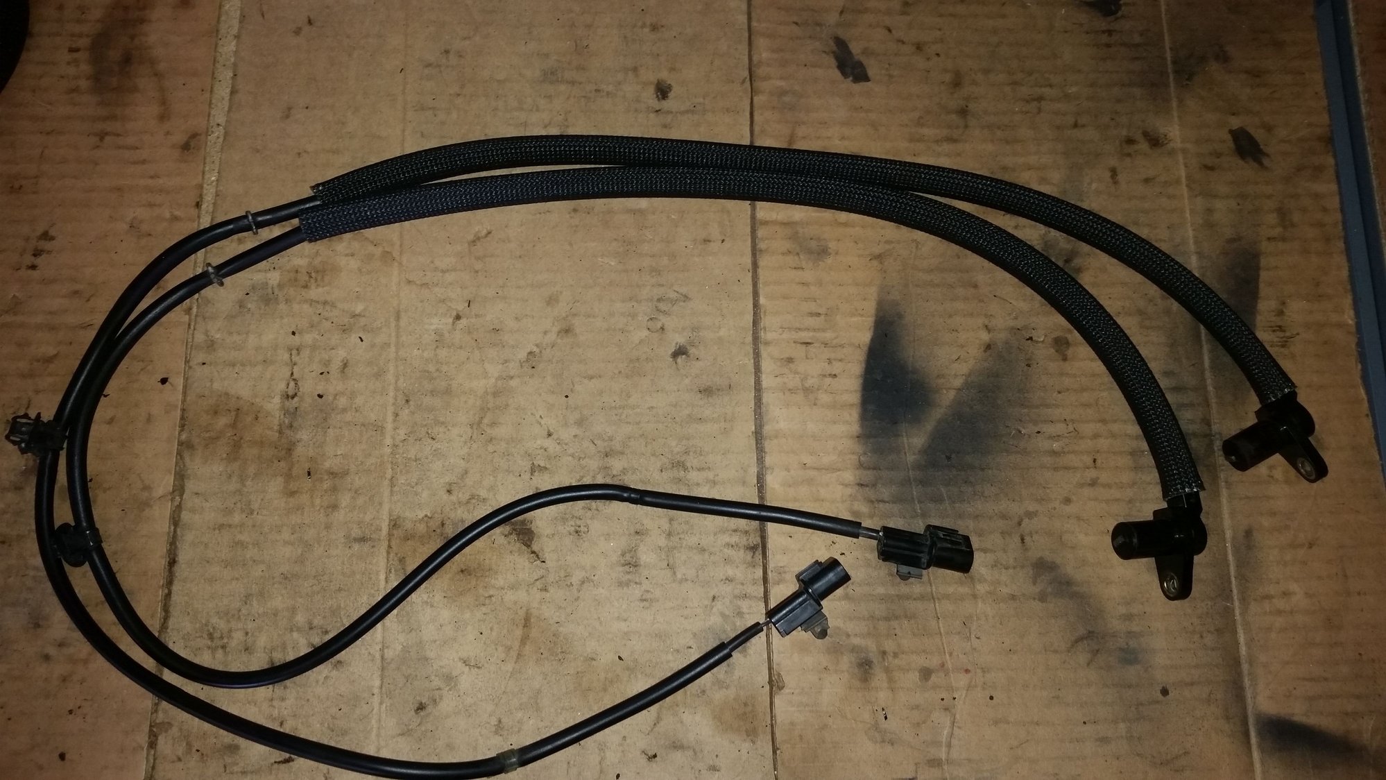

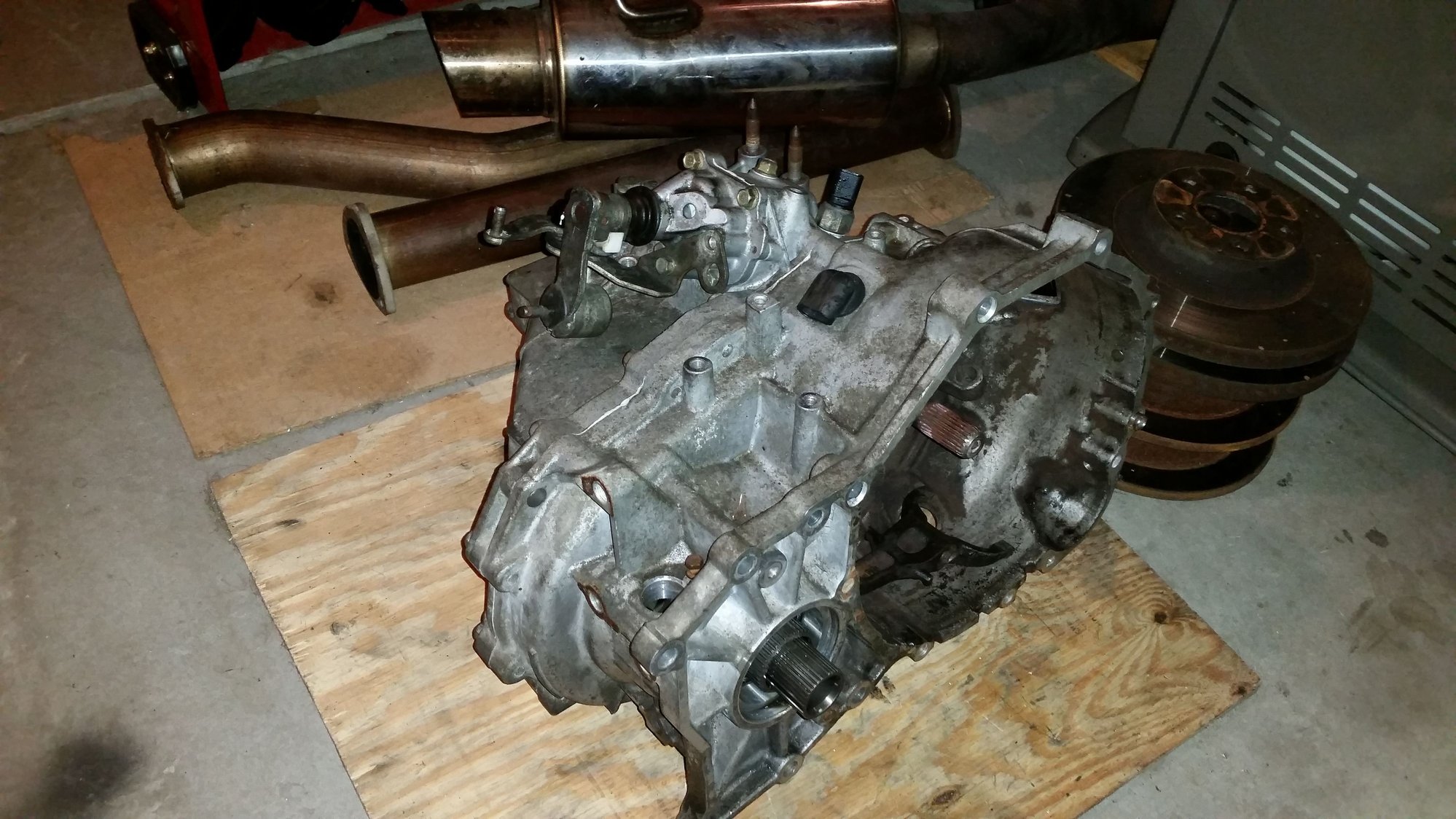

More small updates. Got fire tube on ABS sensors and cleaned up some wiring under fender liners. Went with 1/2" tube and it stretched enough to fit over the plug opposite to the sensor enough to get them on. I also wrapped the down-pipe. Picked up an Evo9 5 speed local for 400 dollar bucks. I think next I'm going to pull rear end and take both to TRE since they are only about 3hrs away. That is if I can get a hold of them 2 calls to a full VM box...

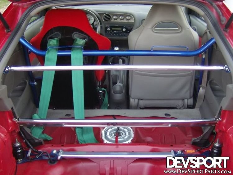

FWIW a harness bar isn't meant to mount harnesses to, it's meant to get the correct angle off the seats, in case your mounting spot is less than ideal.
People that use them to actually mount the harness are doing it all wrong.
correct way:

So many things going wrong in that photo I don't even know where to start, so here is a photo of another RSX doing things horribly wrong as well:

It's actually ideal for the harnesses to mount as close as possible to the seat, for the least amount of stretch in an impact. I.E., mounted to the harness bar. The harness bar should be part of at least a 4 point roll bar though.
correct way:
Not correct by a long shot. That kind of freaks me out........
Take a look at this video of one of many ways to properly mount the harness
Okay, you caught me bring lazy,Guilty. LOL
​My post was in protest of mounting a harness to a bolt in harness bar. Horrible idea.
It was explained to me that is how the bars are meant to be used; if your roll bar doesn't have one and you are forced to use mount points that aren't the greatest.
If that's wrong, I apologize. The info came from a vendor...wouldn't be the first time I was given bad info LOL
Agreed. IMO if someone has all the equipment to use a harness on the first place, they probably at least have a four-point with an integrated harness bar.
