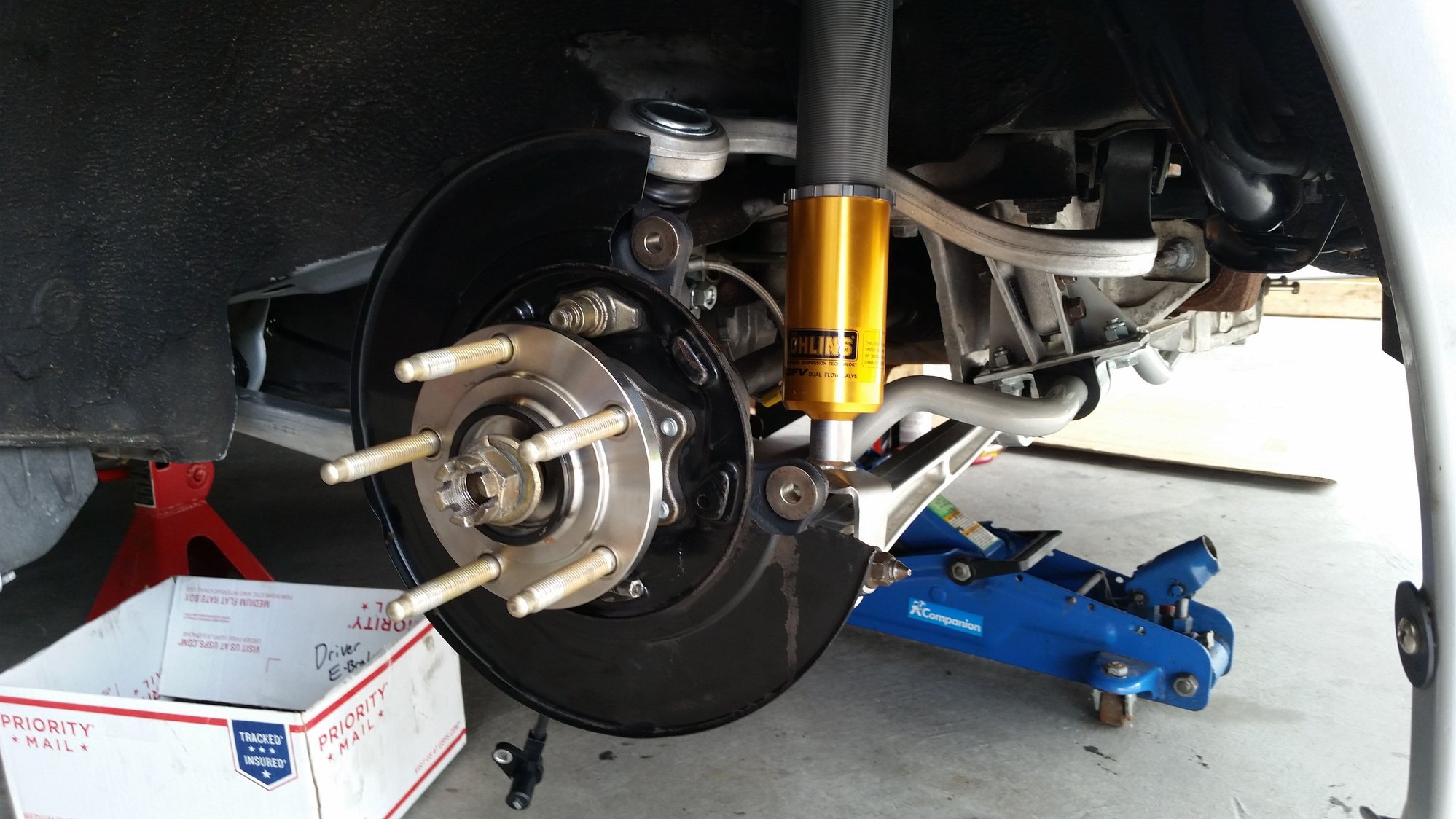

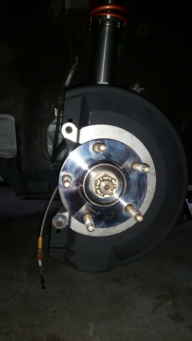

Smaller updates, got sway-bar and coil-overs installed. Trimmed back the brackets for the trailing arms. Sheet-metal sheers made quick work of them. Installed e-brake cables and got wheel speed sensors mounted up. Still need to clean the bores with my dremel before bolting them to the knuckle.
I also randomly find myself looking at the pics on my phone... at ALL THE MEAT UNDER THE CAR

Looking good keep up the good work! My only comment for now and even though the tire will not flex into the trailing arm that far but I would round off those corners of the tab with a file.
And man those shiny Ohlins are making me jealous. I pulled my wheel off the other day to check something for a member and I was horrified to see what mine look like right now. Im sure theyll clean up fine but sheesh seeing all these pictures of shiny parts is making me a little jealous haha!

Yeah I'll clean it up with a file just so it isnt sharp.
And I have not figured out yet if I ordered the bolt for the lower arm to strut and dint receive it, or just forgot to order it. Its the only not new bolt and frankly looks out of place haha. But that may just be me being OCD.
The bolts are fairly expensive but hey 15 bucks is a drop in the bucket at this point so just get it. Or dont because in a couple thousand miles you wont notice the difference anyway

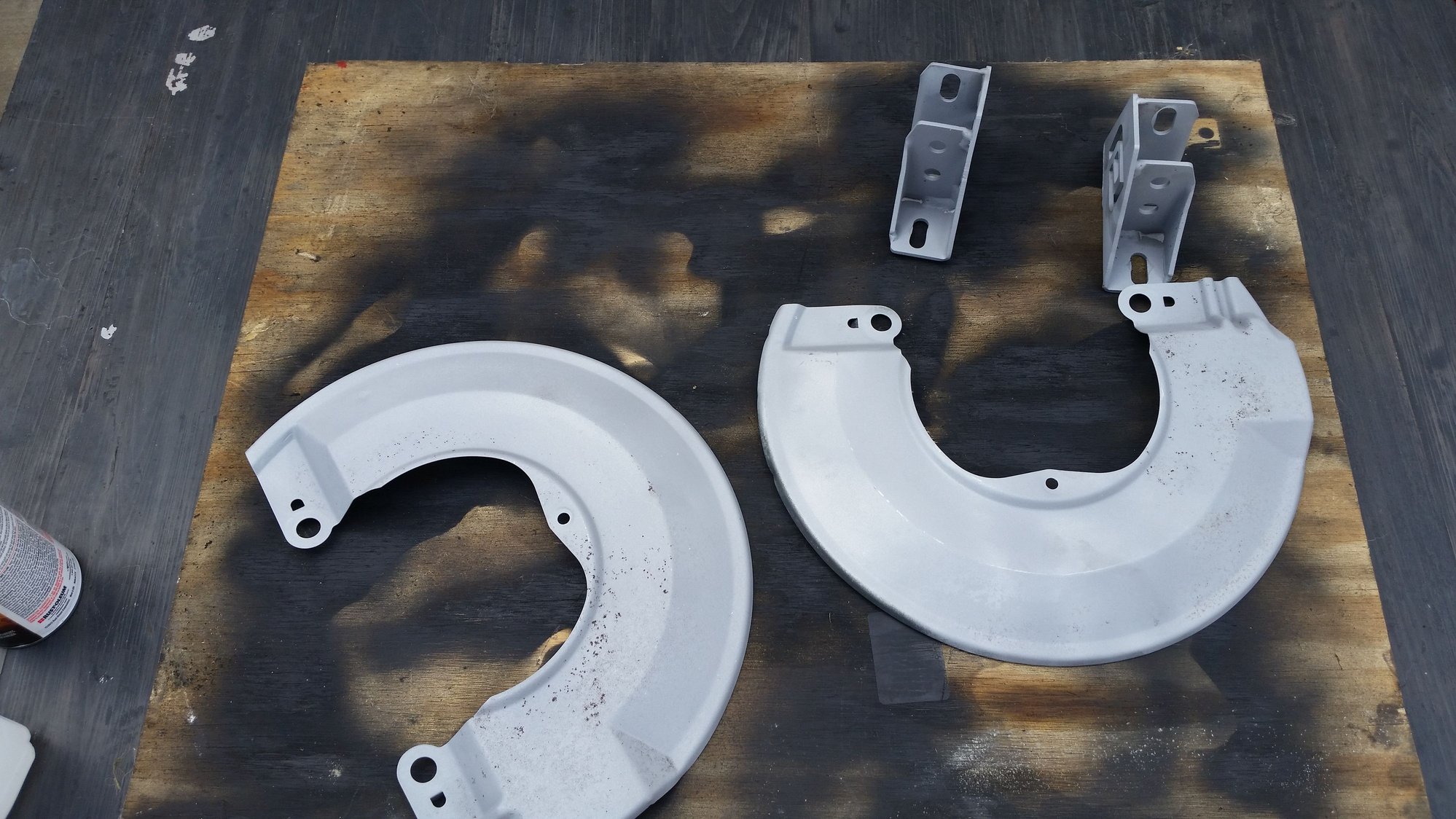

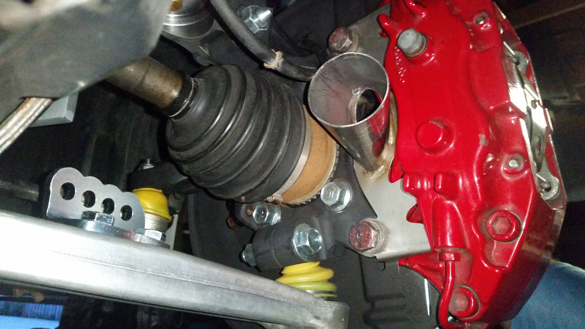

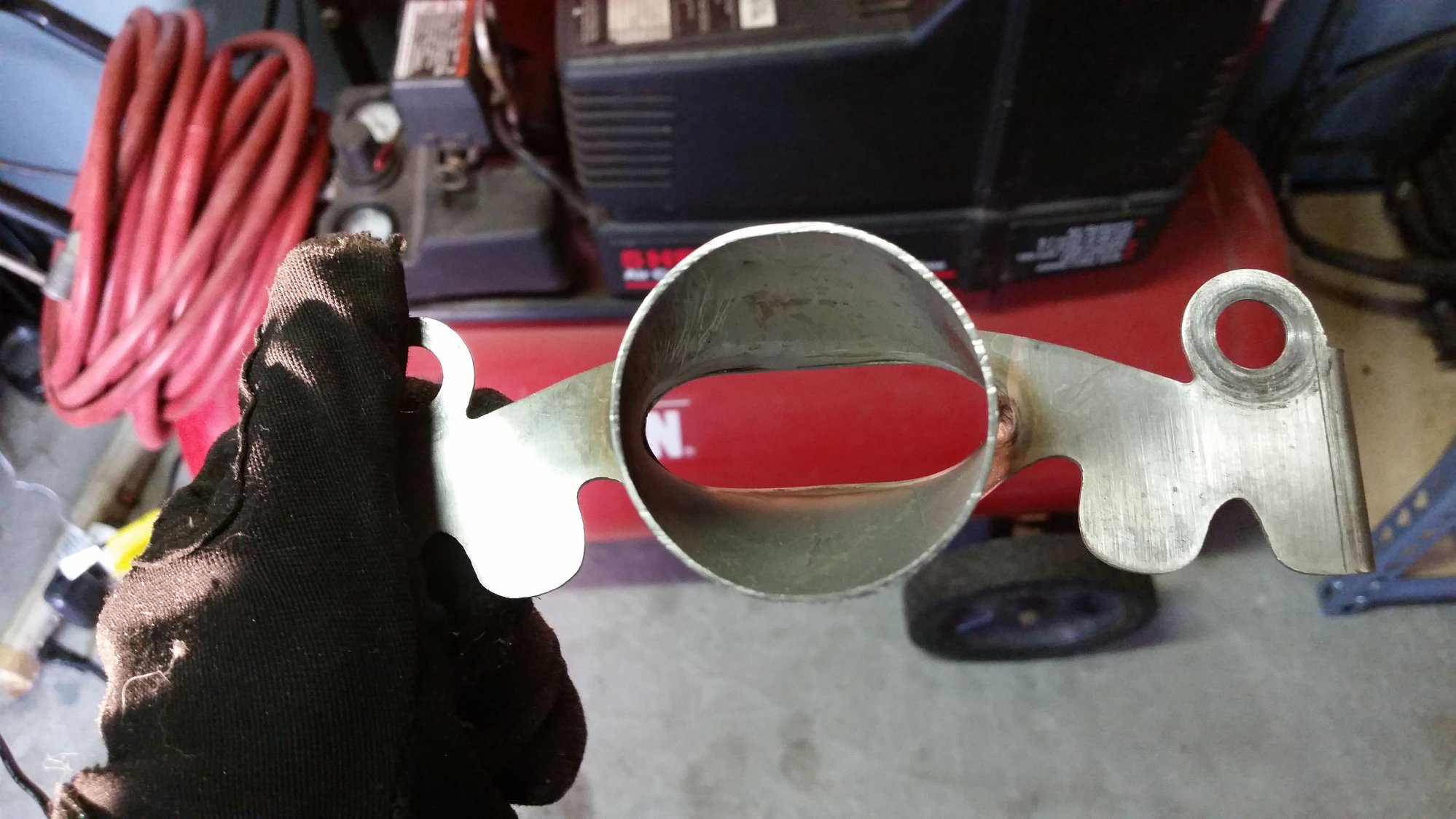

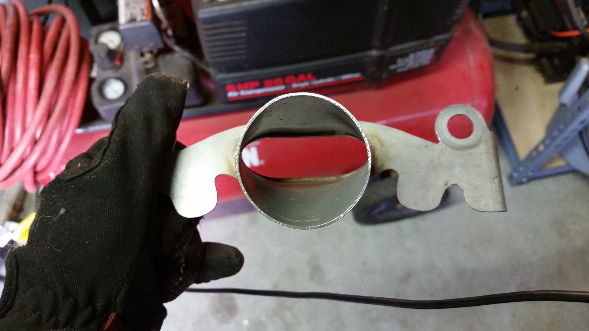

More small updates. Got brake shields sand blasted and repainted. Upon install I realized the AMS kit I picked up used on ebay calls for their removal. I monkeyed around and couldn't find a reason not to install them on top of OE shields besides weight. I also "ported" the ducts, got front calipers etc on. Thoughts?
Blasted. A fiend from High School runs a business. Also did Perrin mounts. Not sure if I will sell Perrin rear sway. Its a really nice piece. Might be better than the WhiteLine...
Painted with HT 2k Degree paint. Same paint I used for knuckles.
AMS shield over OE shield. No rubbing and maybe a pound of weight extra. I like the added functionality of keeping ball-joint/tie-rod/knuckled away from radiating heat. Also the wheel speed sensor mount is retained.

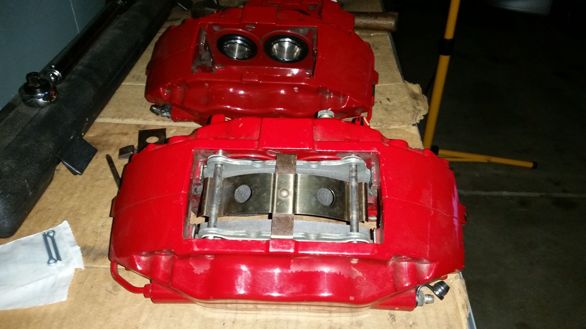

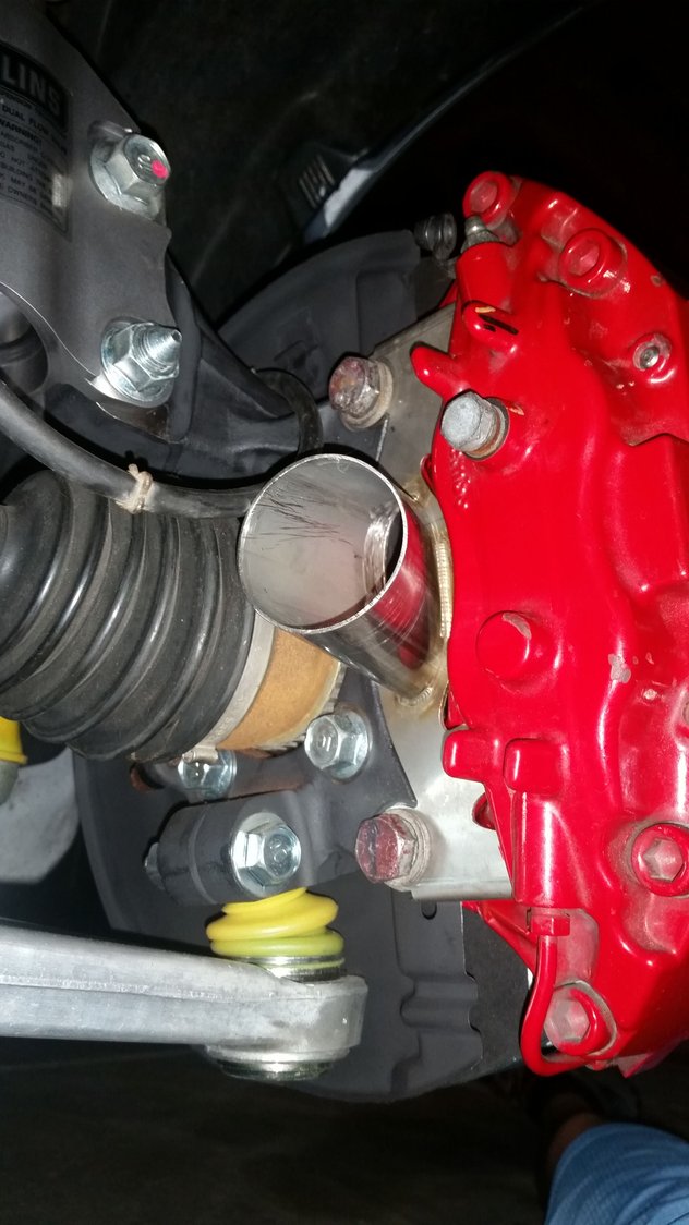

unported
ported
ST43 Pads and Titanium Shims

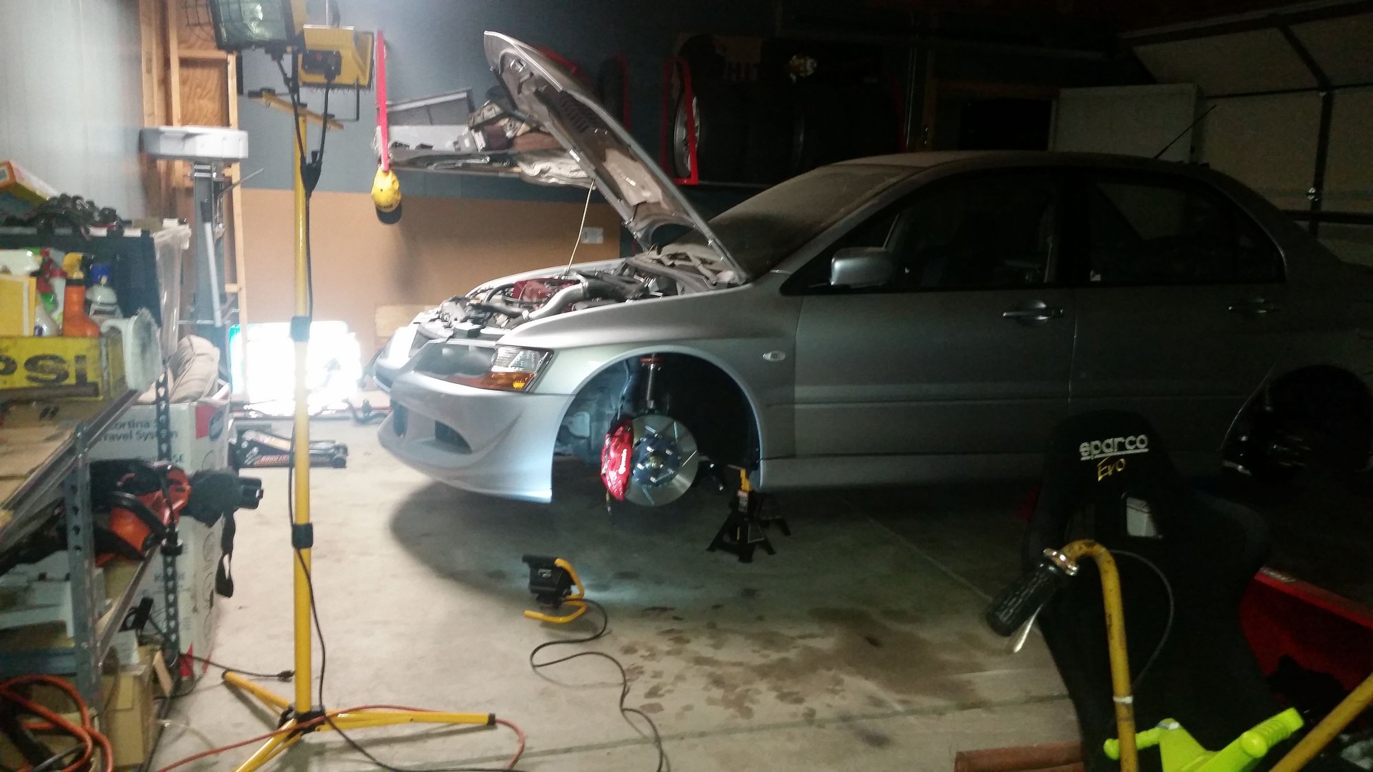

AMS duct installed.
Took evoM members advice, installed Cusco mounts in reverse with low pro bolt and without lock washer. Just used thread-locker.
Garage Shot

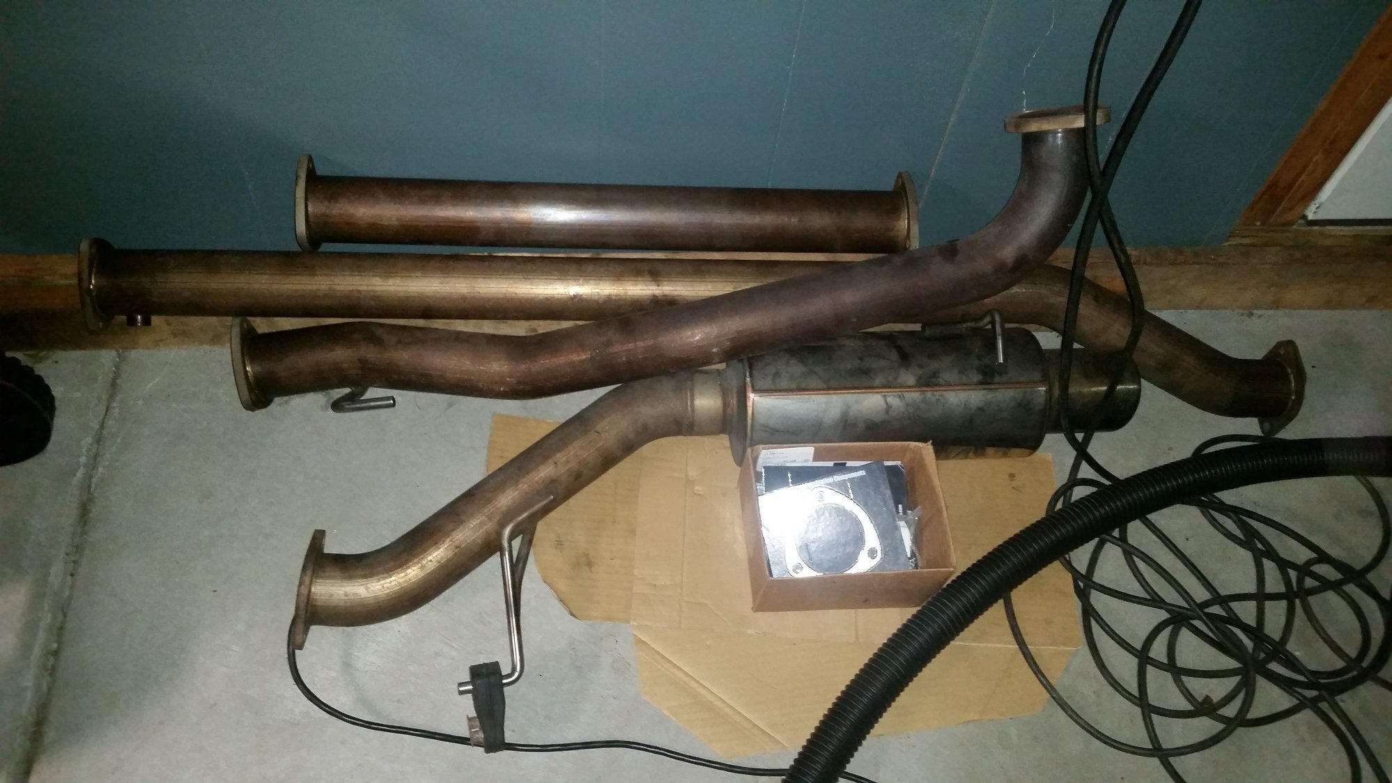

Disassembled exhaust. Old hardware was rusted and beat up. Have new hardware and gaskets.
