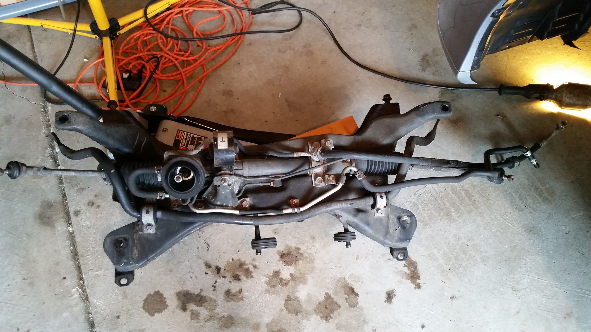

Ok got a lot more work done. Finished the caliper rebuild, dropped front sub-frame and installed rack bushings and front sway bar. Also cleaned and painted some of the mounts.
I have fallen into the "spiral". Everything I take off/work on, I find more stuff to buy and install "while I'm at it".
Going to take this "opportunity" to also do complete engine/trans mounts. Just ordered the Torque Solutions 4 piece kit. Also exhaust hangers.
And because I am a little OCD I ordered most of the bolts/nuts and hardware I have removed new from mitsubishiparts.net.
All rebuilt!
Fresh out from under the car.
Disassembled
All together. A little more cleaning after this photo

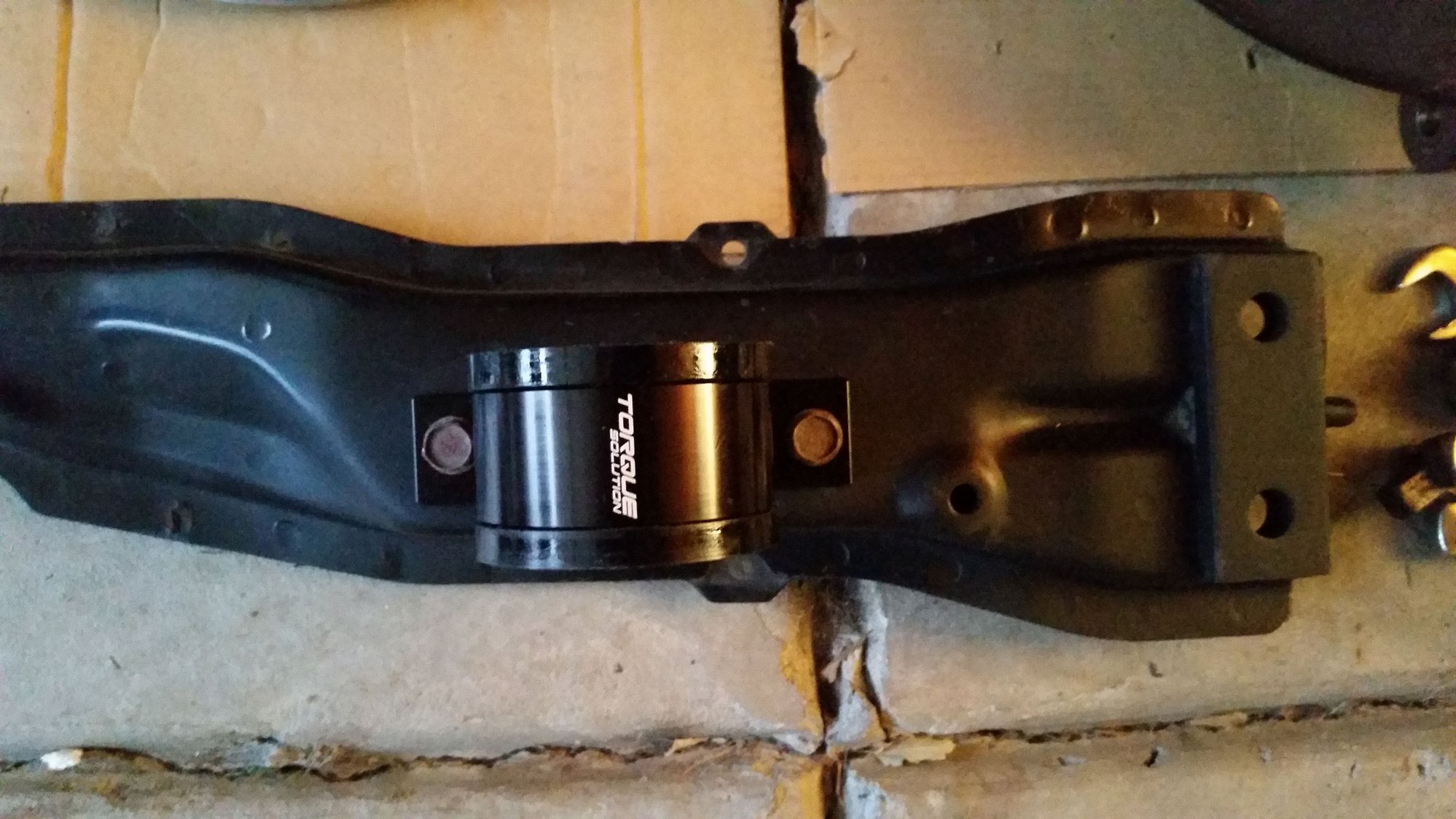

Some smaller updates. Cleaned the knuckles. I think that's what they are called lol. Shot some paint at them too. Also installed ARP studs on Timken front hub/bearing ***. Still waiting on rear from mitsubishiparts.net. Also waiting on hardware from them to get start to put all this back together.
Got motor mounts replaced with TS pieces also.
Before cleaning/painting. Just getting started on mating surfaces.
Hubs with ARP studs, knuckles/spindles cleaned and painted.
Rear mount/sub frame. Also cleaned/painted the bracket.
Front mount
