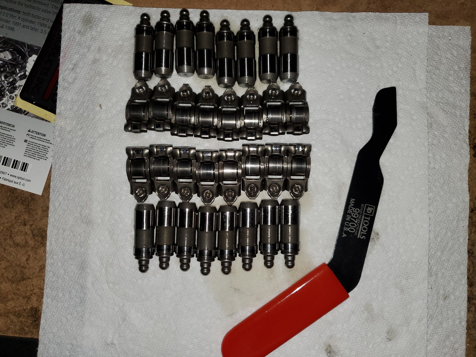

Well instead of wrapping up gauges I decided to chase a lifter tick. Scooped up GSC no ticks only because im not paying almost a grand for OEM. In so doing I think im gonna need to replace a few rockers... found a few chewed up at the valve side...

Finally got the GSC Zerotick lifters and 5 new rockers installed. Bled them down completely so they would just be on internal spring pressure. Primed the motor a bit and ran it. Just drove to work and she sounds and feels great. Have another 20mile highway drive home so we'll see how they sound again tomorrow.
Had to use the tool for the spings on the on the opposite side of what the directions indicate because the lobes on the S2 are wide and I could not fit the tool between the cam cap and lobe. Also had to use some creative leverage against the cam where there arent lobes obviously but they're in. Did it all without pulling the cams since the HLAs could be compressed by hand I was able to get the rockers installed. Did have to loosen the intake cam though to get most of that side in.

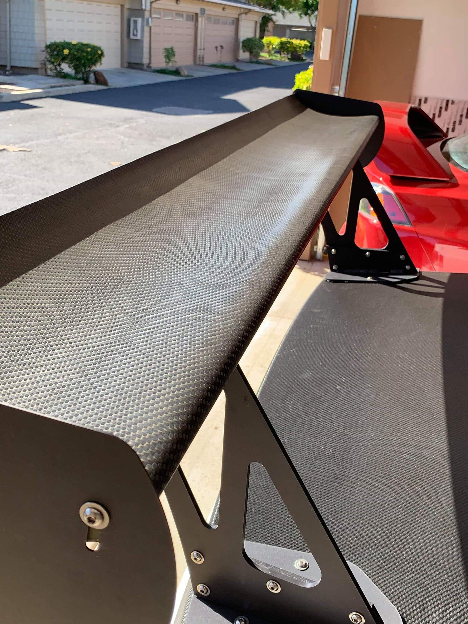

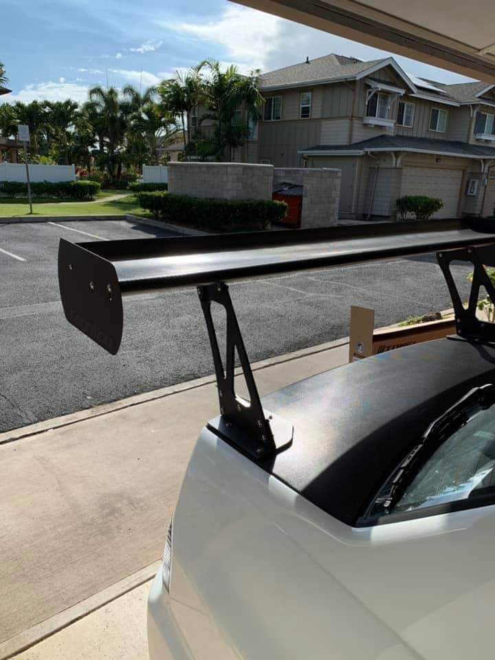

Also picked up a Kognition Wing for a decent deal from a guy in Hawaii. Should have it in the next couple days.

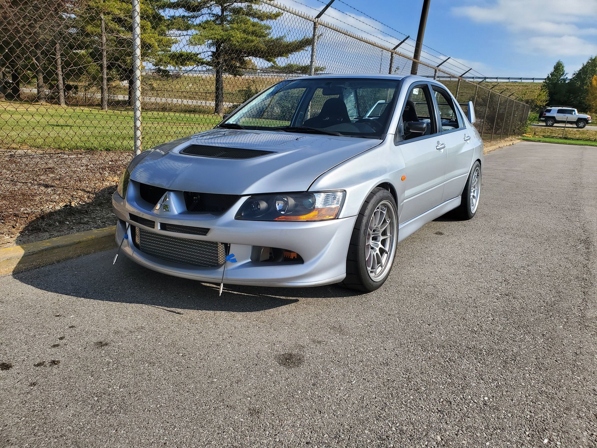

Well I'm impressed with these lifters. They sound fantastic. I've cured my tick with these and some new rockers. The car has never felt or handled better. Nice cool 60 degree days and the engine loves it too. Gotta burn off this tank of E85 and throw some pump gas in it for the winters hibernation. Cant wait to get the rest of Dallas's bits put in, finish gauges, the wing and splitter too.
The only 2 other things I want to do to this car are a cage and a drysump. Then it'll be "complete" as far as I'm concerned.
Idle video from today with the cam gear cover back on. And a couple pics from when I arrived at the office.

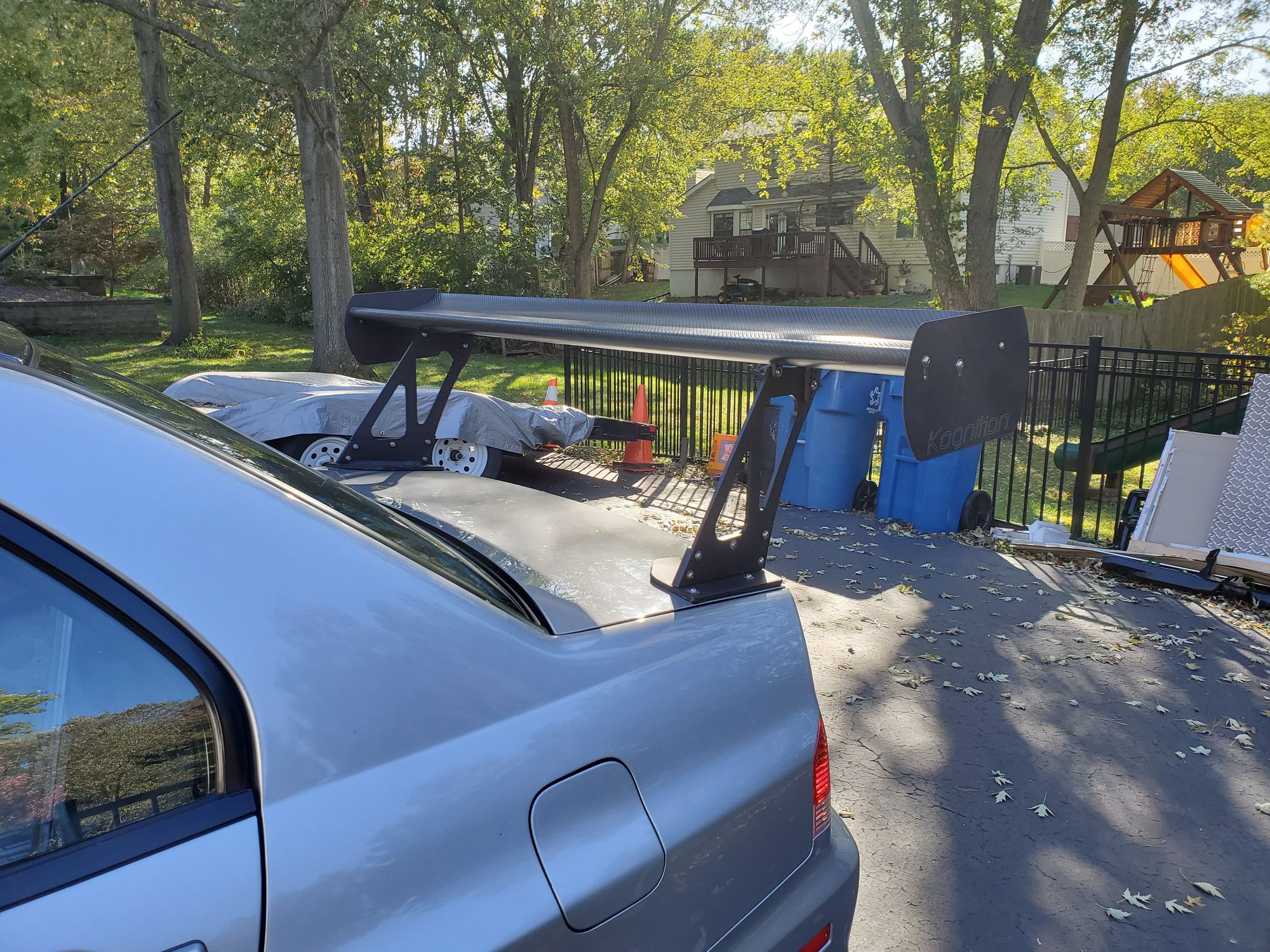

God it looks so good without the wing. But I got a new toy today...

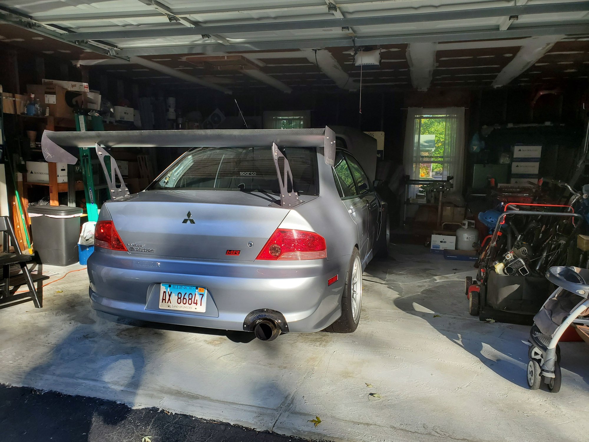

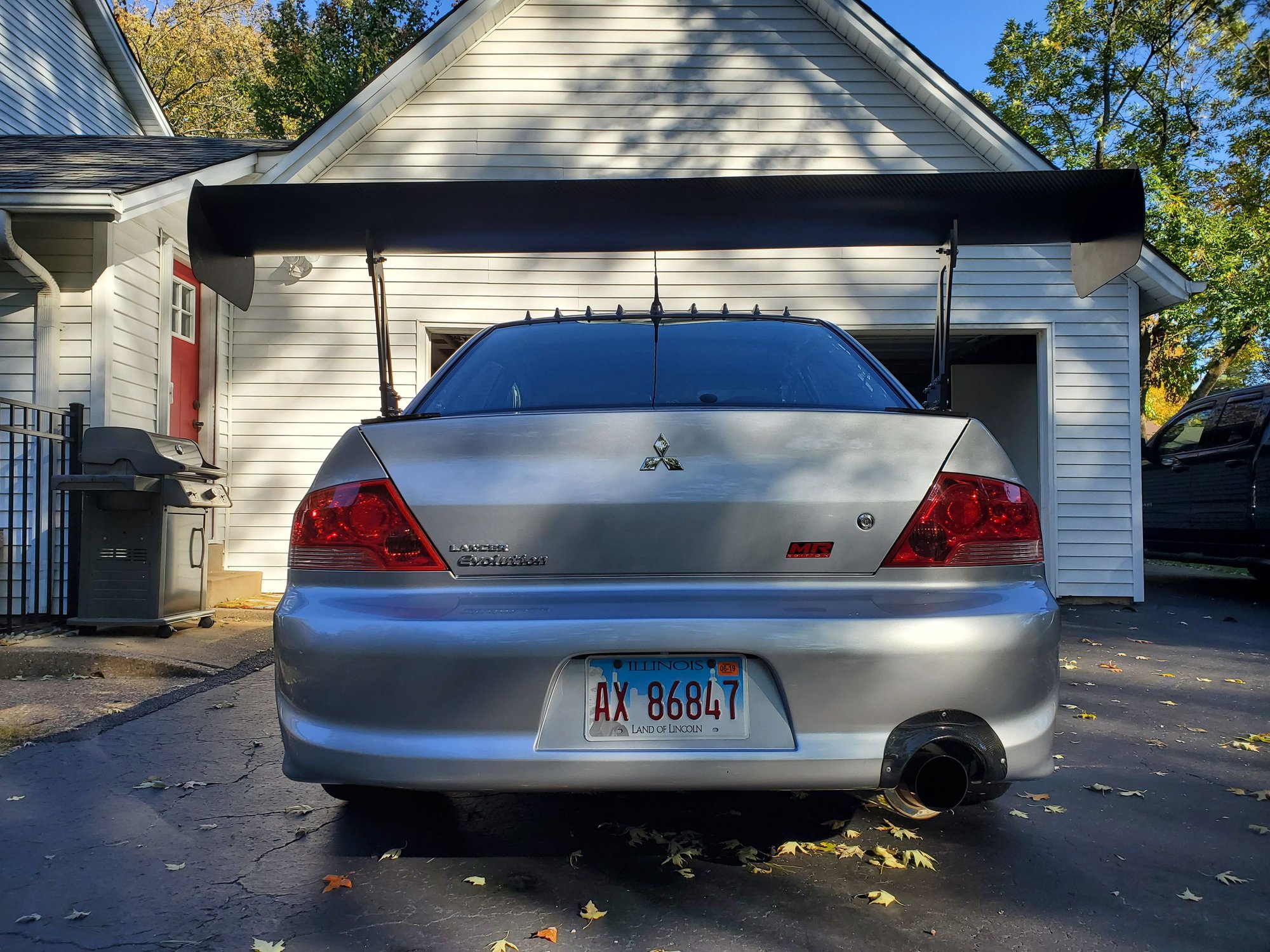

From: STL
Just roughed in. Haven't drilled 3rd holes or and kind of braces. But got damn its big.
