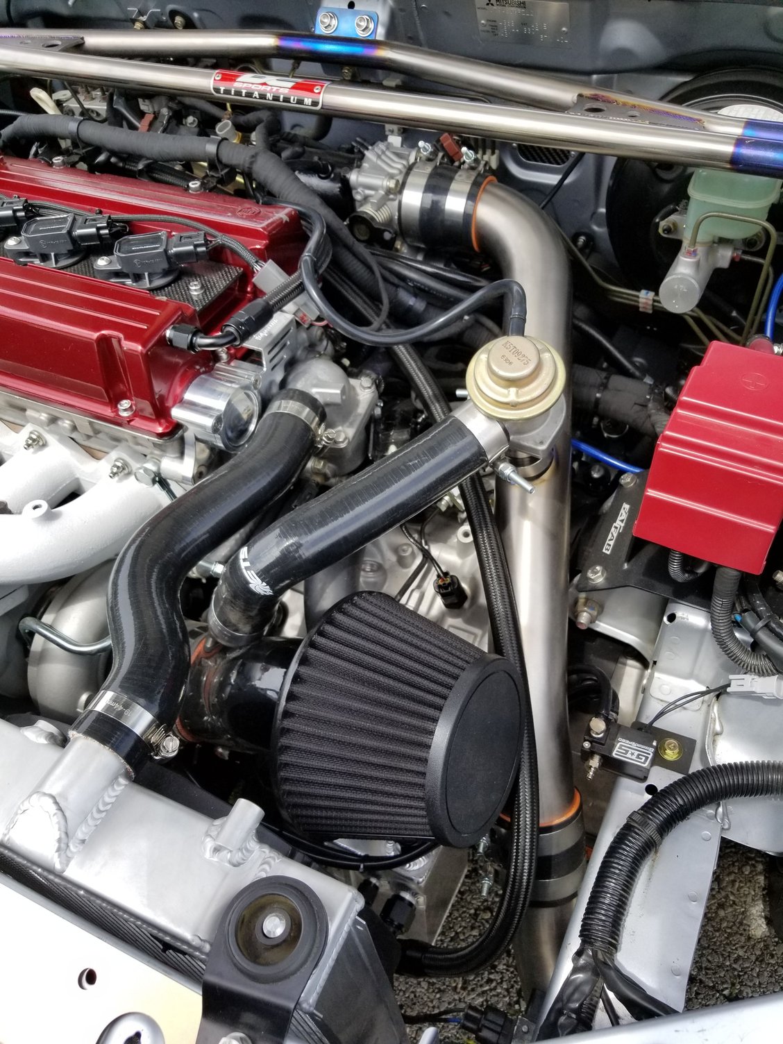

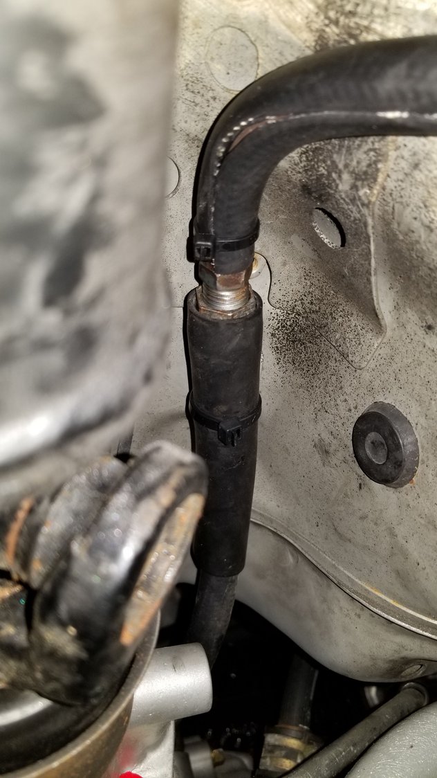

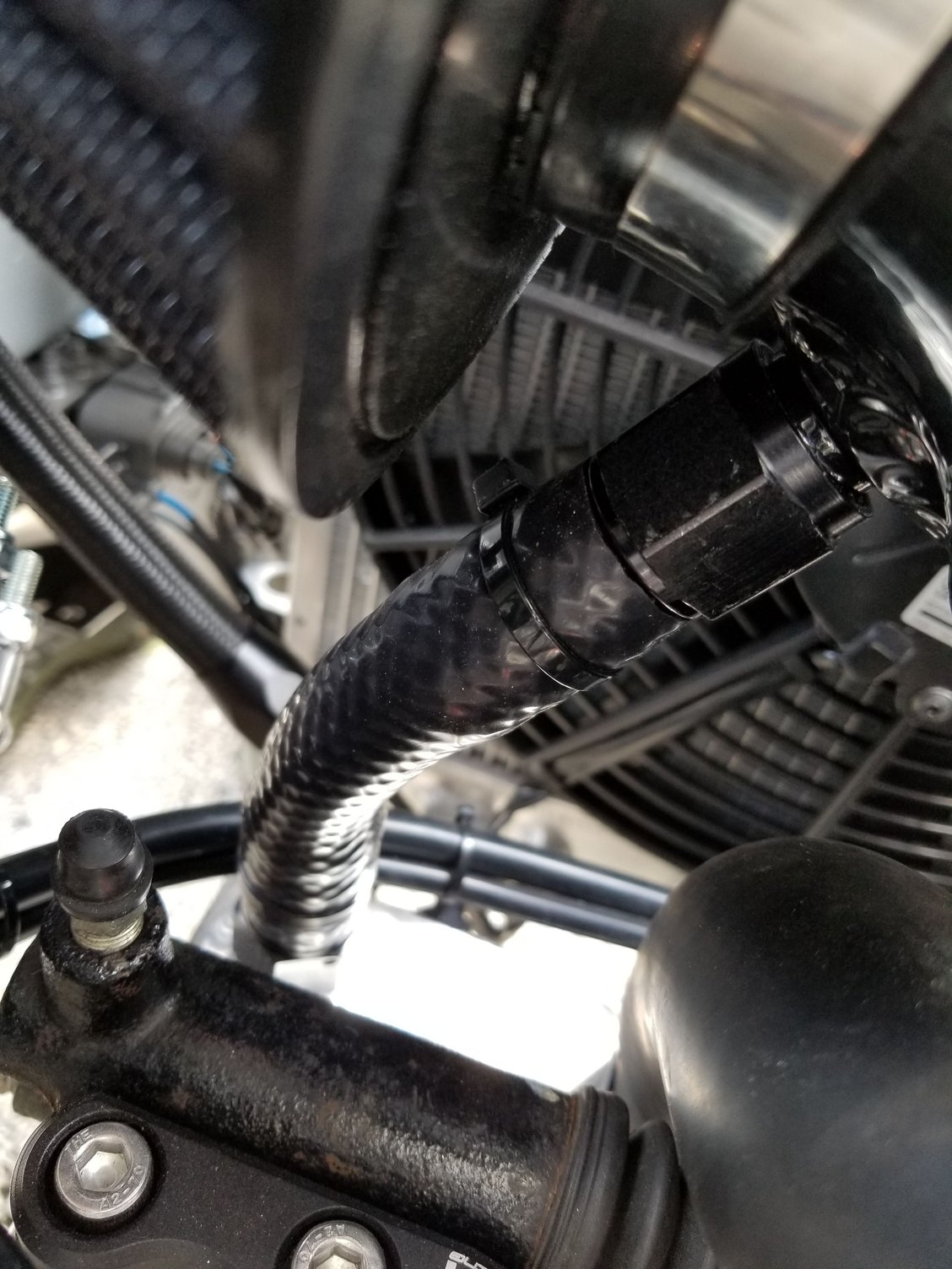

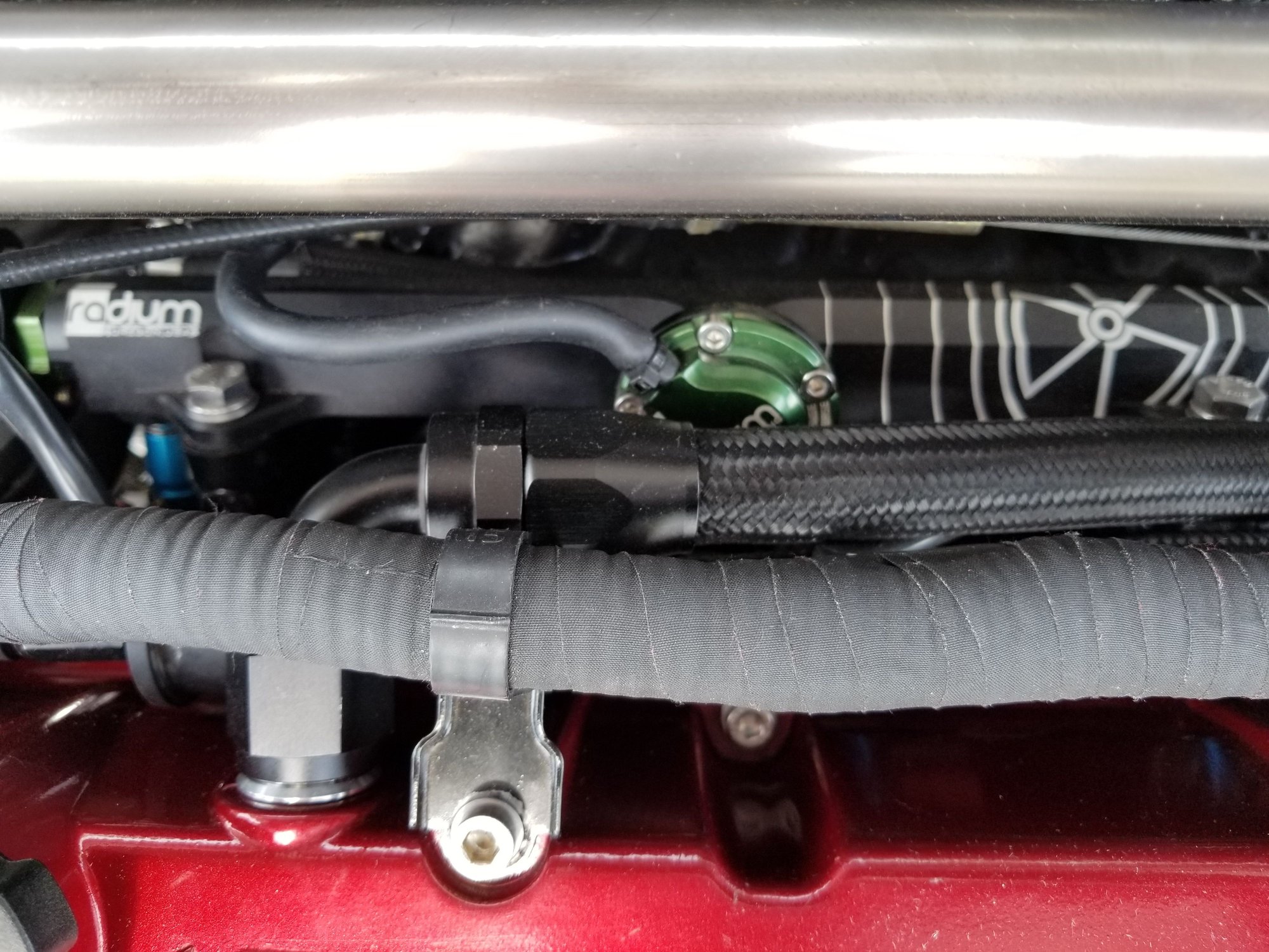

Got the Catch can buttoned up. Also put a rubber grommet or bushing I had lying around on the fittings going to the IM to keep it from rattling around.The kit comes with AN line and fittings from intake to the can, but i dont see how this can work. The fittings practically touch one another by themselves. So I got AN10 to barb fittings and put a piece of hose inbetween. Everything works great but I dont see how my DV wouldnt pressurize the can/crank case when it lets go of boost. There is no check valve on the intake side... maybe ill VTA the diverter valve.
Also playing around with cel flash on knock. Went for a semi spirited drive for about 30mins. Showed max of 2 counts around 2800 a few times in evoscan. Im not pushing it or anything just light throttle. I set knock thresholds to 2 and 4, after 90 load. No flashes anywhere while crusing around with some boosting on occasion. Car is still only being fed 100 octane. Next I need a boost gauge and AFR next.
with the fan controller hooked up, and these crappy but silent brake pads I can go anywhere. Such a pleasure to drive. Still no issues or leaks knock on wood.

Someone posted pics that STM emailed them for the can to intake lines in another thread. You point the fittings away from each other, and the line wraps around the LICP. Kinda silly IMO. What you did is clean.

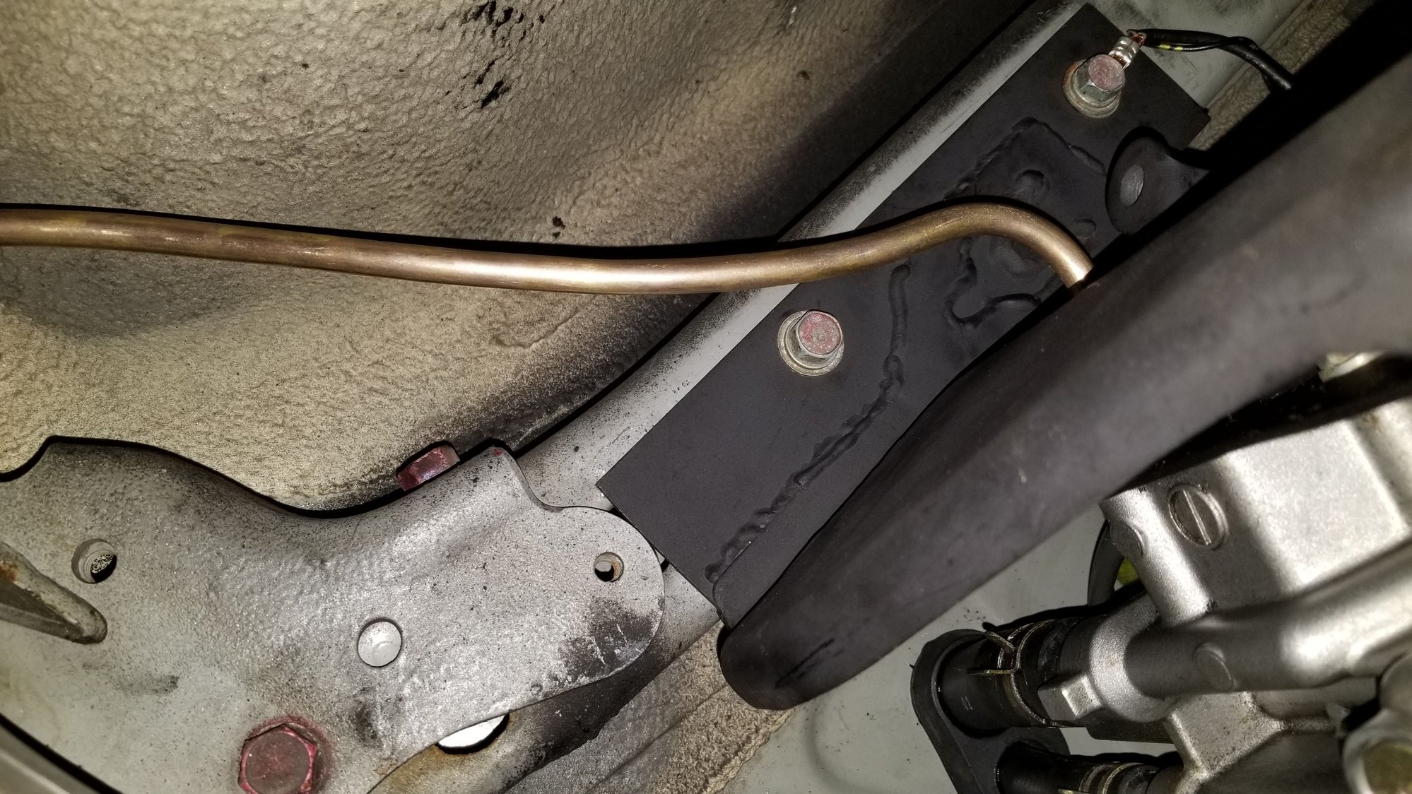

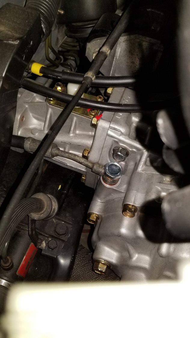

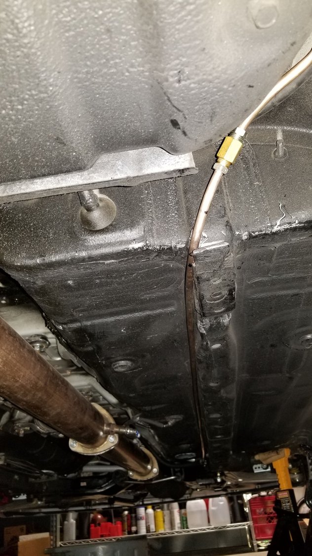

So after a few retries I finally have the ACD pump wired and plumbed. Bled with mittyvac and key on full throttle to turn on pump. Builds pressure and no leaks so far. Had leaks at the banjo fitting at the tcase. Ended up getting new banjo bolt and crush washers. Wound up making line from 5/16" nicop and used my ridgid double flare tool. Line is in 2 pieces with a union in the middle. Used some heater hose as insulation where there was some contact or chance of abrasion/heat. The line is just roughly secured, still need to drill some holes for line clamps.

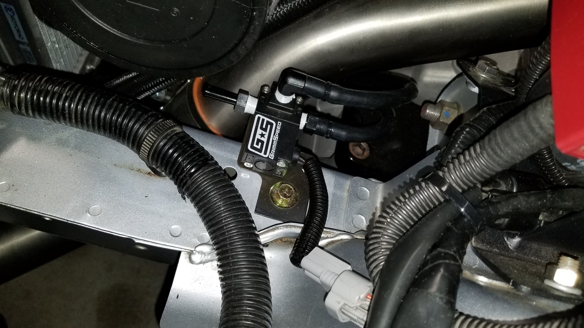

Managed to also wire up the grimmspeed 3 port as well as MAT sensor. Just need to pin them still on the ecu side.
oh and shout out to Ayoustin who came over to drink cold beer in the 90 degree temps and helped get Dallas's rear spring perches installed.

Lol bet youre glad the ACD line is done huh? Looking good! I too ended up using 2 lines with a union. I tried to do it in 1 piece but it jsut wasnt happening. I see you used the Nicop for the whole thing; that's what I should have done bc its so much nicer to work with.
