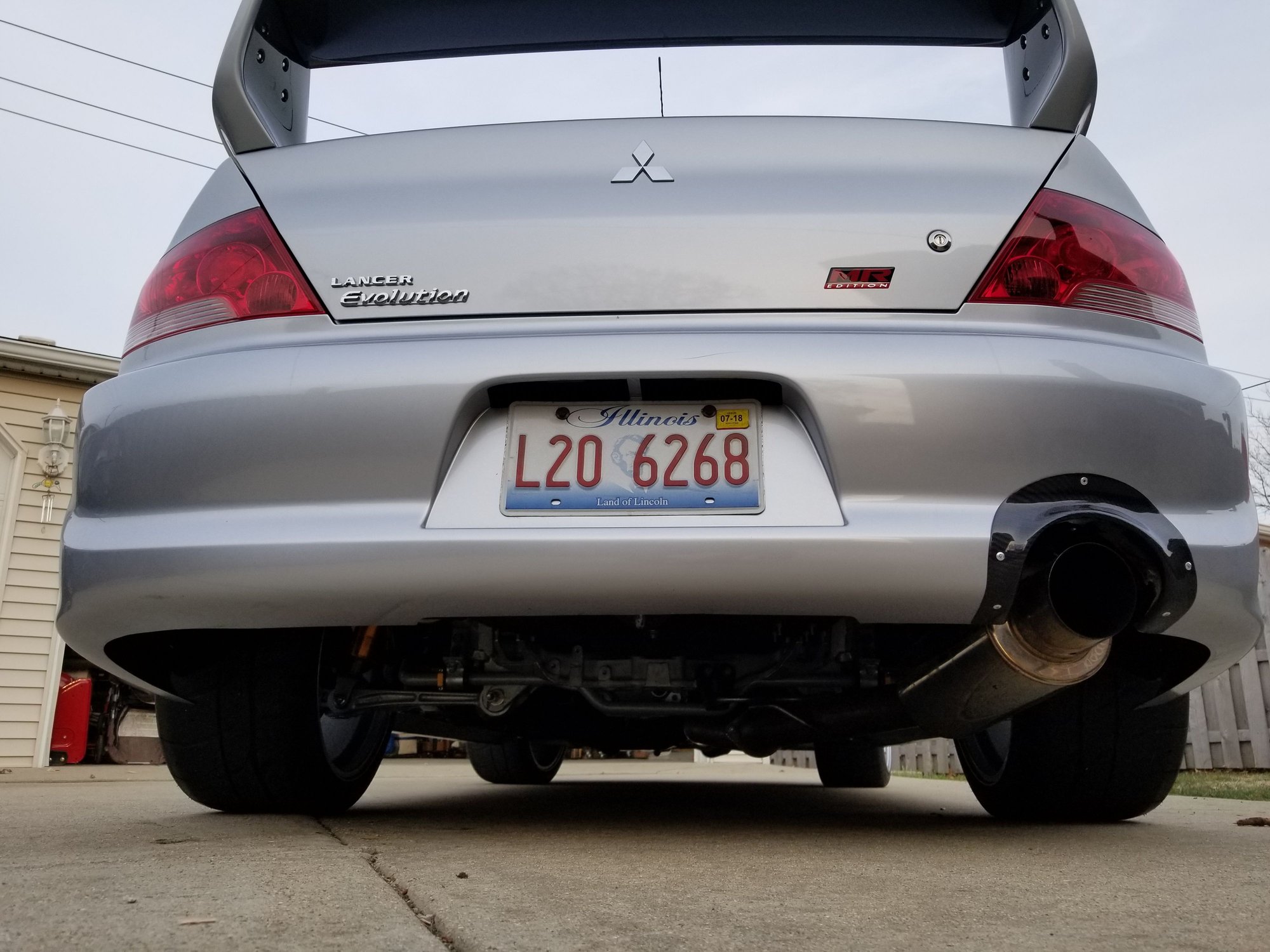

Lowered it 1/2" in front and 1/4 in the rear. Put OE pad shims in and the squeel is "better". Washed it too.
might go a lil lower the the front but wana keep the car levelish. Hard to see how it sits in my slanted driveway and nonlevel camera...

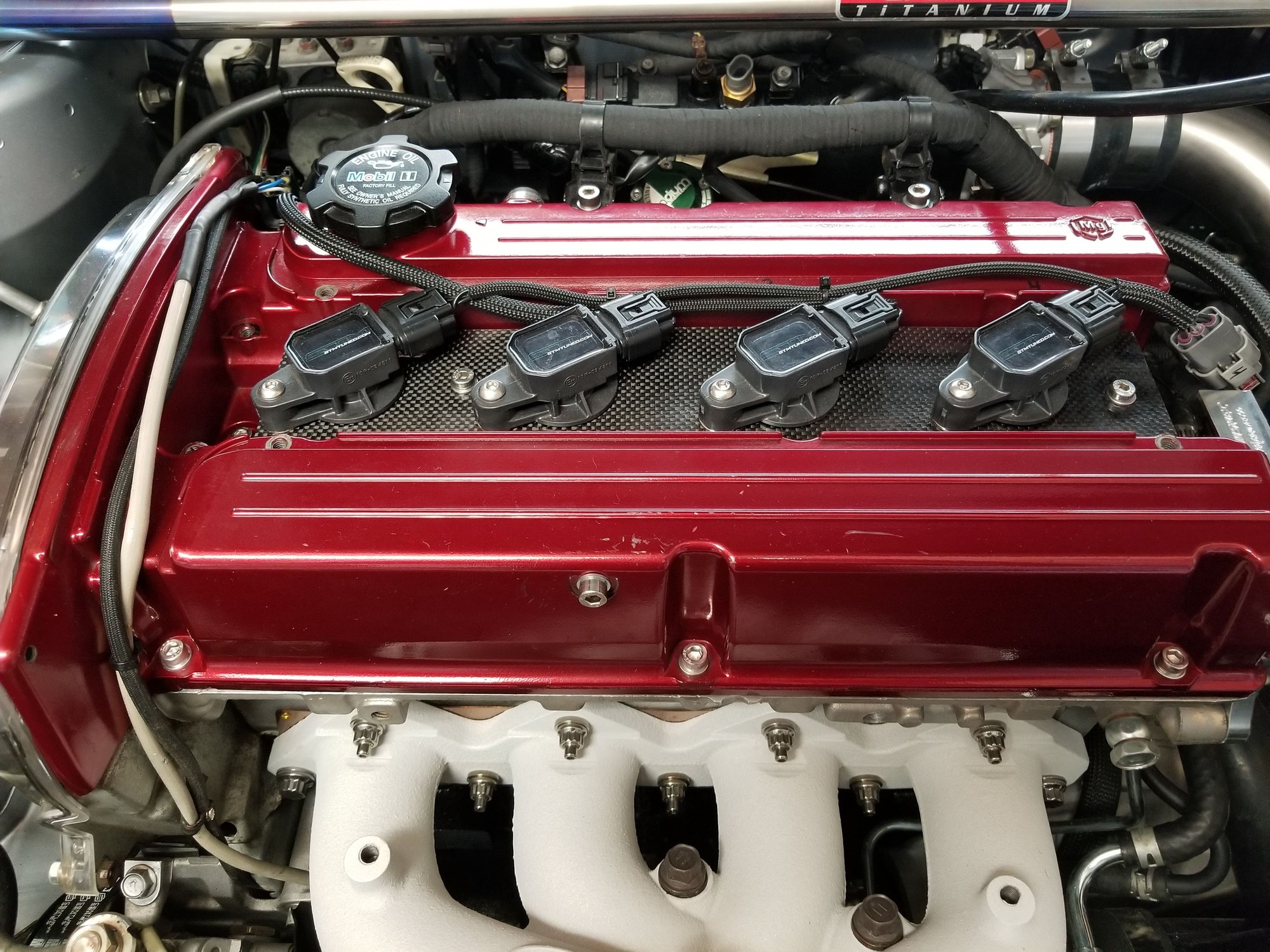

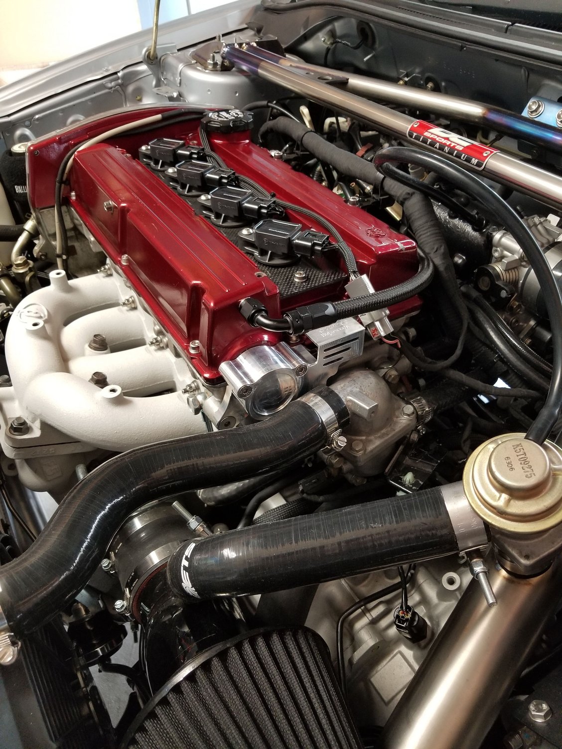

managed complete fluid change including coolant since I had to remove upper rad hose to put reverse cam housing on. Just a bling piece for me, but would help with tubular headers.
since I had valve cover off to tighten head studs i threw on some arp ss valve cover bolts. Head studs all turned about 1/4 to 1/2 turn...

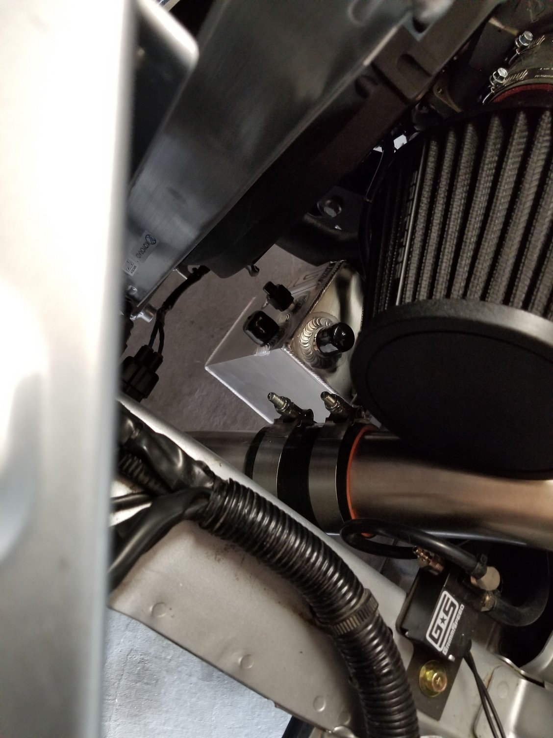

Also mounted fan controller and started on catch can since vc was off. Enlarged one of the fan cntrl holes for the larger bolt and mounted it where the ACD pump was. First foray into AN fittings and line, messed up 1 line and have ordered replacement stuff.

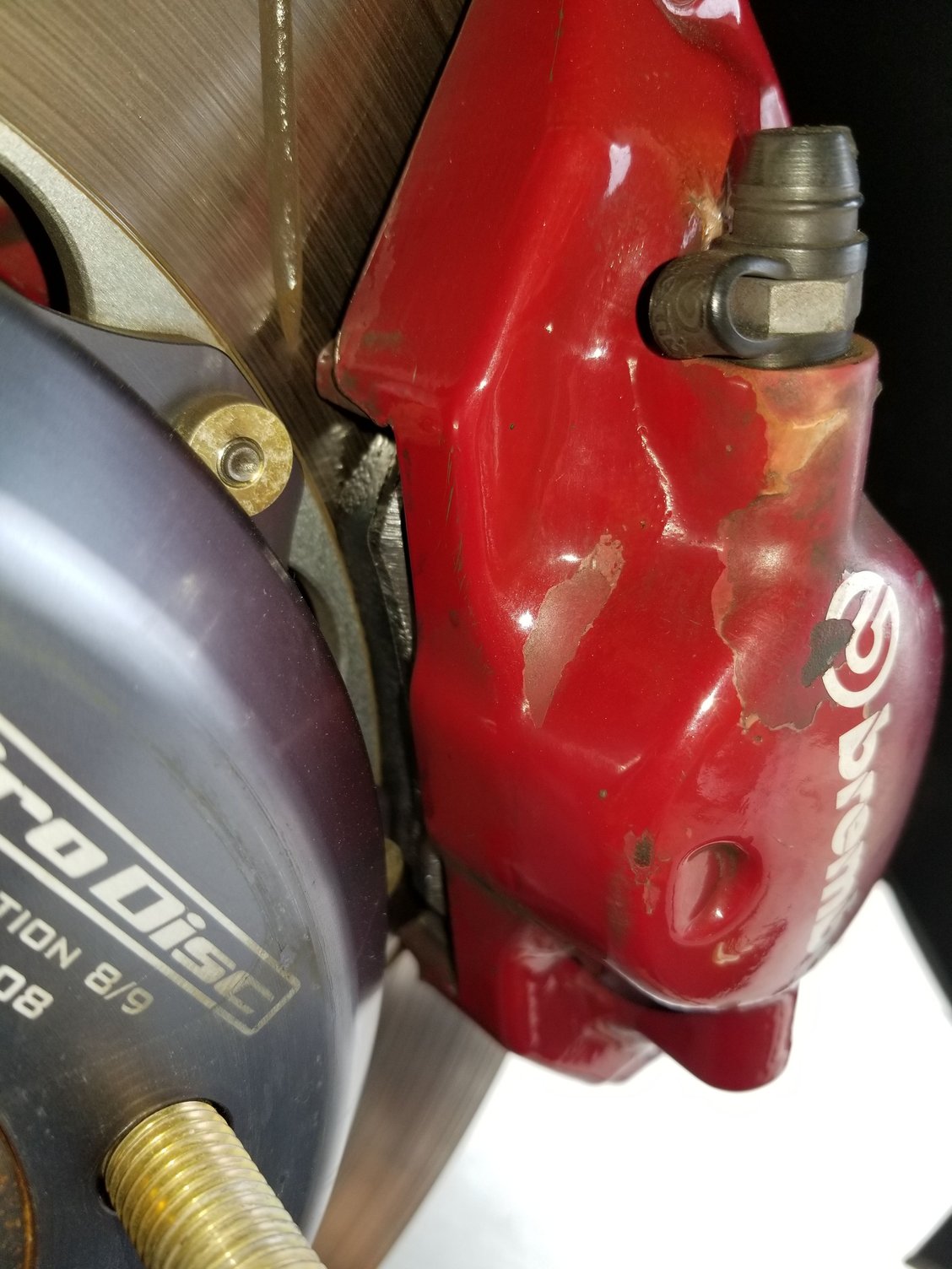

oh yeah. Threw on CHEAP orieliys front n rear brake pads. Had to shave the pad backing down to clear center hat of rear rotors. St43 just too loud on the street and i know they'll chew up my rotors.
