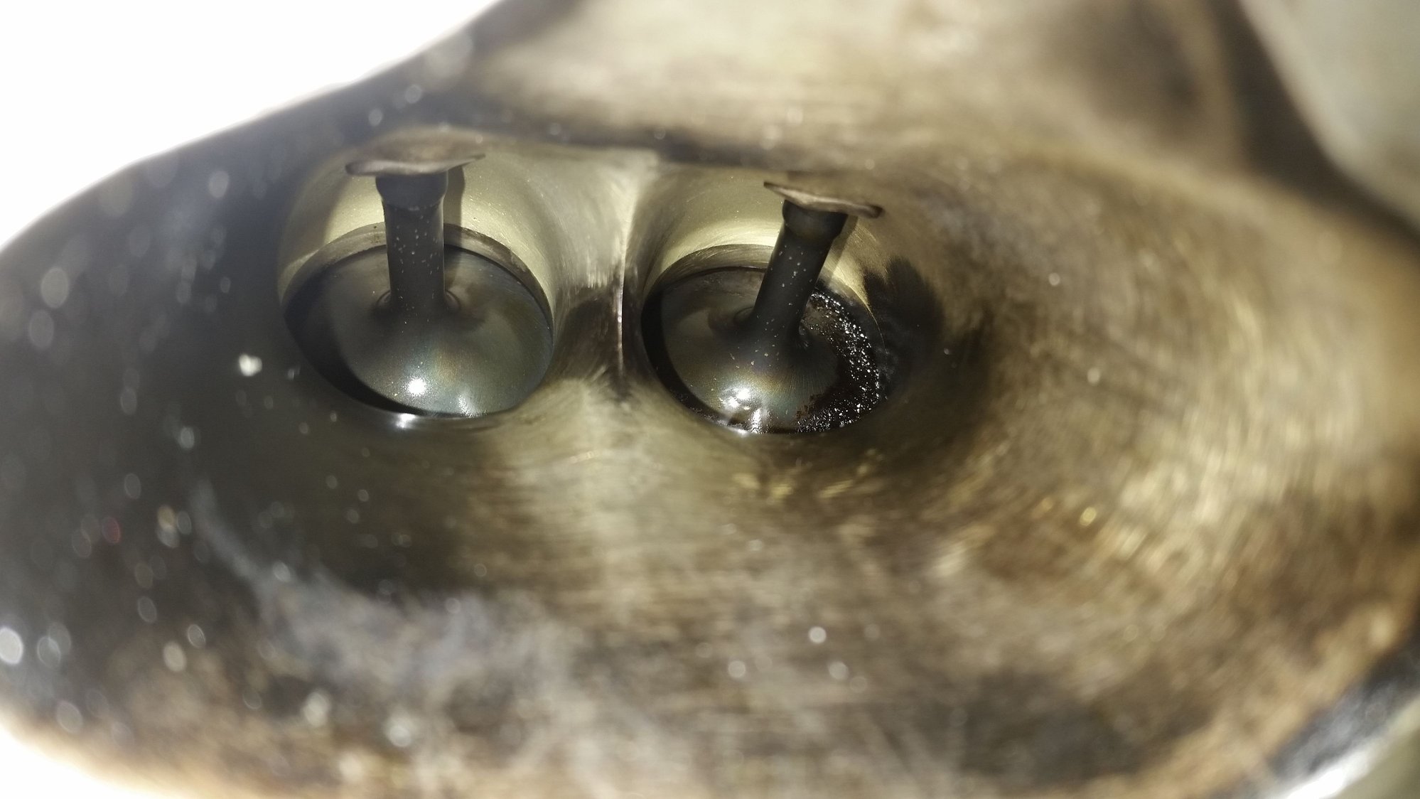

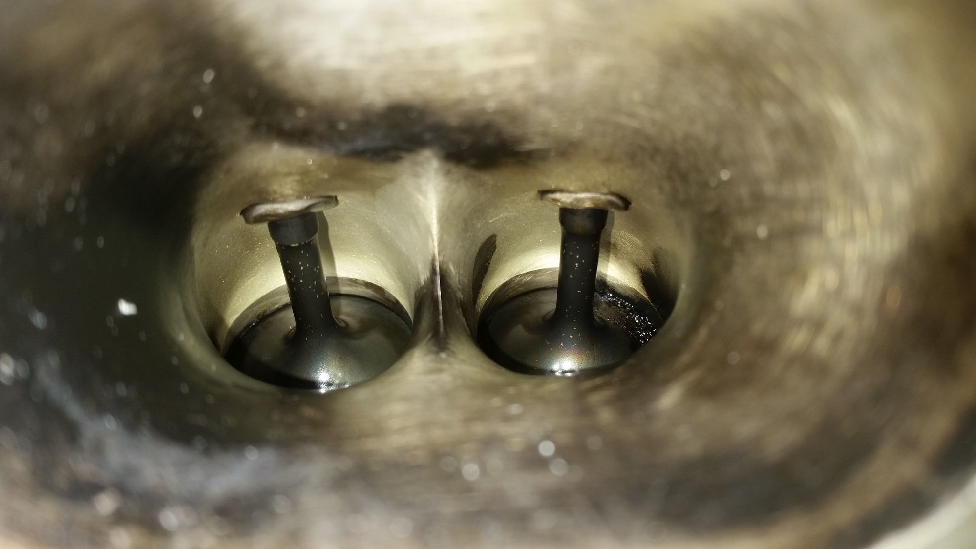

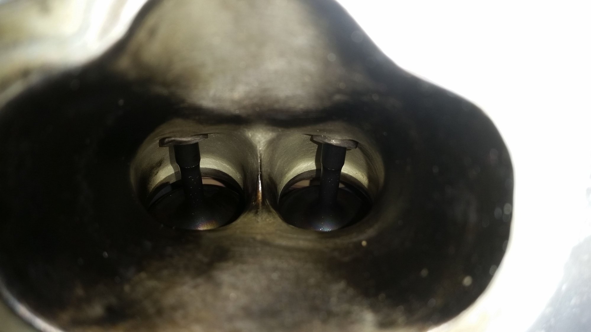

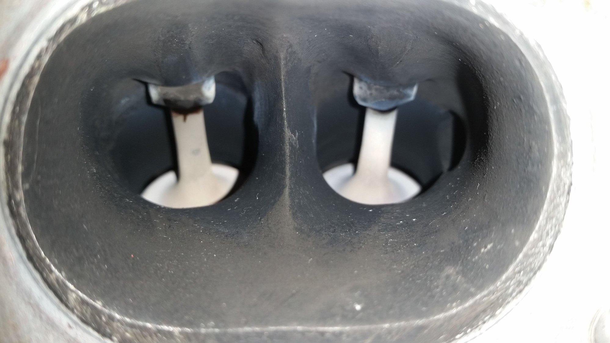

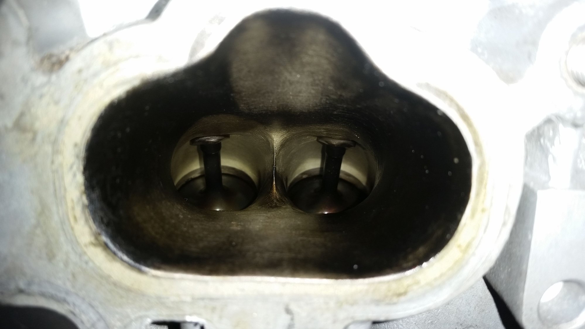

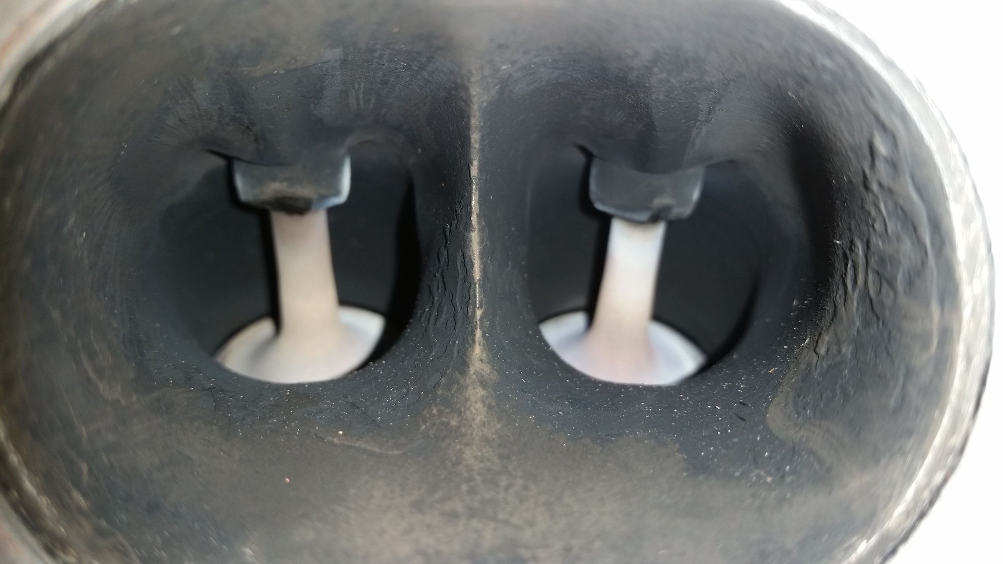

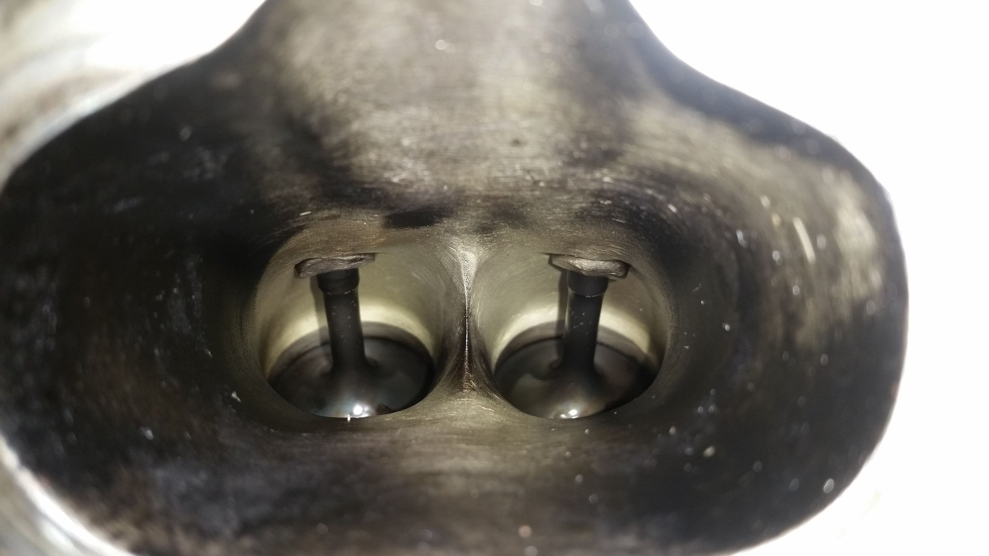

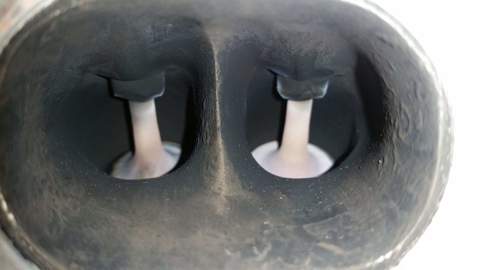

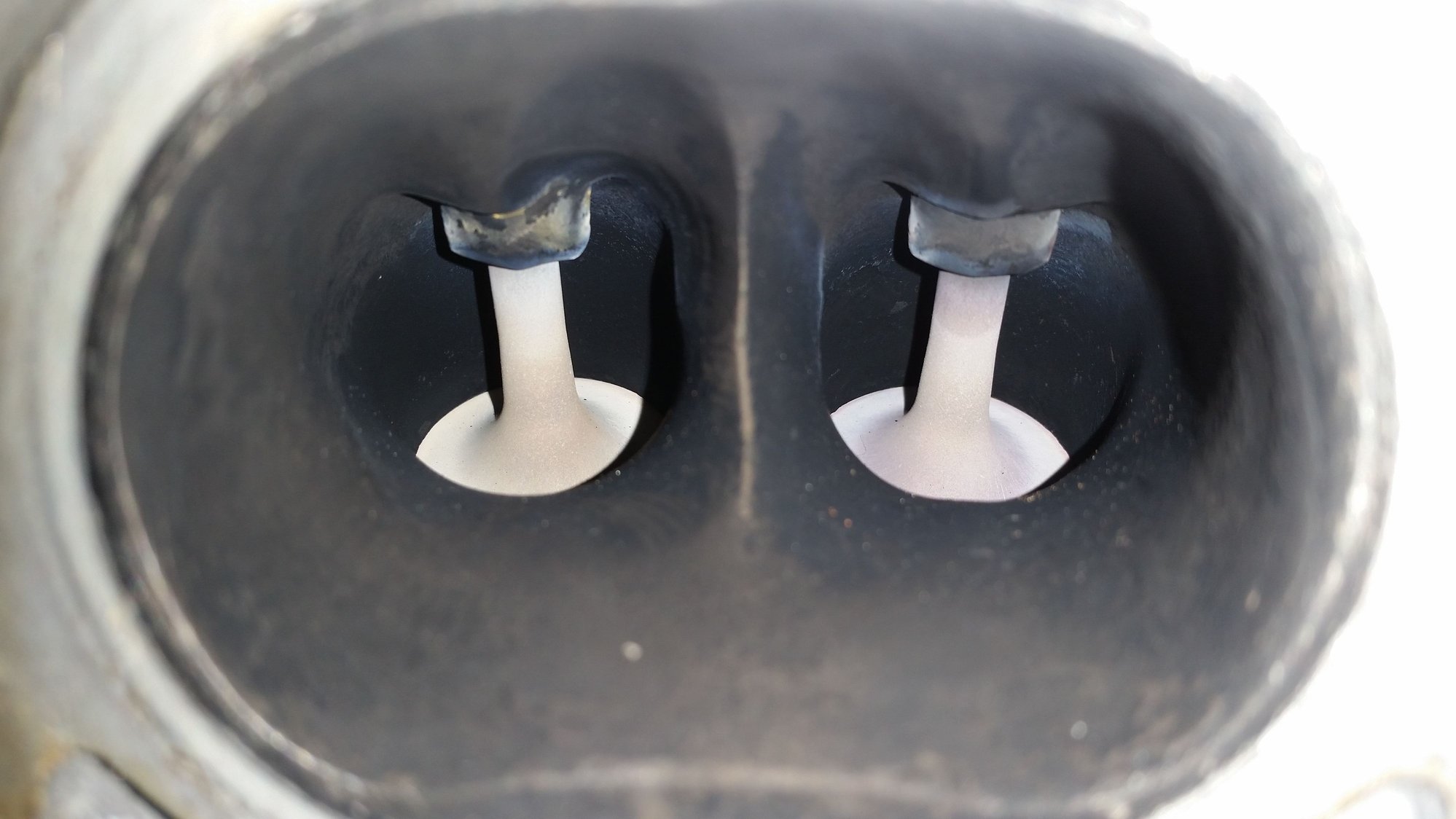

Looking for meaningful feedback here.
Since Ive got the motor out I am thinking of removing the head. It seems no catch-can and having EGR has left some build up on 1 or 2 of my valves.
I am contemplating pulling the head, getting more porting + polish, valve job, and swapping cams to Kelford 272. I also think welding the EGR port IN the runner could be possible. Also doing full EGR delete, phenolic spacer which I ordered from English, and ARP stainless studs/bolts.
Here are the images of each port on exhaust. Need input here.
Old Feb 23, 2017 | 09:43 AM
  #340
V.8MR's Avatar
Joined: Nov 2006
Posts: 2,249
Likes: 236
From: STL
Intake
NOTICE BUILD UP HERE
SAME PORT AS PREV IMAGE, DIFF ANGLE
  #341
LetsGetThisDone's Avatar
Joined: Oct 2013
Posts: 15,973
Likes: 1,629
looks pretty fine/normal.
Old Feb 23, 2017 | 10:22 AM
  #342
RazorLab's Avatar
Posts: 14,094
Likes: 1,092
From: Mid-Hudson, NY
Looks normal to me too. Catch can won't do much more than that.

From: STL
No benefit from what I was planning? Just feels like I should do as much as i can while i have an opportunity. I dont like intake cylinder ones gook on the valve. Plus welding of the egr from the runner, better cams, and further port n p. I will be doing new timing belts water pump, and whatnot too.
