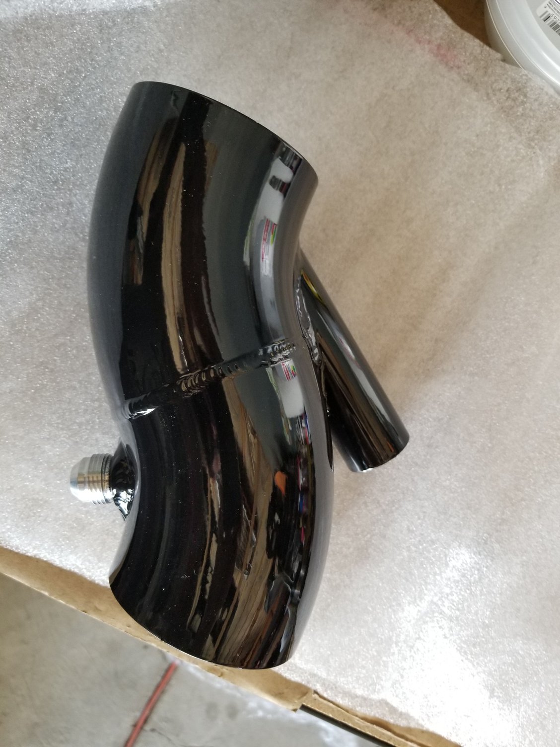

So I've also ordered an intake for sealed catch can but also to recirculate the BOV. I'm a little concerned that when the BOV opens its going to pressurize the catch can? I know their is a check valve on the intake line but would like to hear some thoughts on it.

I have a 255 and it does fine at 400 but I'm not sure I'd take it much further than 450. I've had a 320 sitting on a shelf for a couple months now. Probably going to drop it in during winter.
The pre turbo intake will always be under a vacuum since the compressor wheel is always spinning and pulling in air. No pressure will make its way to the can. Especially since the only time the BPV will open is during significant boost and that's also the same time suction on the intake will be greatest.

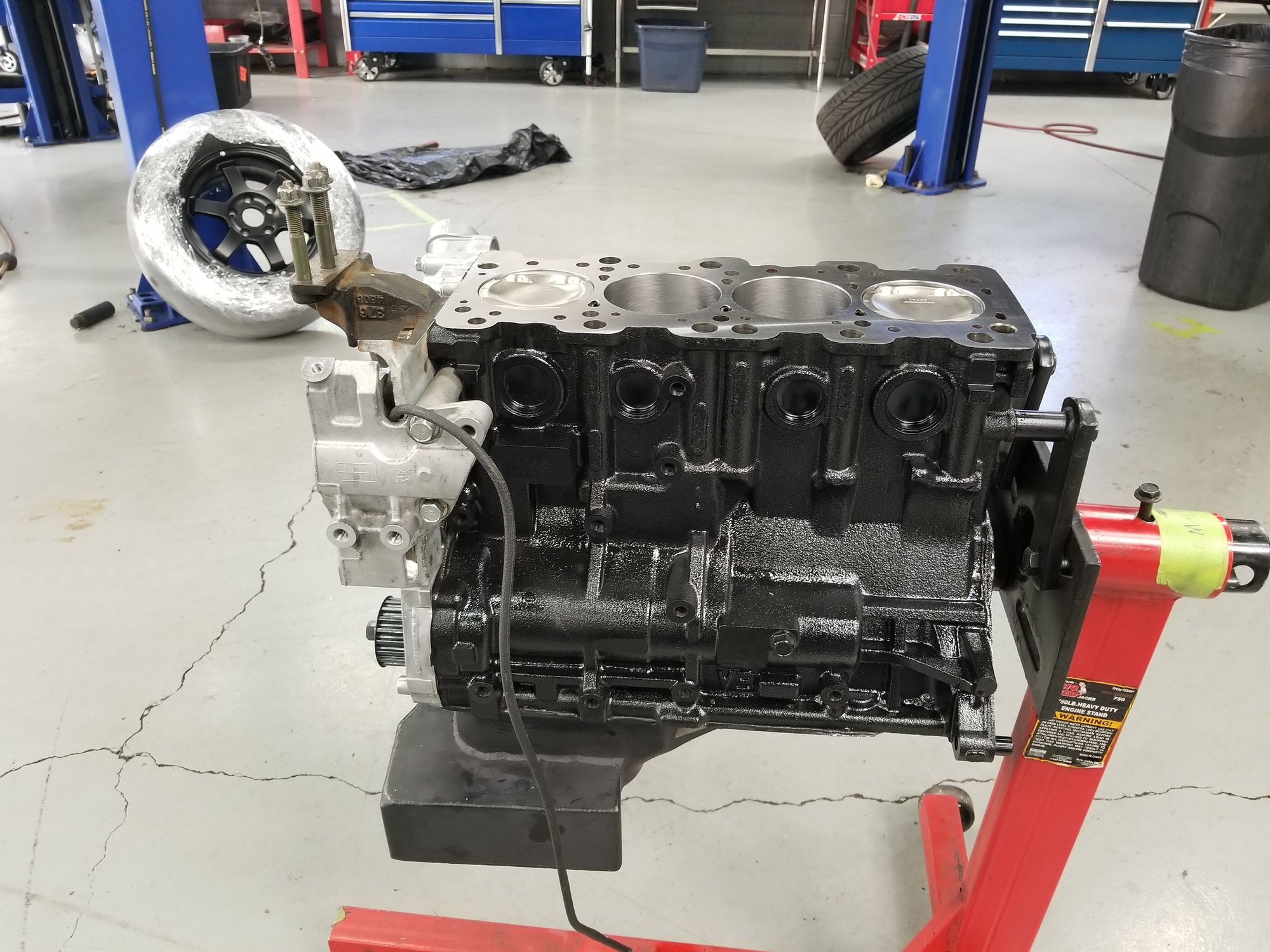

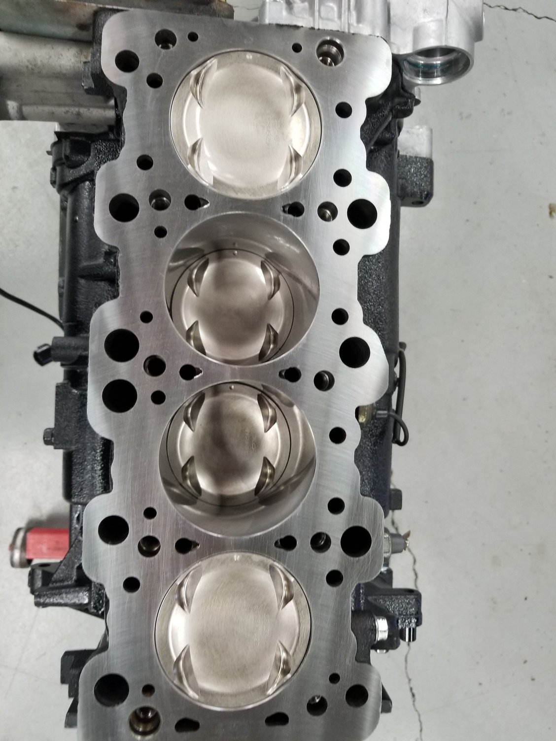

I believe this is my block! Liking the oiling mods Devin did. Cant wait to see it in person.

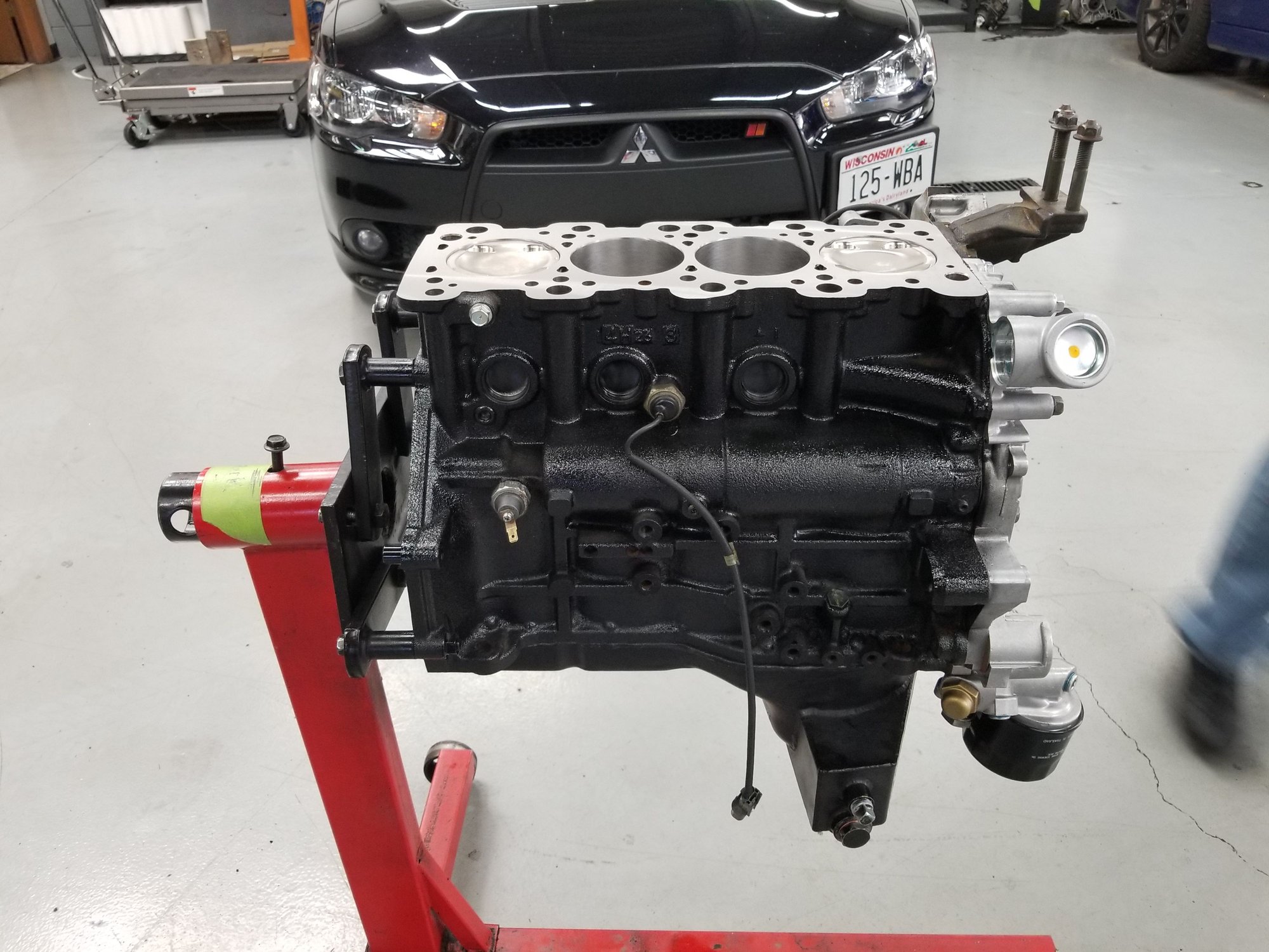

Took a drive to Boostin so I could see the status myself. Shortblock assembled. Lookin good!

Looking good! Is that the original paint on the block?

No they painted over it. But it wasnt too bad even before I dropped it off.
As ayoustin said there's no concerns there as A) the intake isn't sealed so it can't make pressure and B) it's always under vacuum. I also have a "custom" STM 3" intake with recirc port & -10 AN sealed catch can fitting that is working without issue so far on my MAF setup.

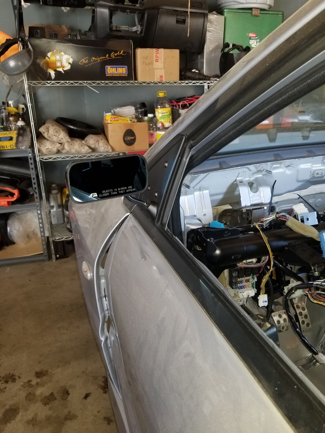

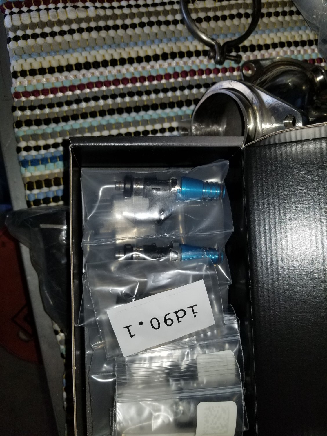

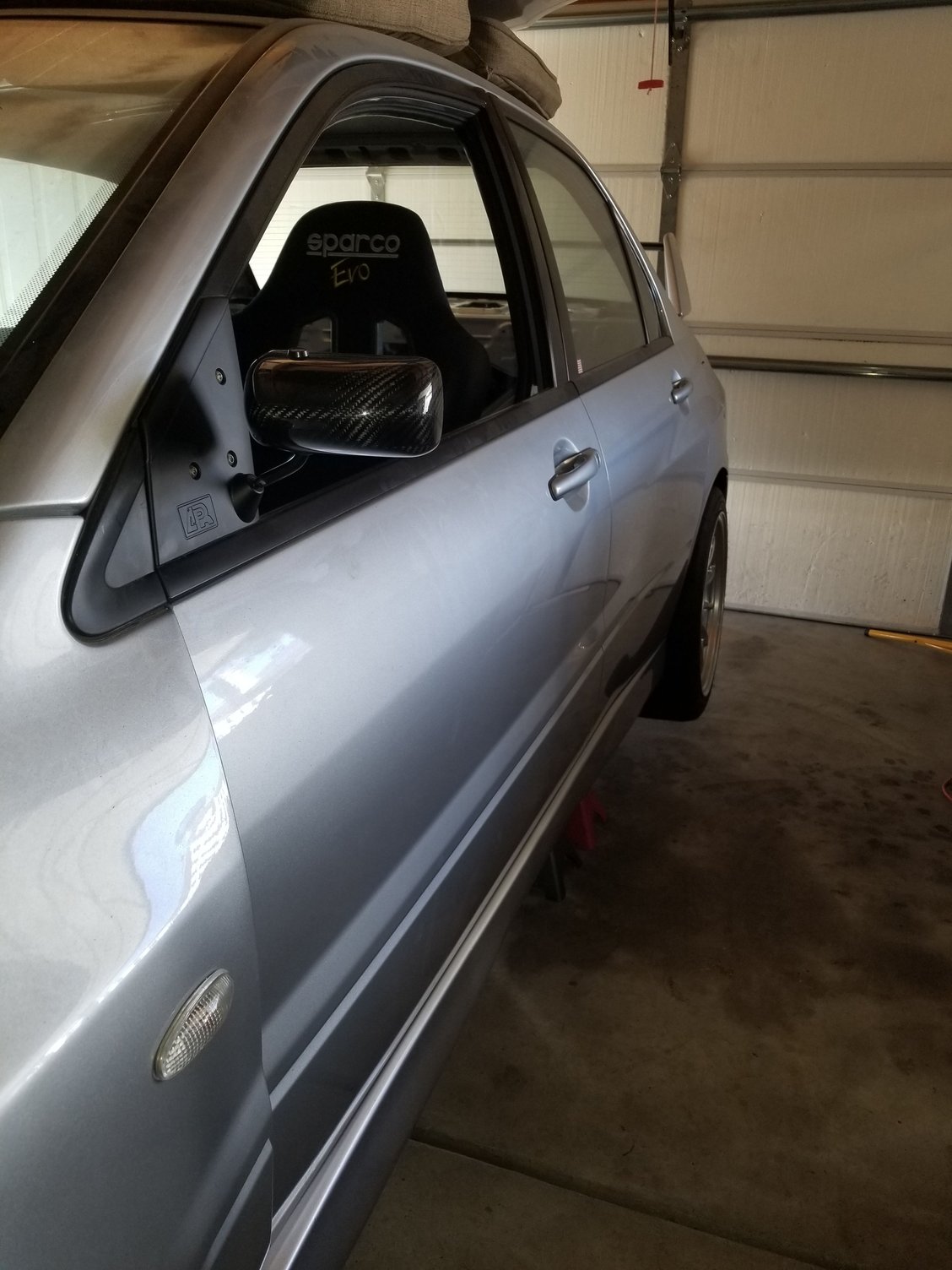

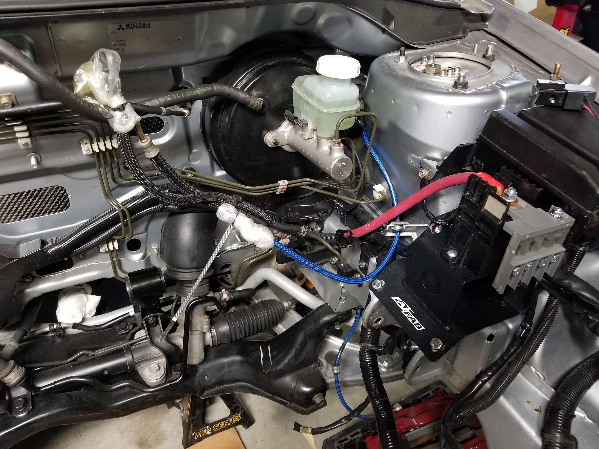

Getting some parts in and did a few small projects. Buttoned up some wiring and installed APR Mirrors. I'd not have bothered if I had or could find OE RS mirrors... What should have been a straight forward install ended up being slightly more involved. The instructions were a bit confusing. Had to run a 5x.8 tap down the mirror base since threads were not pretty out of the box and I striped a bolt head trying to get one in. After chasing the threads with the tap the install was easy. Also had to de-pin the connectors for power mirrors in order to separate the window/weather stripping from the OE mirror base. Too much work and money for 3lbs weight savings. I guess a little better aero/less drag...

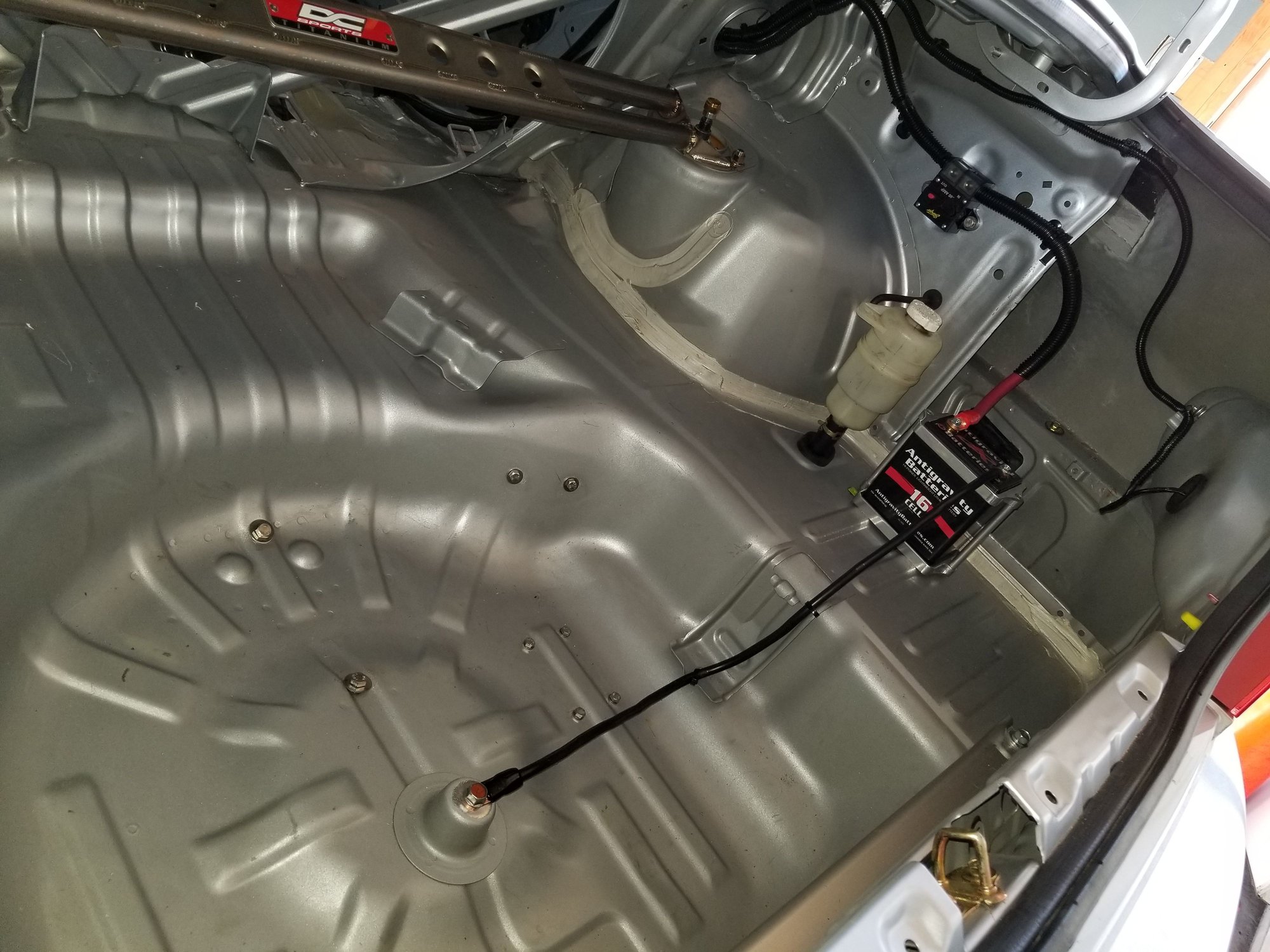

Finished the battery wiring and EvoX fusible link. Need to get a few nuts and bolts for the bracket still. Reran the battery wire on the passenger side because OCD told me thats where I should put the weight...

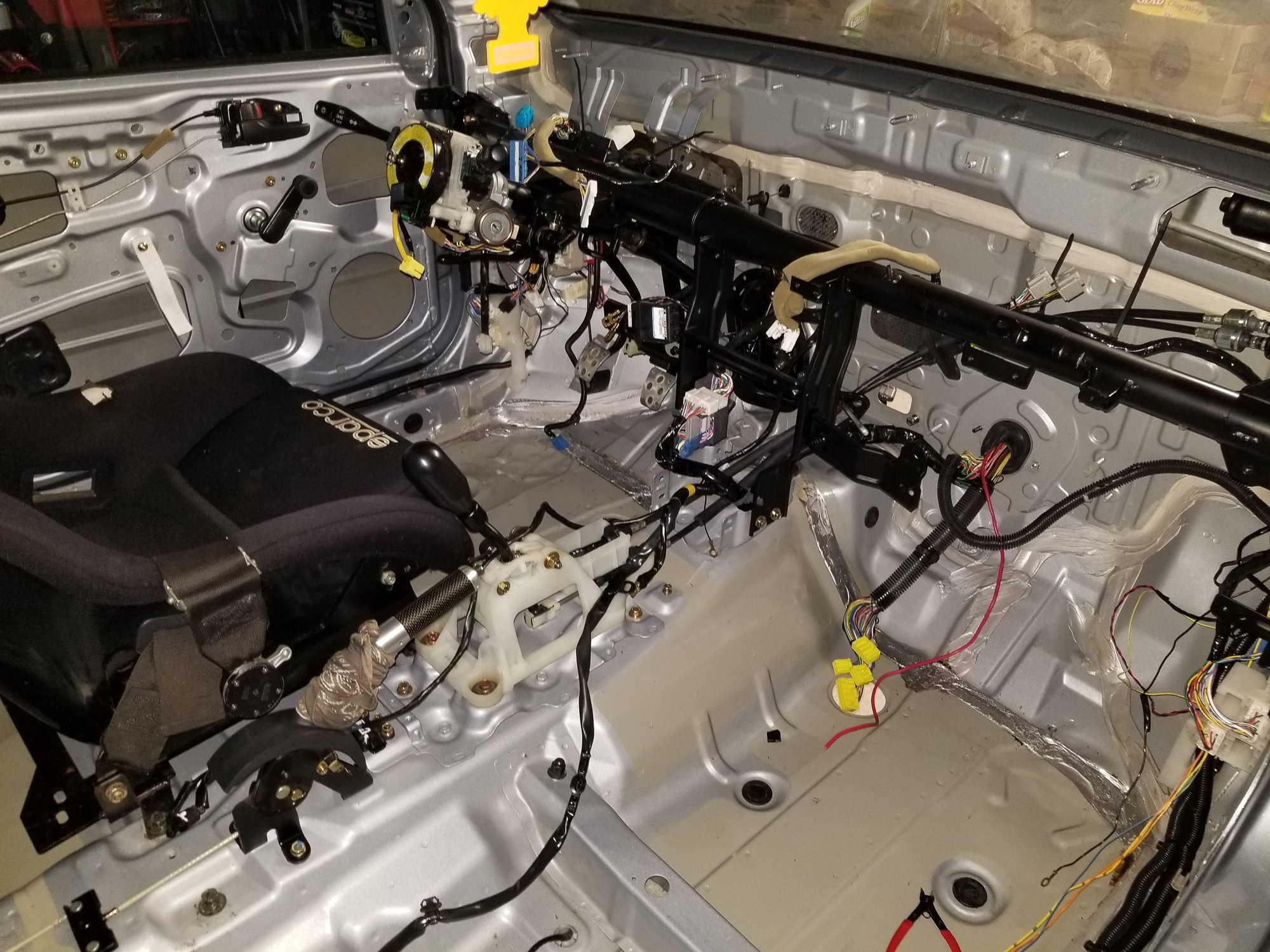

I also did some painting. Painted the column, and E-brake brackets and bare metal bits.
Also received my ID1300 which I'm excited about. They make a good product and these are specific to e85.

STM SD intake with AN bung for catch can and recirculate tube.

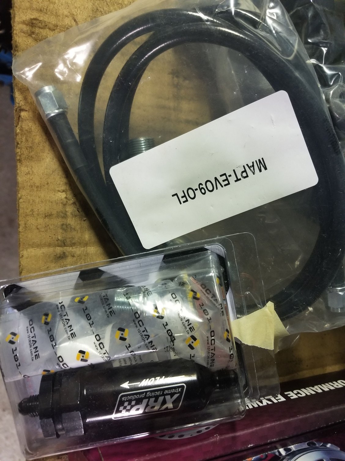

MAP filtered turbo oil line
