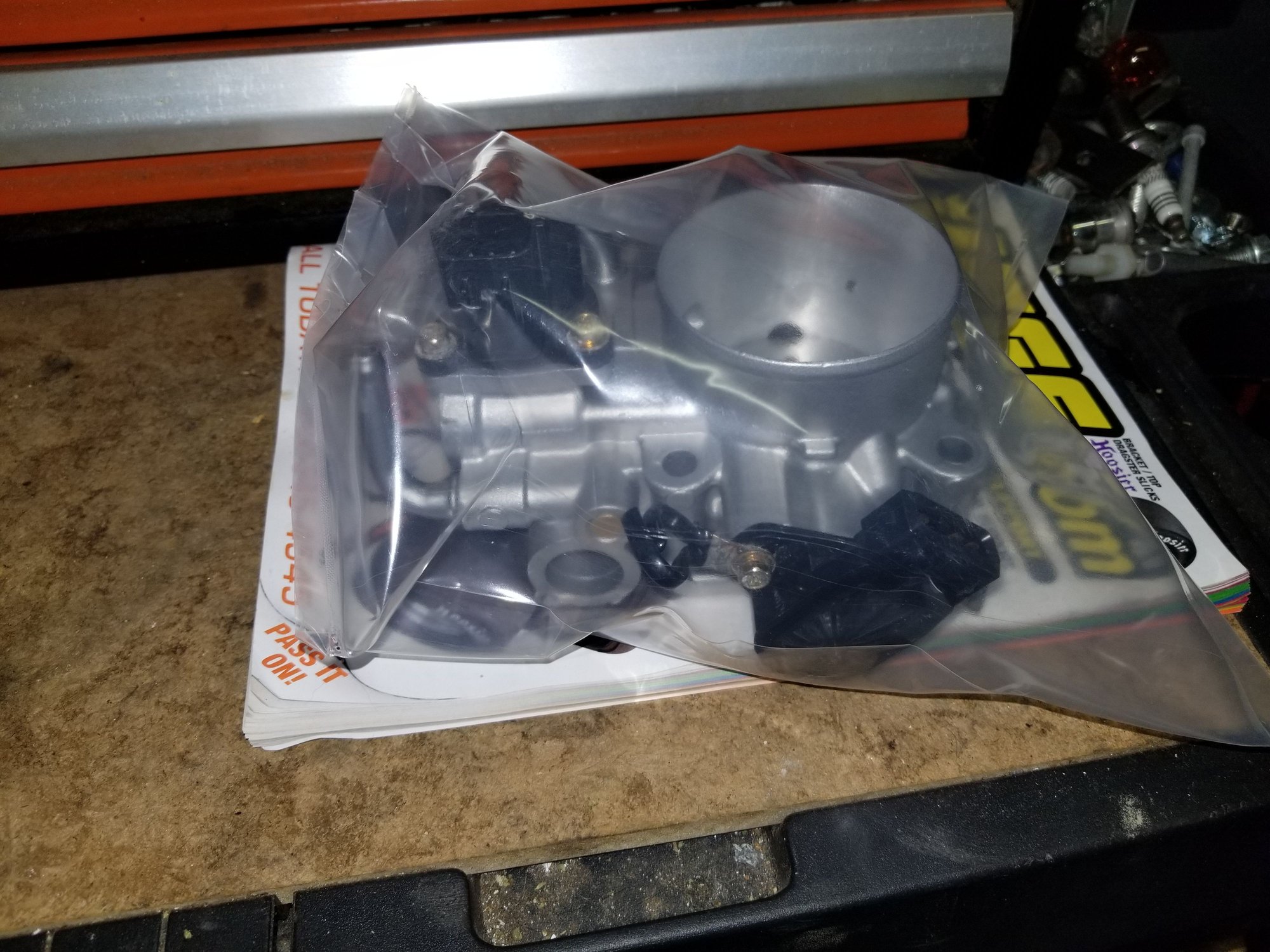

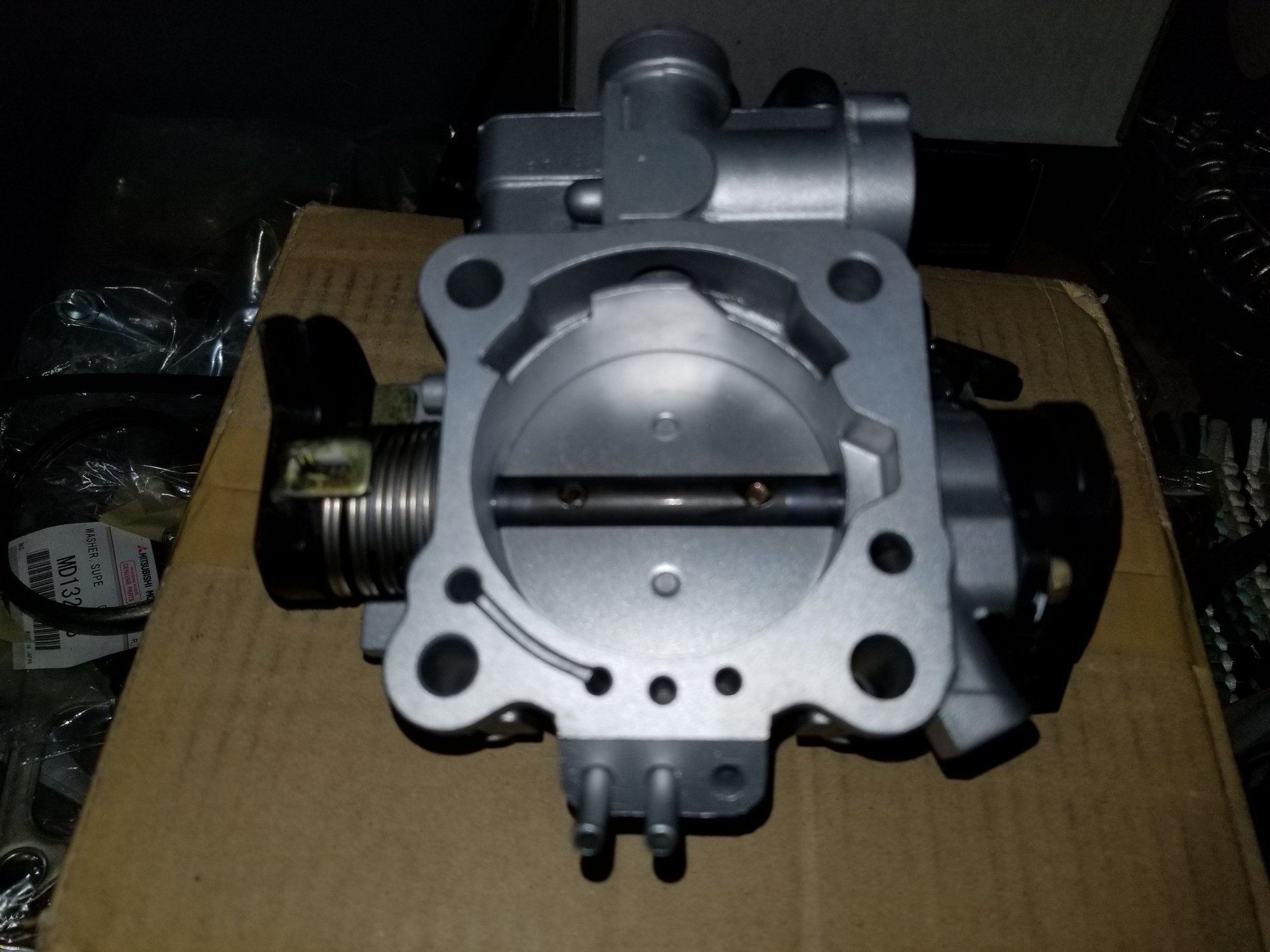

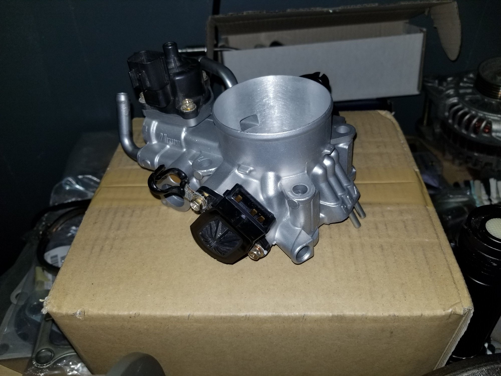

I dont want that much power, just quick response and to make power to redline. Plus the car is going to be light. Im really excited. Dropped off the hotside, manifold and O2 at Boostin for porting then off to Swaintech for their white-lightning coating.

Mean time I had my throttle body cleaned and sealed with milspec seals. Also want to do a GM IAT/MAT sensor for SD. I'm also thinking of a grimspeed 3port boost solenoid and to get away from my Greddy Profec Spec2 EBC.
