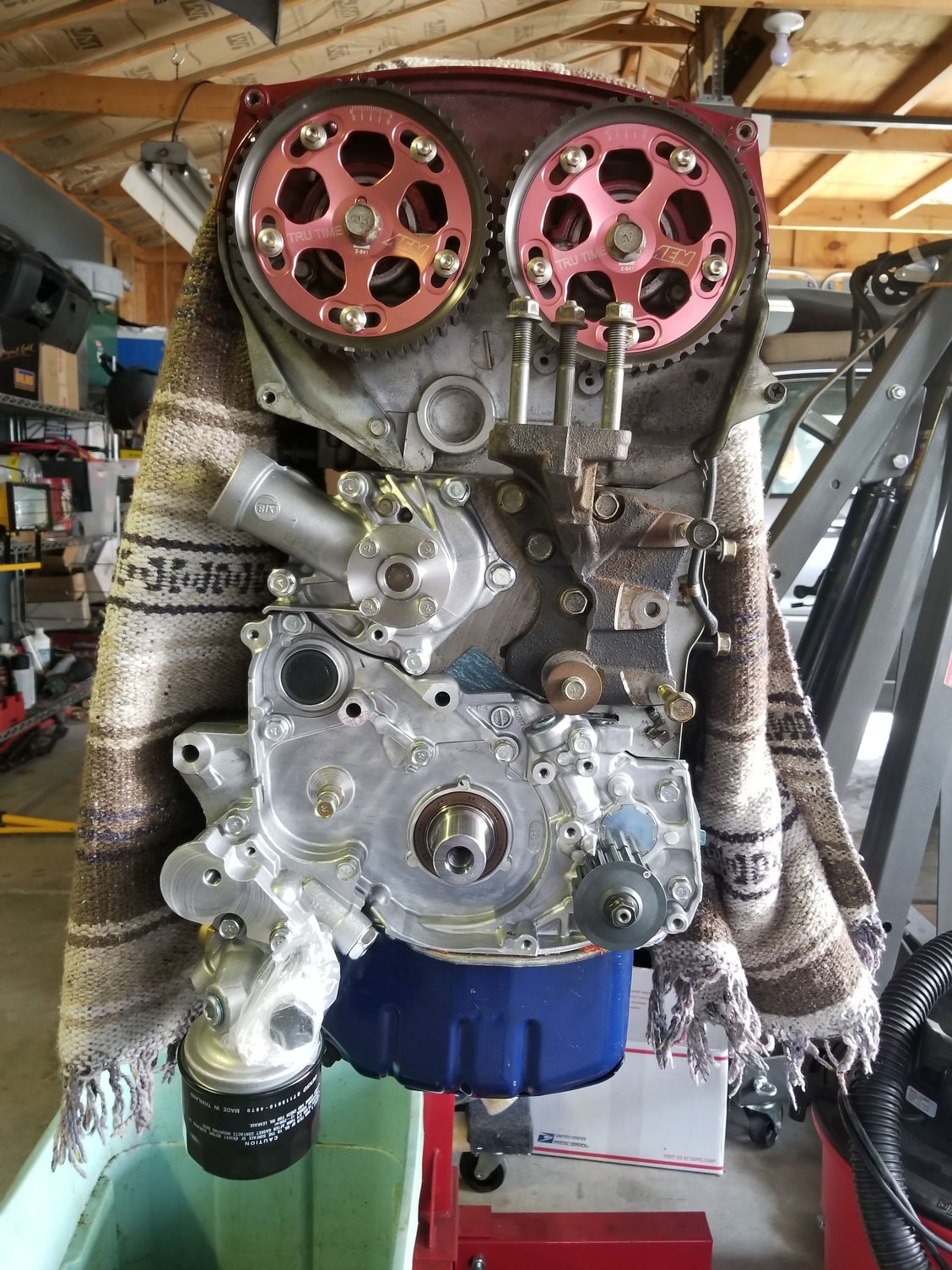

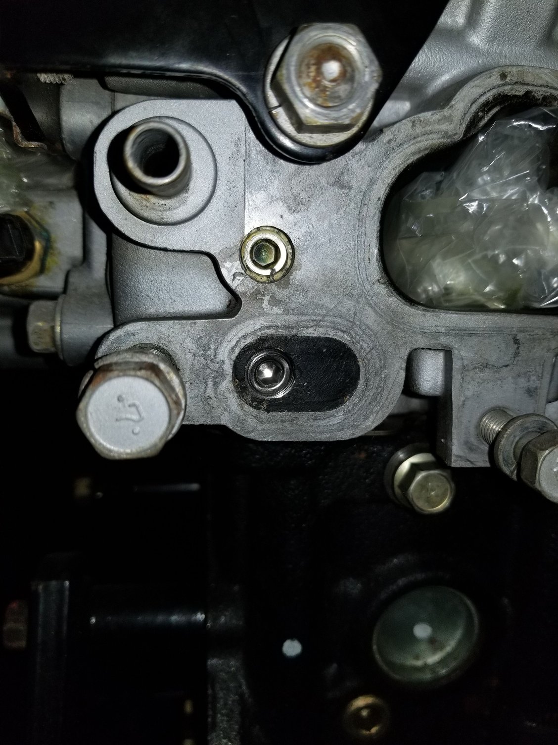

Smallish update but it took me a while to get done. Tapped egr port and installed plug. Put new front cover/oilpump and filter housing on. Did balance shaft delete but am using GSC race shaft. New water pump, timing belt, tensioner, idler pulleys etc. Sure hope I got tension correct on the belt... And hope there wont be any oil contamination.

Special shoutout to HondaGuy who was gracious enough to USPS me his bearing driver for the BS delete! Appreciate it very much.
For belt tension it should be pretty taught but not rock solid. I had a little under an inch of play in both directions between the cam gears when I set mine.

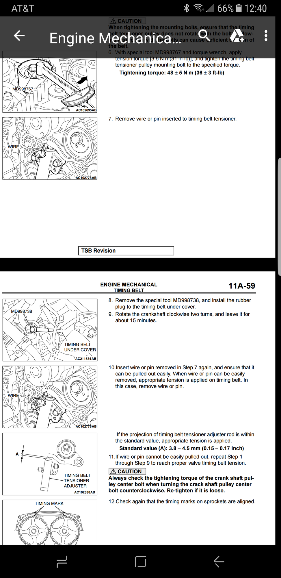

From the manual (how I understood it) pin should spin free after setting tension and timing. Then rotate motor twice without pin. Wait 15min and once tensioner bleeds away tension, in resting state should be able to put pin back. Rotating motor makes the auto-tensioner increase tension and inflates lifters.

I just turned the motor again and waited 15 mins. This is my reading on the tensioner. Maybe I need to add more tension. Manual says between 3.8 and 4.5. Hard to get a real accurate reading...
