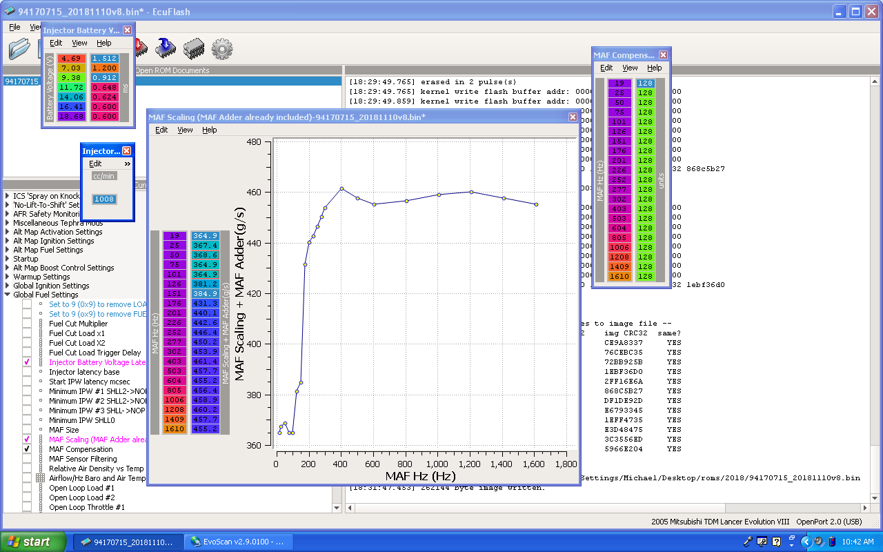

So I have been tuning the maf and It's really surprising to me how much better the car drives now, much better even then before with the HKS cams. It's like a different car in all the off boost areas (haven't moved up to that yet), night and day difference with just how smooth it is. I have to imagine this is the smoothness people talk about when going to SD. The throttle response and power is pretty much better everywhere. I don't know if this is a common technique, but I only came across it in a mrfred post about tuning his FIC2150 injectors here
https://www.evolutionm.net/forums/ec...ing-notes.html
This passage specifically is the gold.
"As with my FIC1100s, getting best drivability also required tweaking the MAF scaling table. For people running MAF, this table is useful for dialing in closed loop trims, and it's what's needed to make the AFR table match actual AFR in open loop. The name given to this table by someone many years ago suggests that it affects the load calculation, but in fact, it only affects the fuel calculation, so its a very useful tool for tuning AFR. Most people running FIC2150s are running SD, so I'm not sure how useful it would be to tune the MAF scaling table because it provides a similar function to the SD VE tables."
So big thank you to mrfred
I took mrfred's lead and flattened the comp table to make doing small adjustments to the scaling table more straightforward. You can create an excel formula to calculate the (maf scaling*comp) values to change the scaling table to before you flatten out the comp table to make it easy.
Here is where I am at now, logged trims are < +- 1% everywhere up to 250 hertz. I think for everything higher I will need to rely on the wideband readings to dial in the maf instead of the trims.
