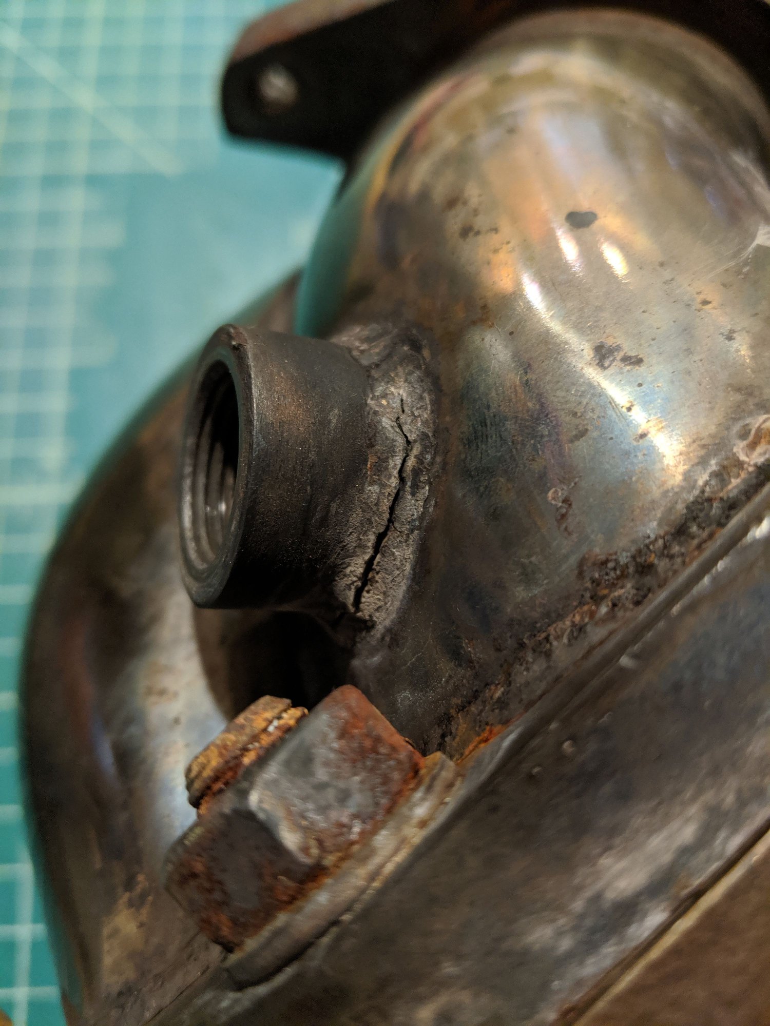

I did some grinding in the 02 housing some time ago, and apparently grinding away on the 02 bung is a bad idea. So this is something I will have to replace while I have the turbo off.

Just have it cleaned up and re-welded.

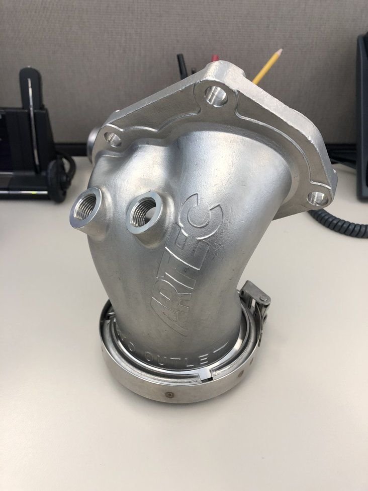

You know what doesn't crack? Cast O2 housings
Don't quote me on the axial play spec. But .005" doesn't seem excessive to me.
I'm going to see how cheap I can get another vs what a local welder will charge me. Some day I plan on getting a welder, so if I don't fix it now I'll have something to play with later.

Damn that is nice. A 3.5 inch exhaust system is probably a little overkill for my use case though lol. I do like the vband, unfortunately the cast in logo really kills the stealth factor.
After reading their little blurb about exhaust sizing I'm def interested. I'll keep it in mind when it comes time to upgrade the exhaust system.

-The no name (ebay?) 02 housing was cracked and replaced with a Megan 02 housing. A friend gave me the original one back in ~2009 and never mentioned where it was from. It was fine until I tried to port it, and a couple years later it cracked.
