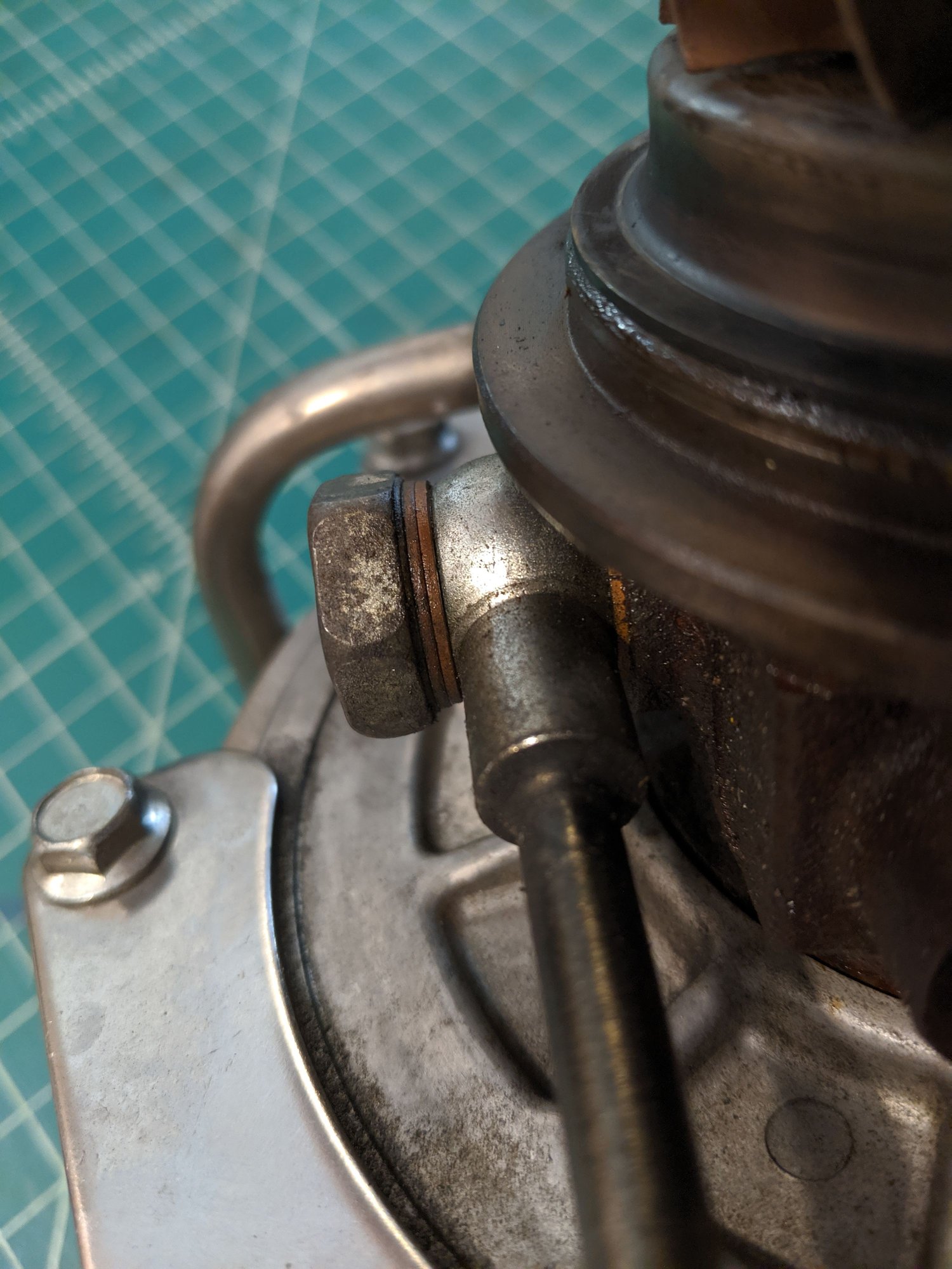

I just pulled the turbine housing back off and measured shaft play. My methods were not what I would call super accurate but I'm pretty confident I have ~ 5 thousandths of shaft thrust play.

Wow! I just noticed this f*** up too. The nice part about doing all your own work is you know exactly who to blame
D'OH!!!!
I think that's right about spec.
