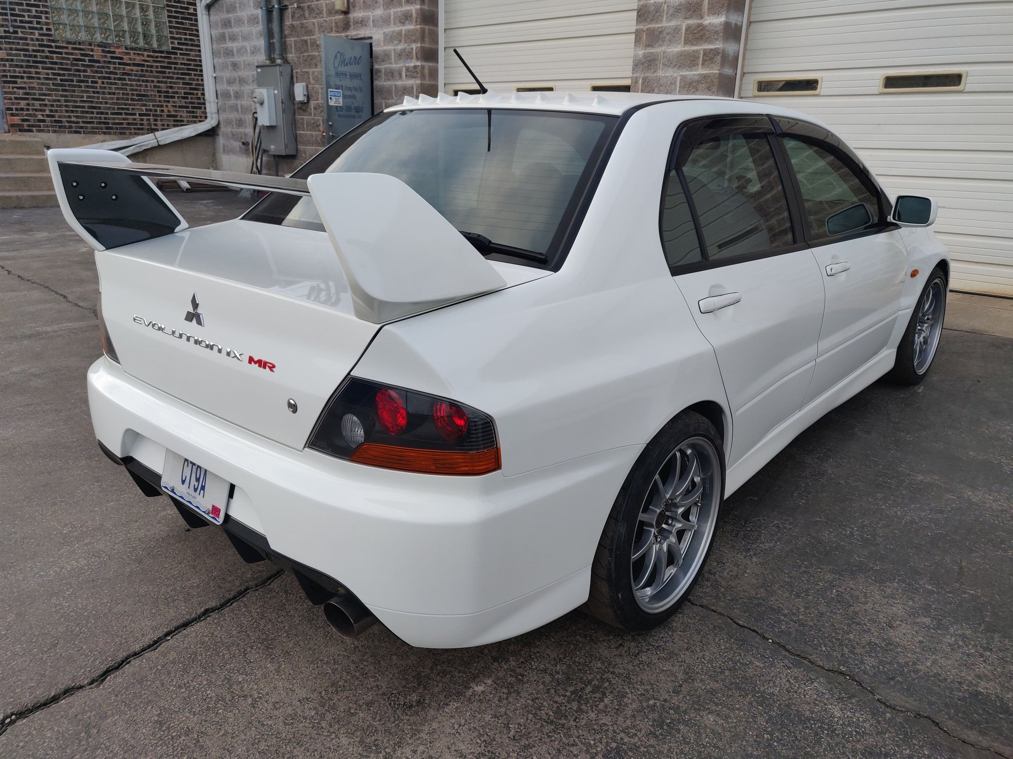

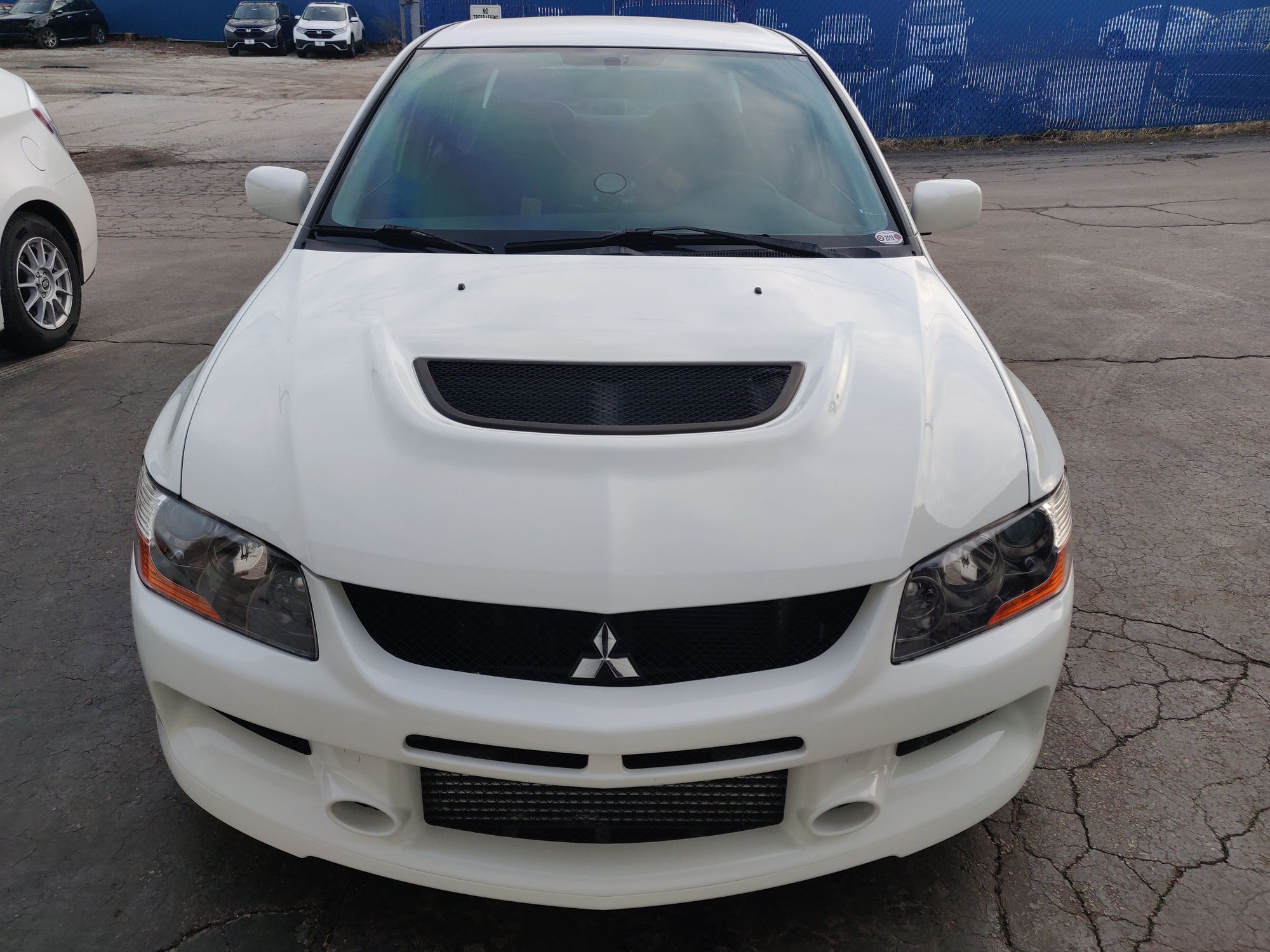

got the car with me, it looks really nice. only spot the paint looks different is on the rear bumper which i told them not to do. everything lines up well, gaps look appropriate and paint quality looks good. I'll probably detail the car next month and see more closely but honestly I'm just glad everything lines up

Looks like nothing ever happened! Glad to see it back together again. I'm sure you are thrilled to have it back.

yea, extremely relieved. i looked over the car closely, there's some orange peel in the paint sure, but it's not bad, not something i've ever cared about.
the only thing that is persisting is a popping noise from the right somewhere when i go full lock at low speeds. axle? checked the boots, not torn. i'll check the shop if they noticed anything, but not sure what it might otherwise be, any ideas?
