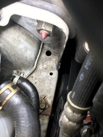

FWIW - the shop started making some preliminary measurements - front end is, of course, definitely tweaked. shop confirmed that the frame rails have sway, and the RH rail buckled a little... They don't seem to think it is a big deal though, and are going to start pulling next week. They prefer me to grab an OEM crash beam for them to use, so I'm on the hunt for one now.

the buckling of the RH rail:

That's really minor. Yank it straight and send it.

I had to really look to even see it. lol

thankfully minor, i really got lucky here.
it's just where that seam opens up, correct?
still searching for an oem crash beam to use to straigthen the frame, but if it ends up being like 150 bucks i might as well just tell him to go for it with the stm beam
