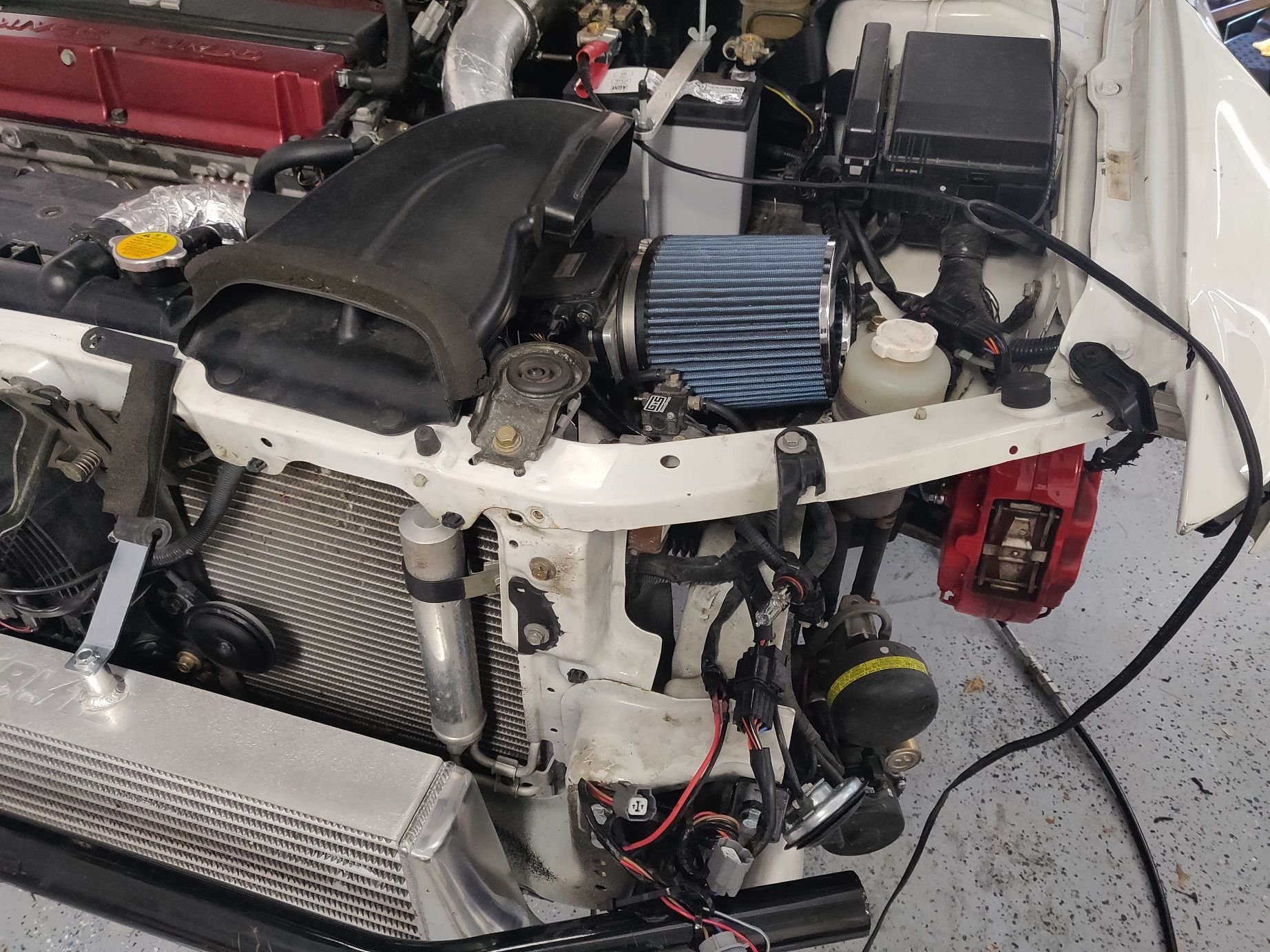

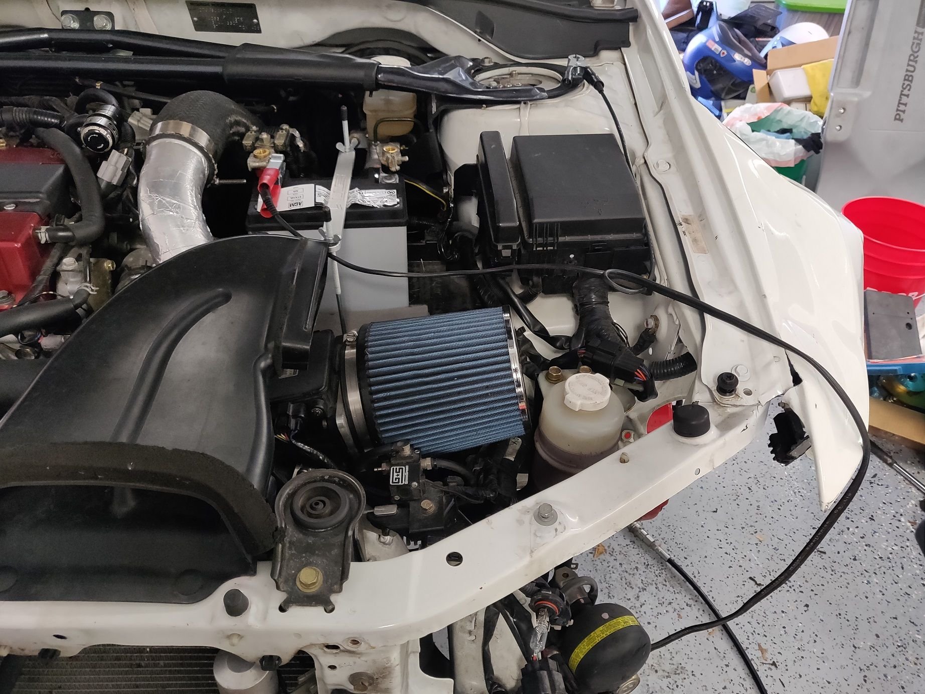

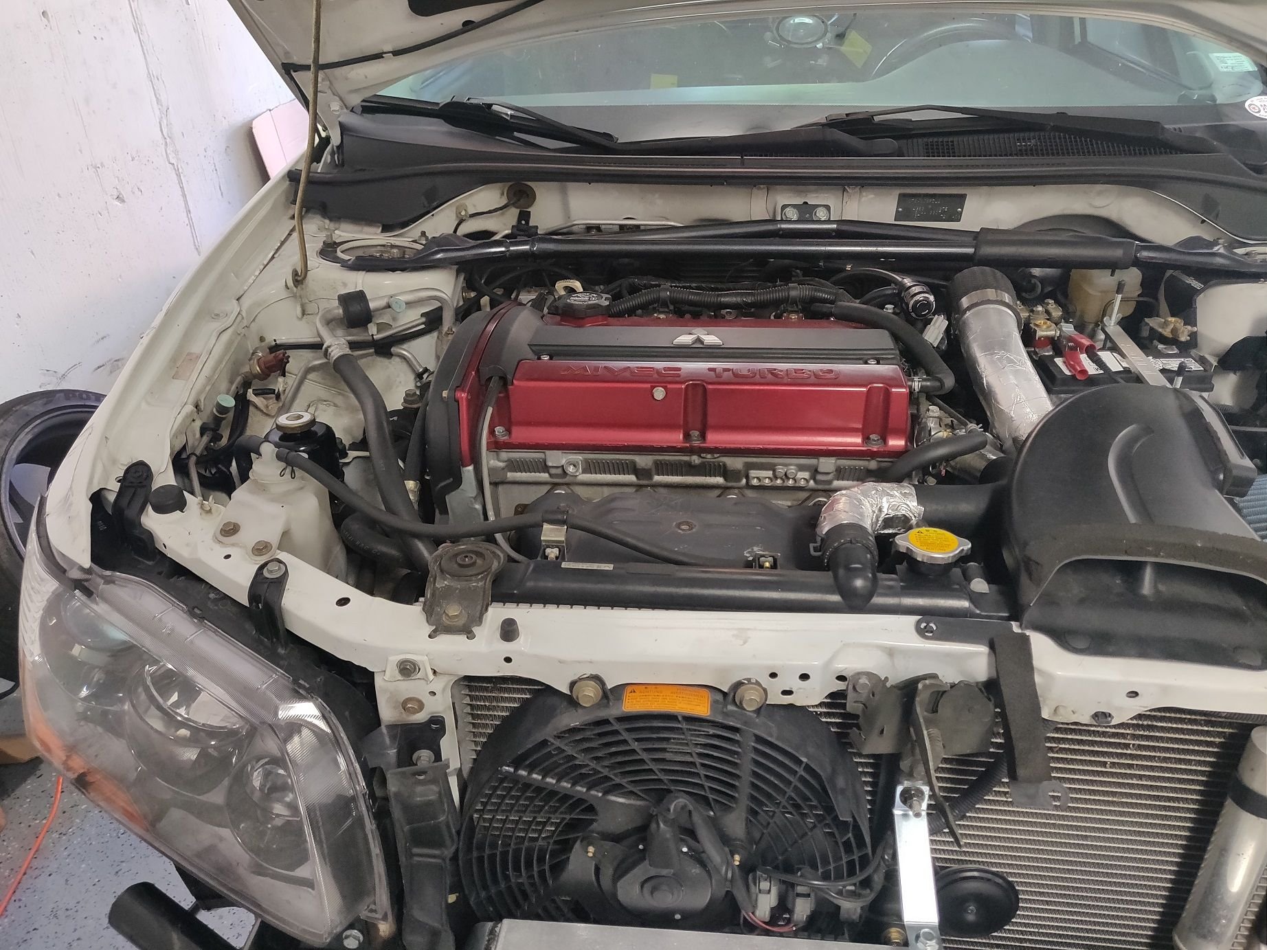

got the hood open - the latch is acting finicky but as you guys suggested I pushed down on the hood and pulled the latch to the side and was able to get it. Putting it back is a different question.
More pics below - thoughts?

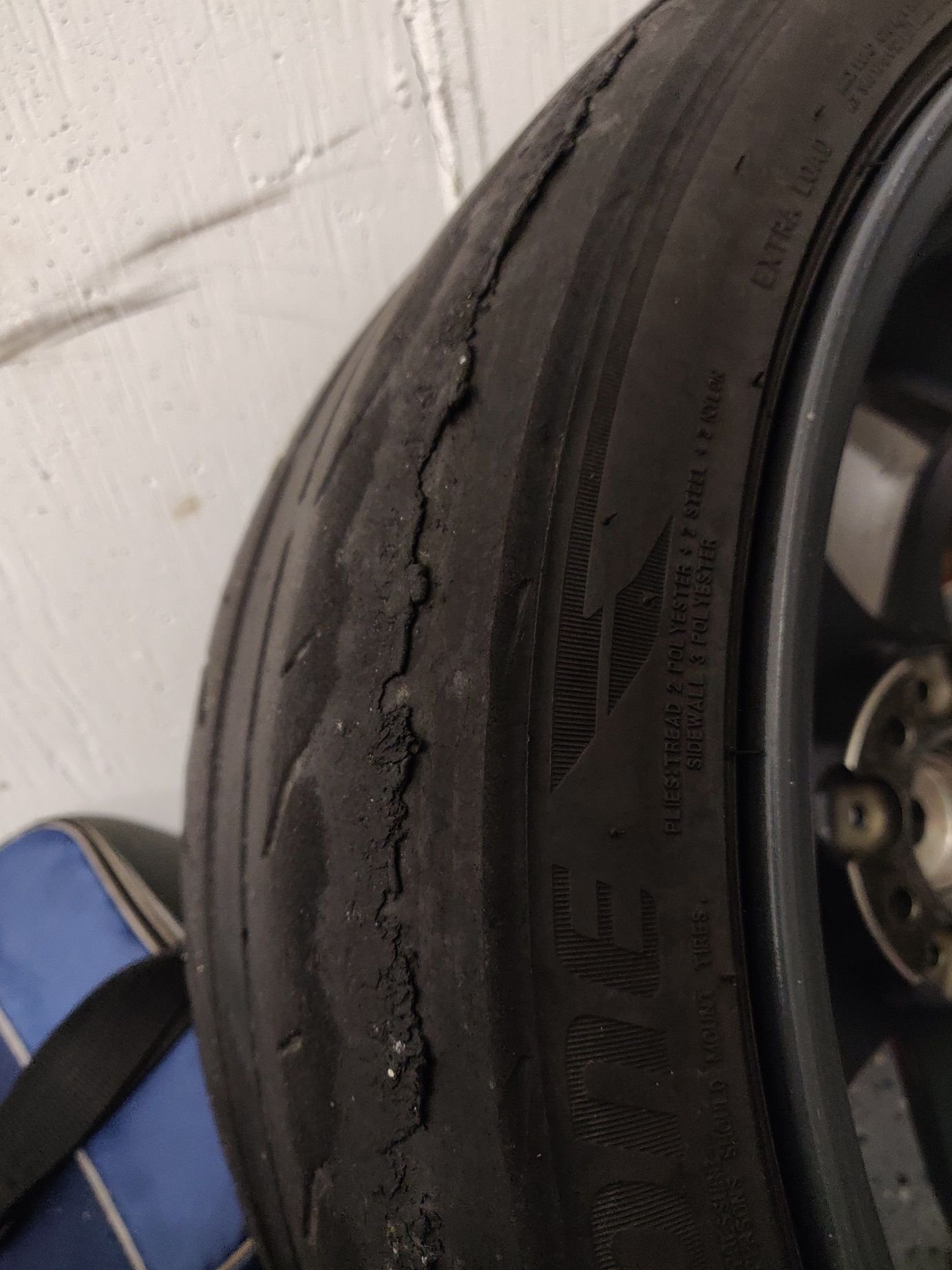

some tire delamination from the passenger's rear (the side the let go in the counter clockwise spin)

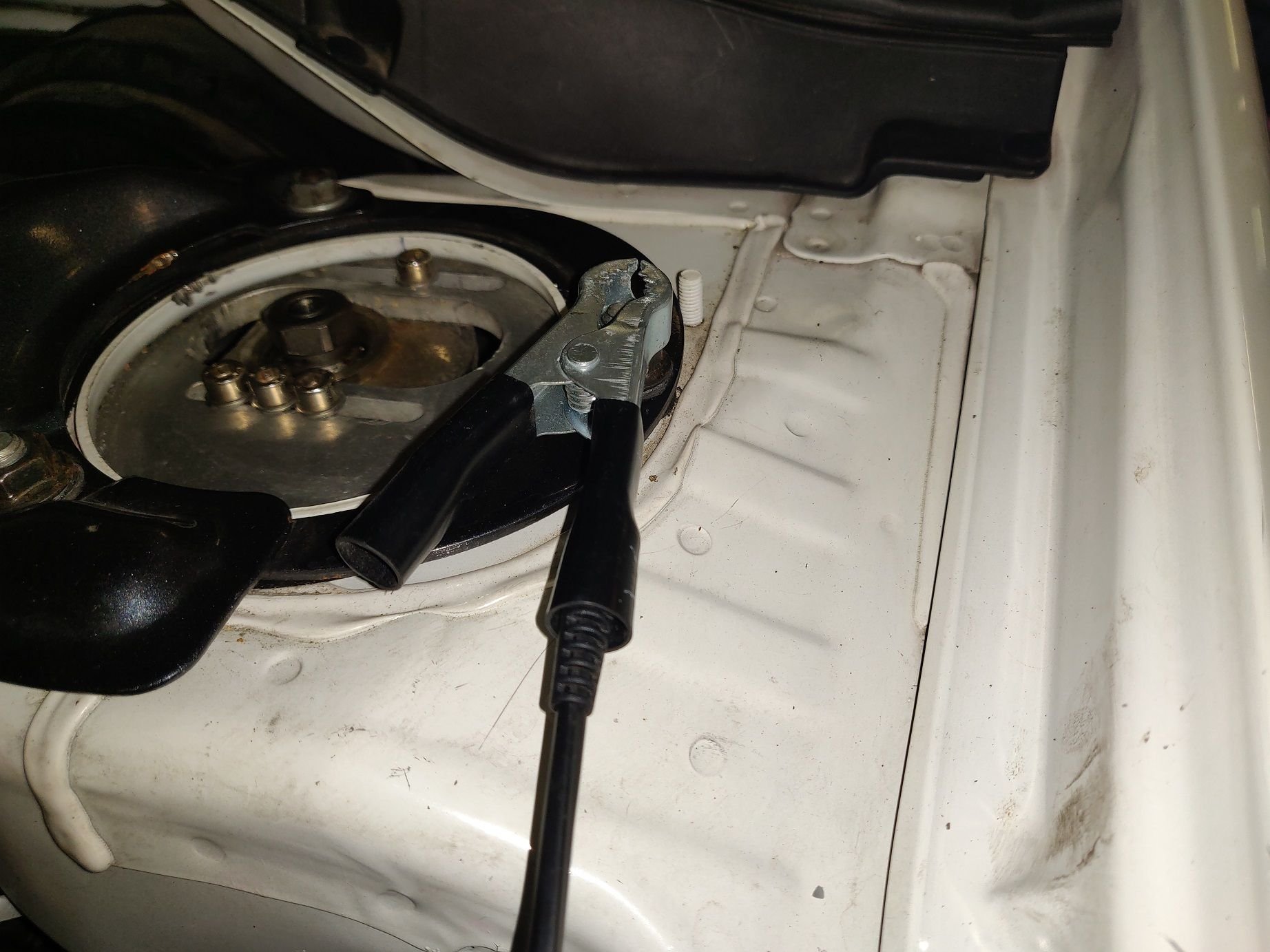

the strut tower areas always have this bend in them?

Strut towers do have that bend normally. It looks like you're actually semi lucky. Damage does not look that extensive. I would suggest doing the measurements someone else posted before and see how far off it is.

Looks like the body panels took most of the damage. I would say you got very lucky. Like previously said. Take the measurements, you might be able to get the quote lowered.

You might even be able to straighten out the radiator support with a couple good yanks.if it’s even bent can’t really tell. Also from the pictures none of the seam sealer is lifted or cracked which would be a bad sign

That tire isn't delmanated. It just has severe toe wear and it picked up a ton of tire goo from the track.
As others have said already, it looks like you dodged a bullet. Everything body/frame related looks fine from those photos at least.

it definitely looks like OPR, especially in pics, but it kind of lifts off. I've had a lot of experience with OPR, this def looks like delamination. None of the other tires have this much OPR.

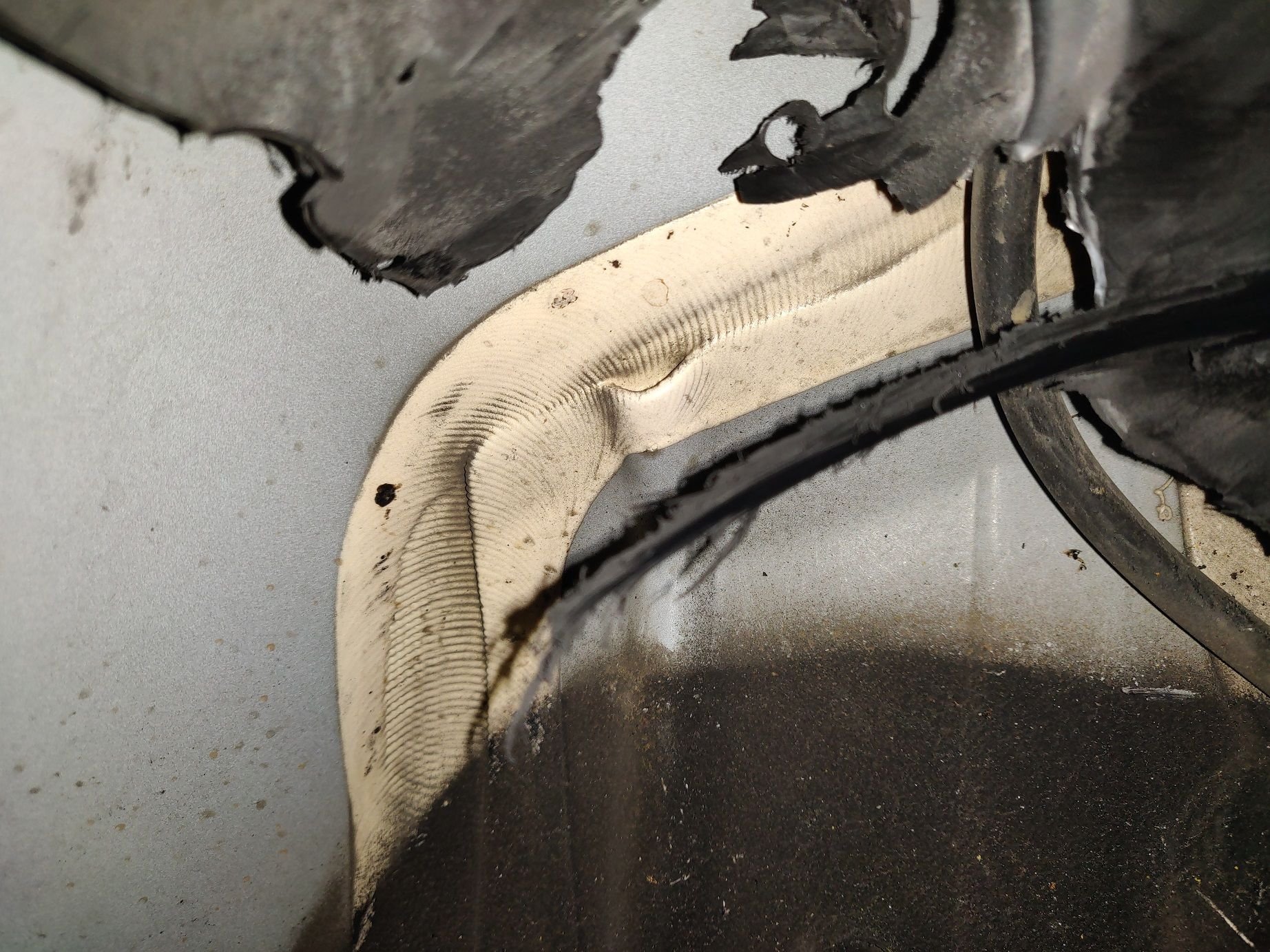

**more importantly - i DO have a broken seam - this is the driver's side tire fender wall. makes sense, this is the side that took the brunt of the force. thoughts on this? a sure sign that something is off/compressed i assume.

Originally Posted by evo420
what do you mean? normal for a crash, or that's how it looks oem?

That's how it looks from factory.
