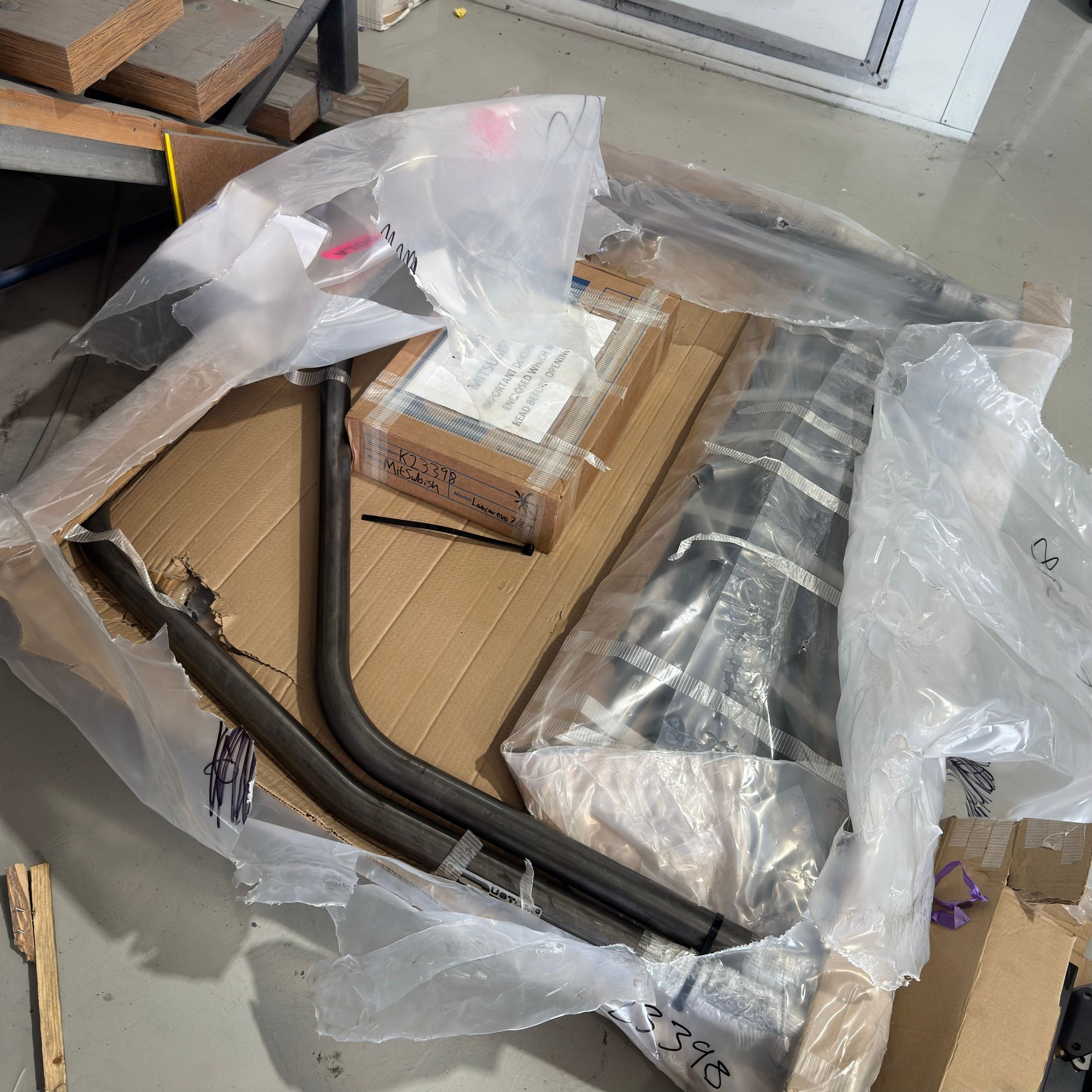

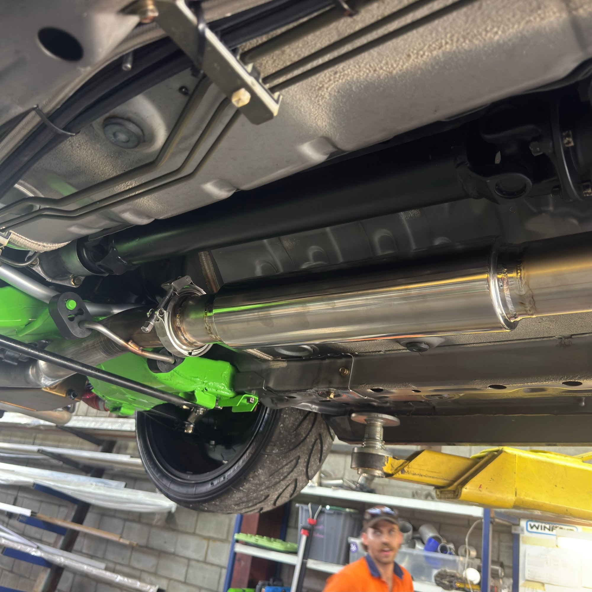

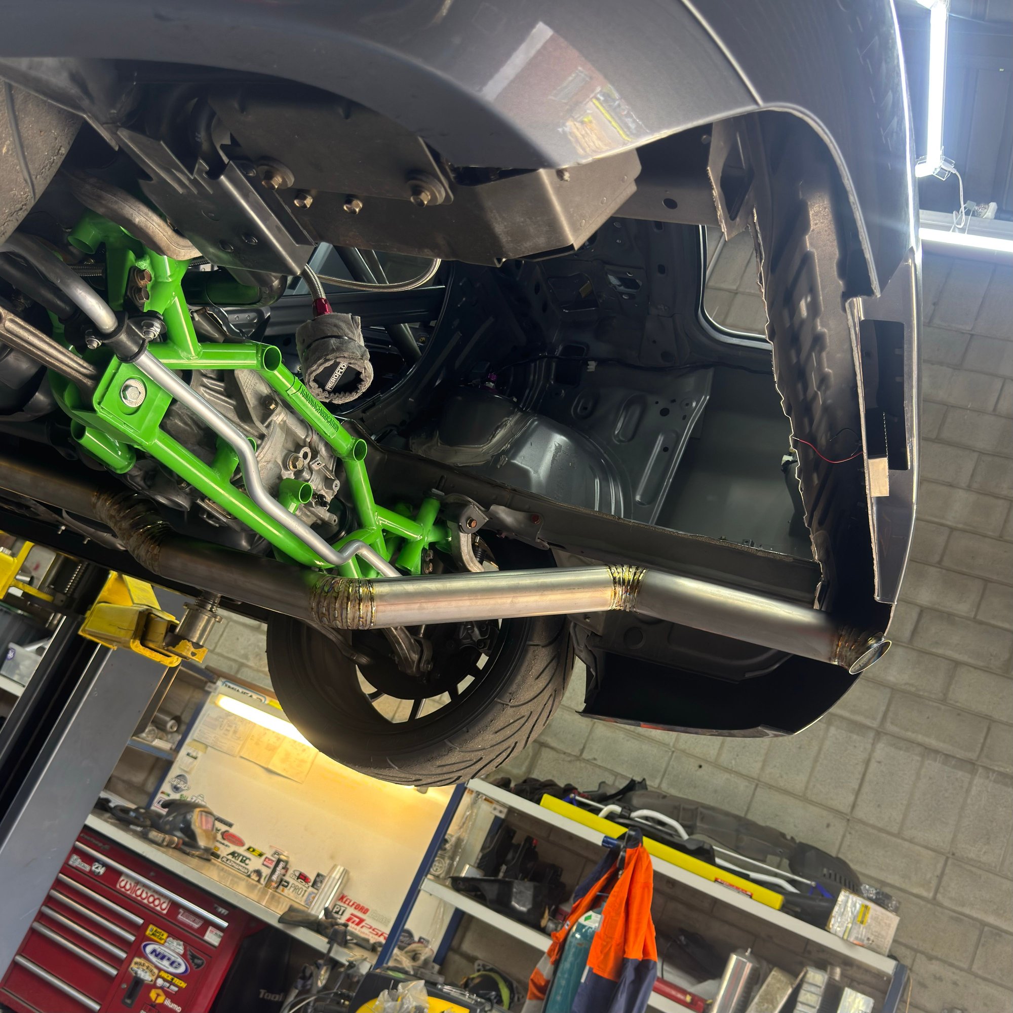

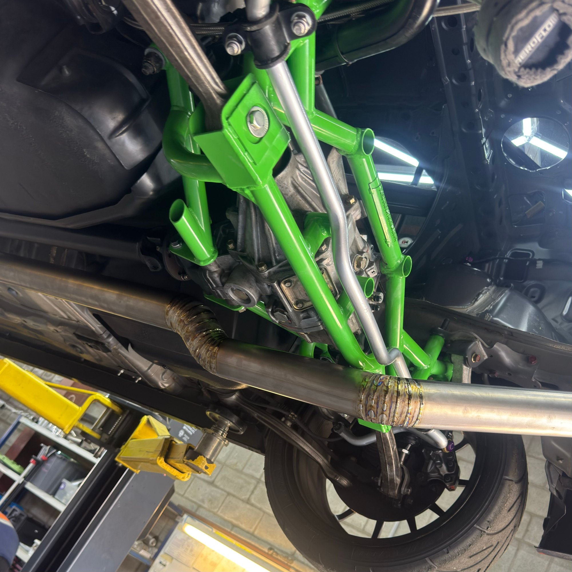

Few more bits done, I cut the rear wheel well out and also got my new exhaust system made. It’s a 3” one piece with v band that connects to the downpipe the whole system weighs 12kg which is super light.

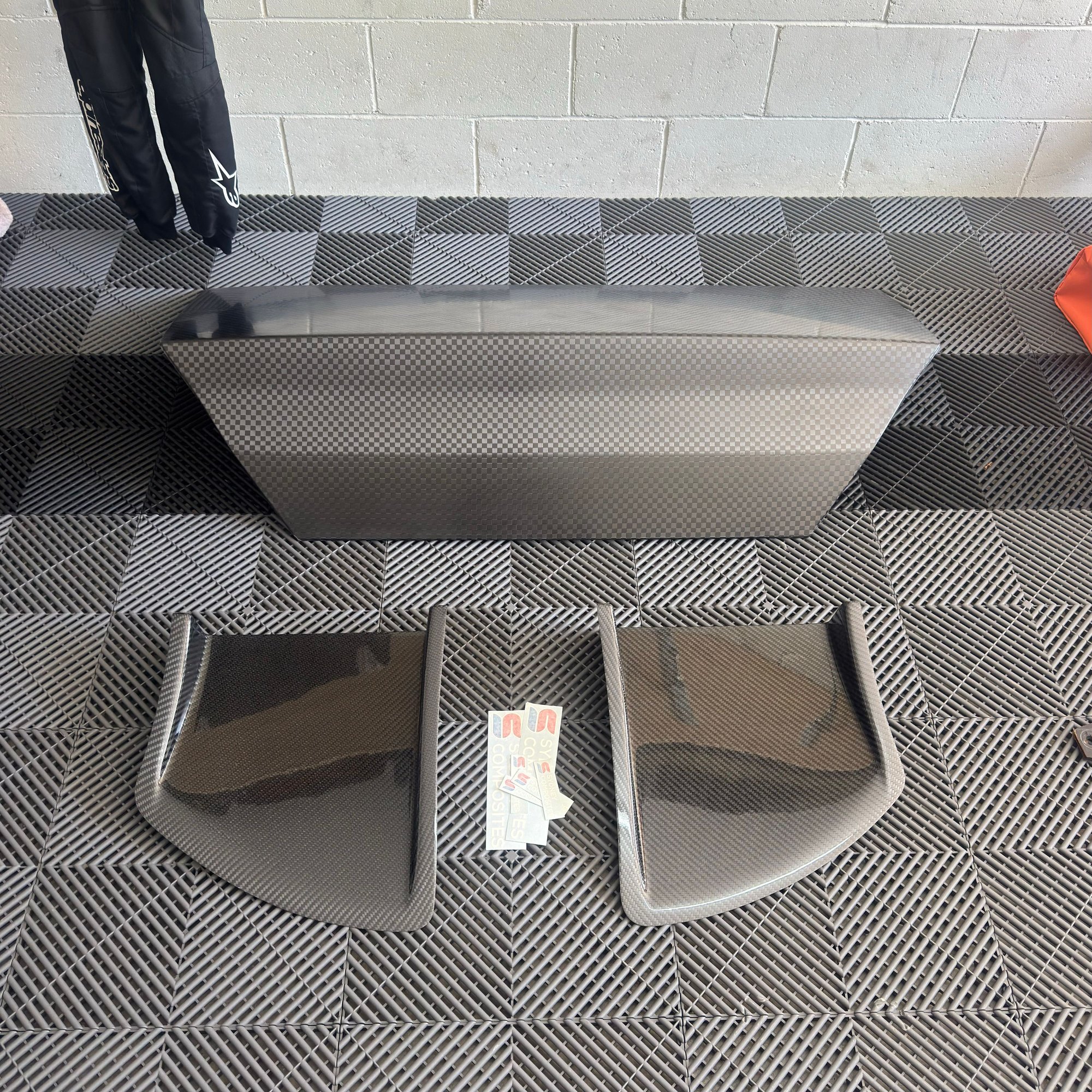

Some more carbon turned up, new boot lid and some tunnels for my new splitter I’m making.

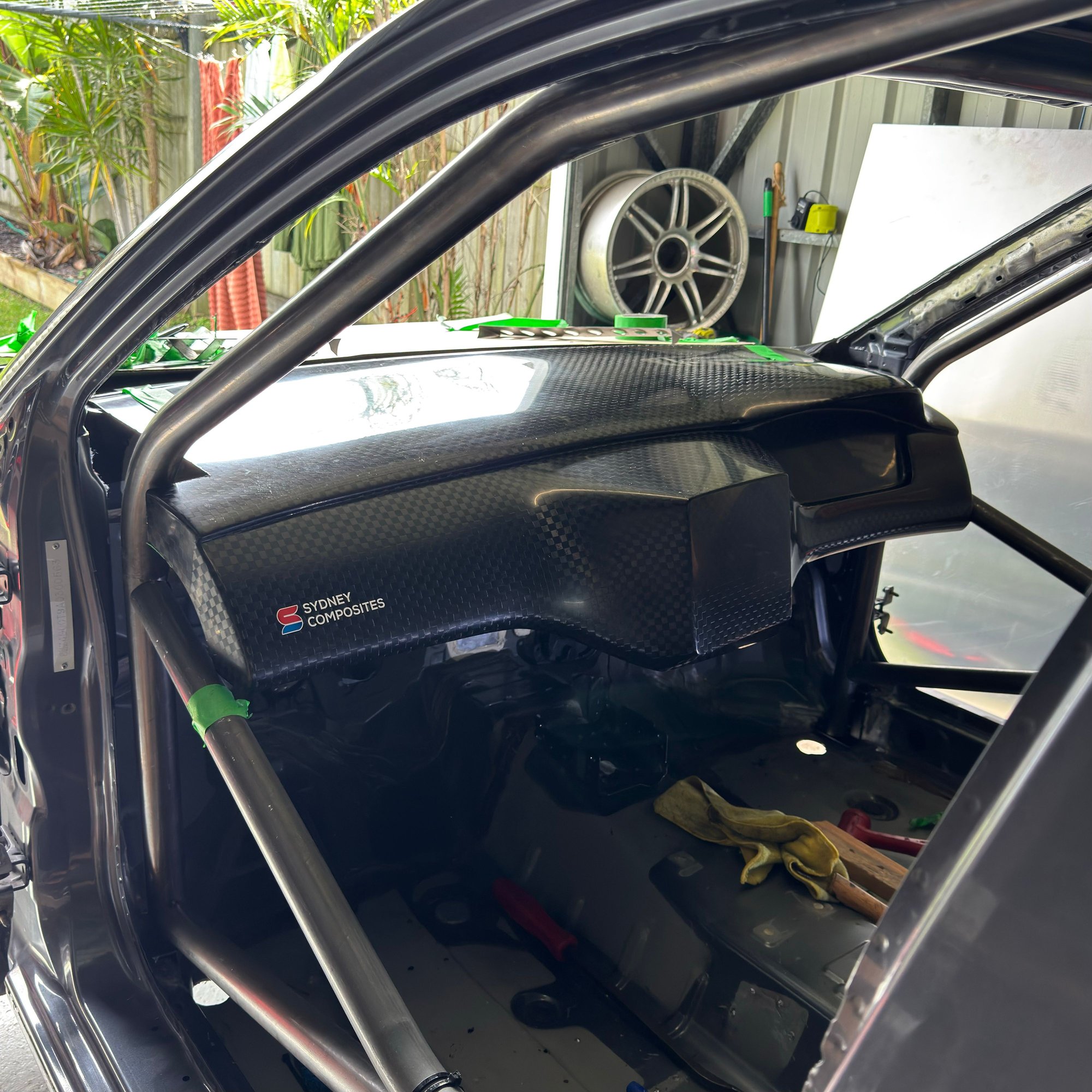

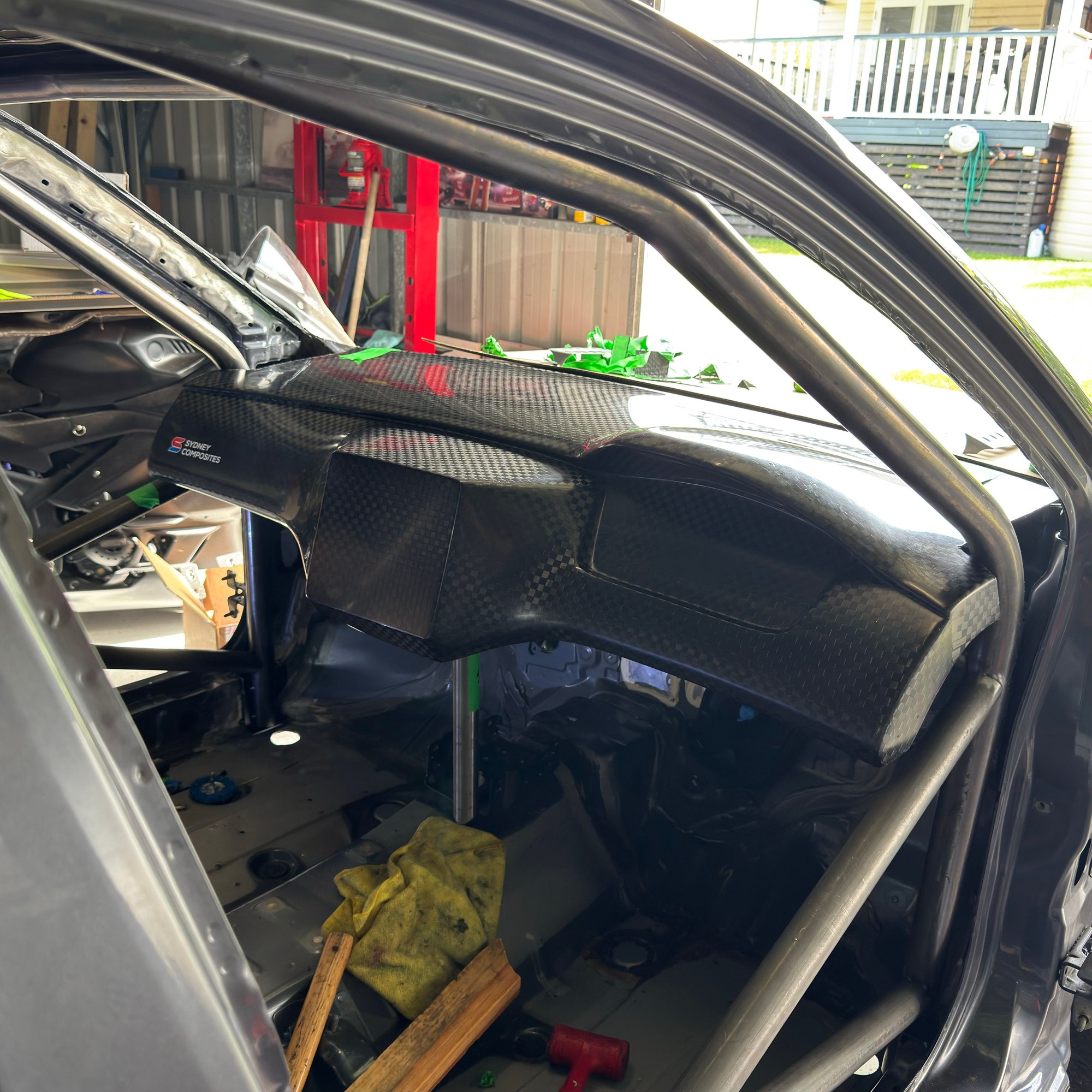

A few more parts turned up:

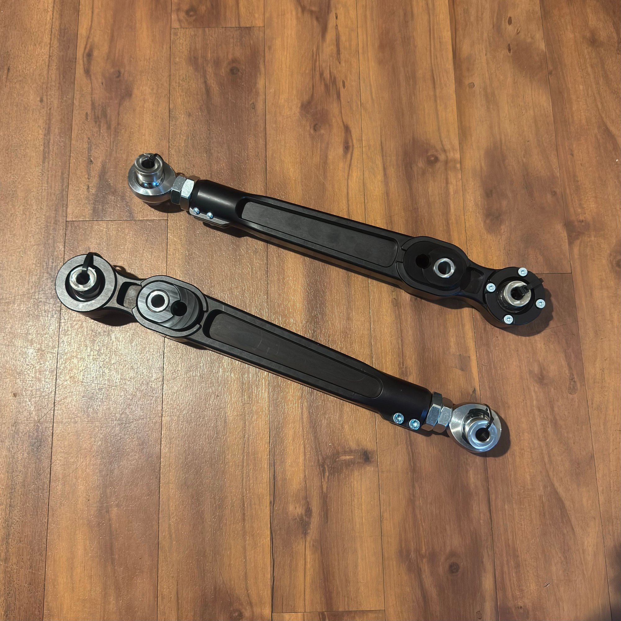

SSB Rear Control Arms

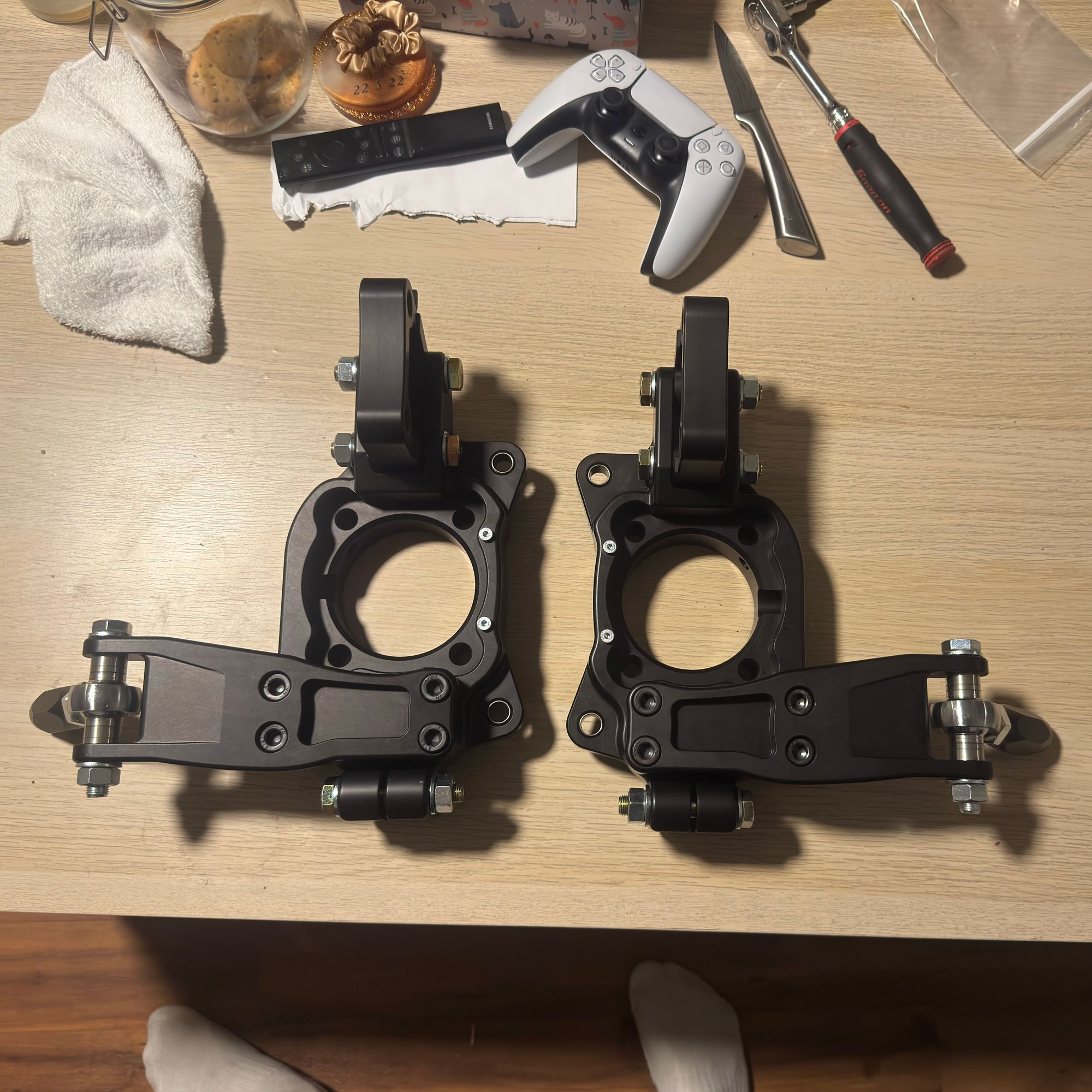

SSB Front Uprights

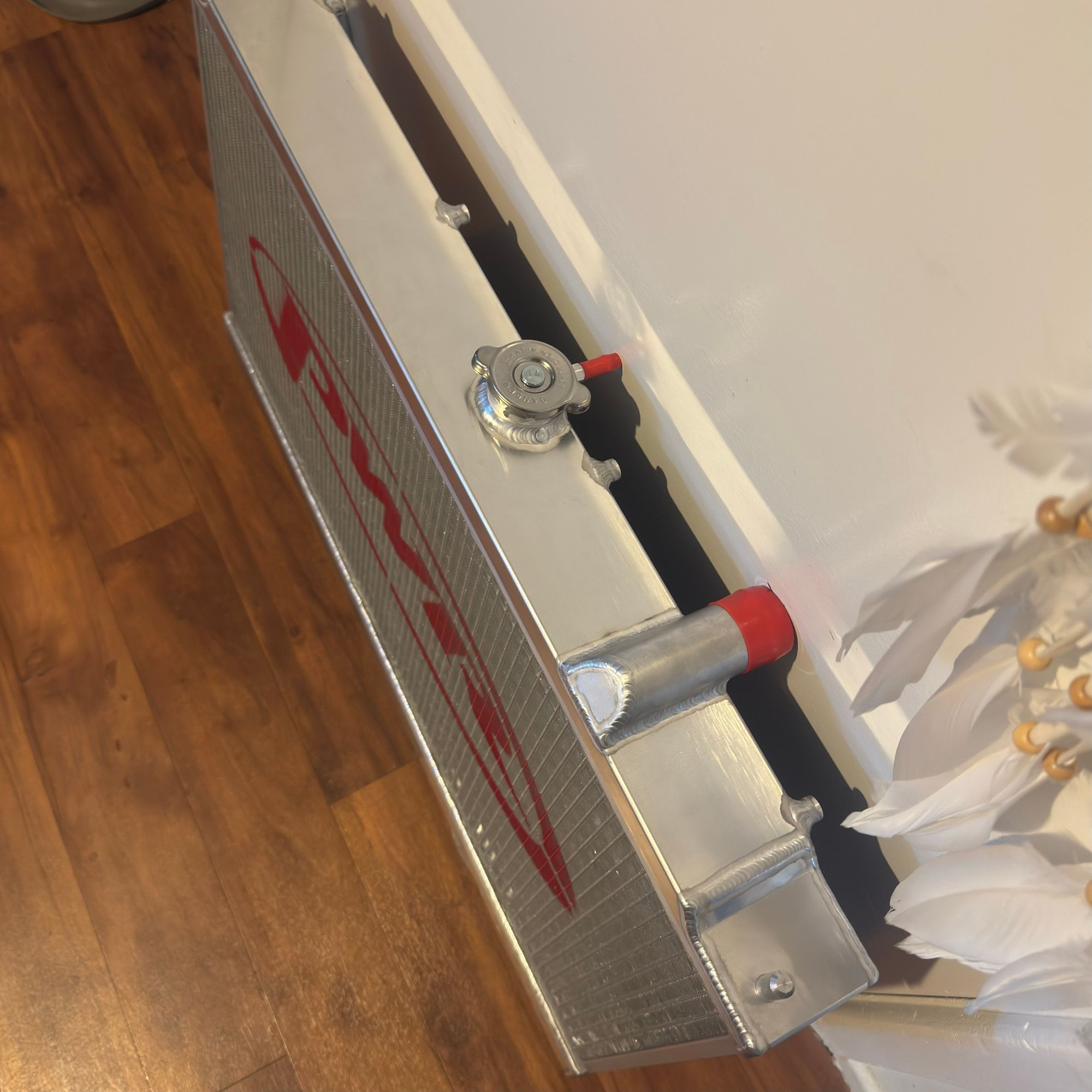

PWR Racing Extruded R Fin 55mm Rad
Sydney Composites Carbon Splitter End Plates
Sydney Composites Carbon Dash

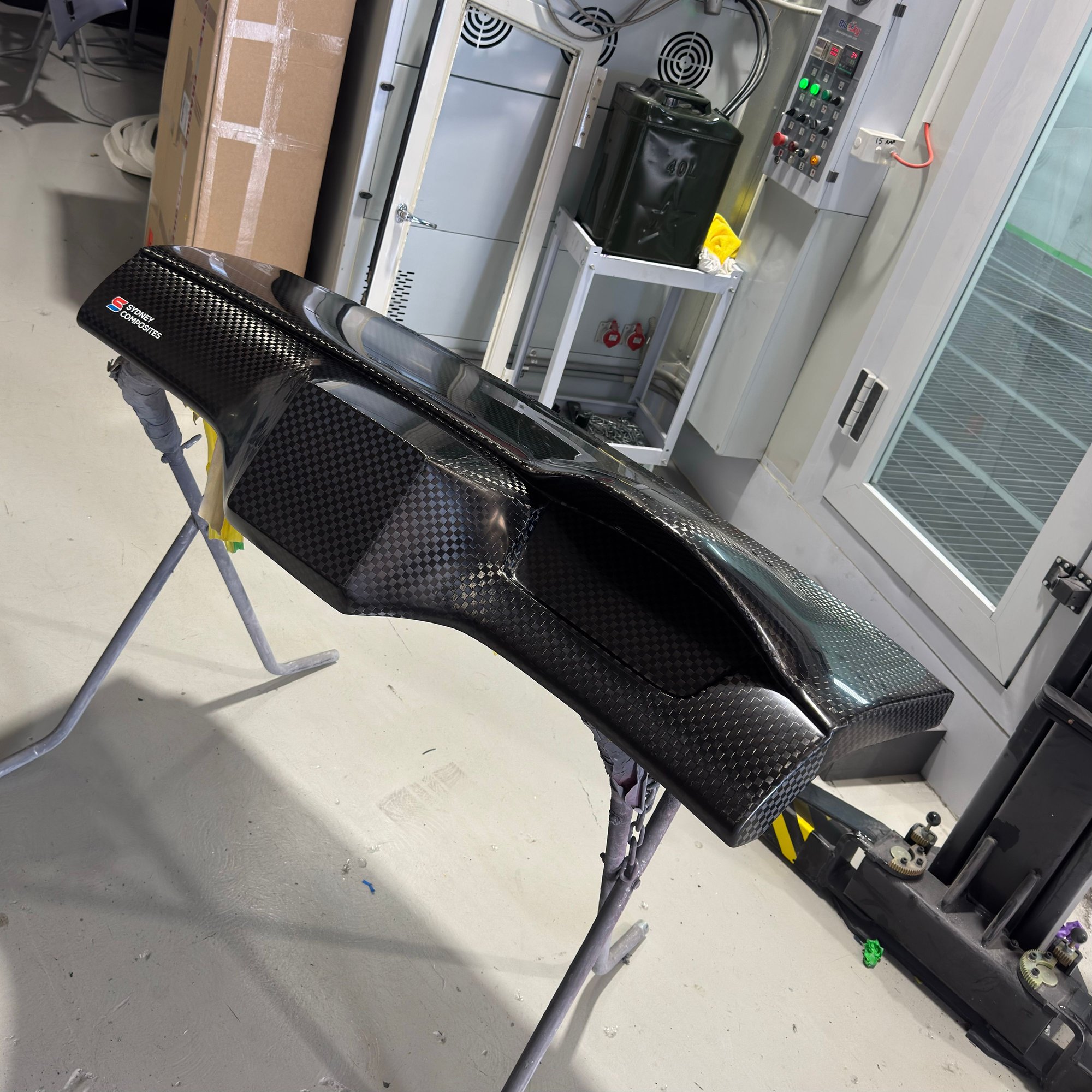

The dash is super super light at only 2.6Ib
The rear SSB uprights should rock up soon as well.

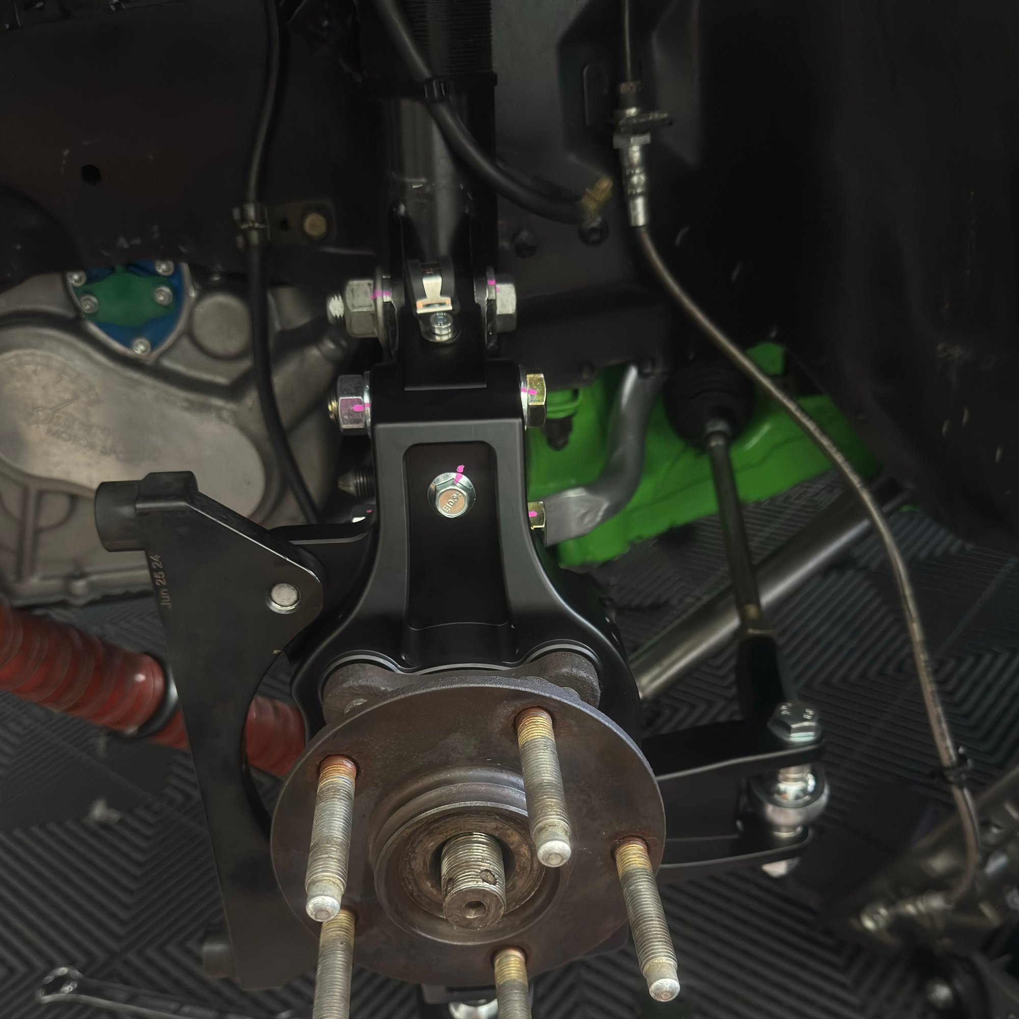

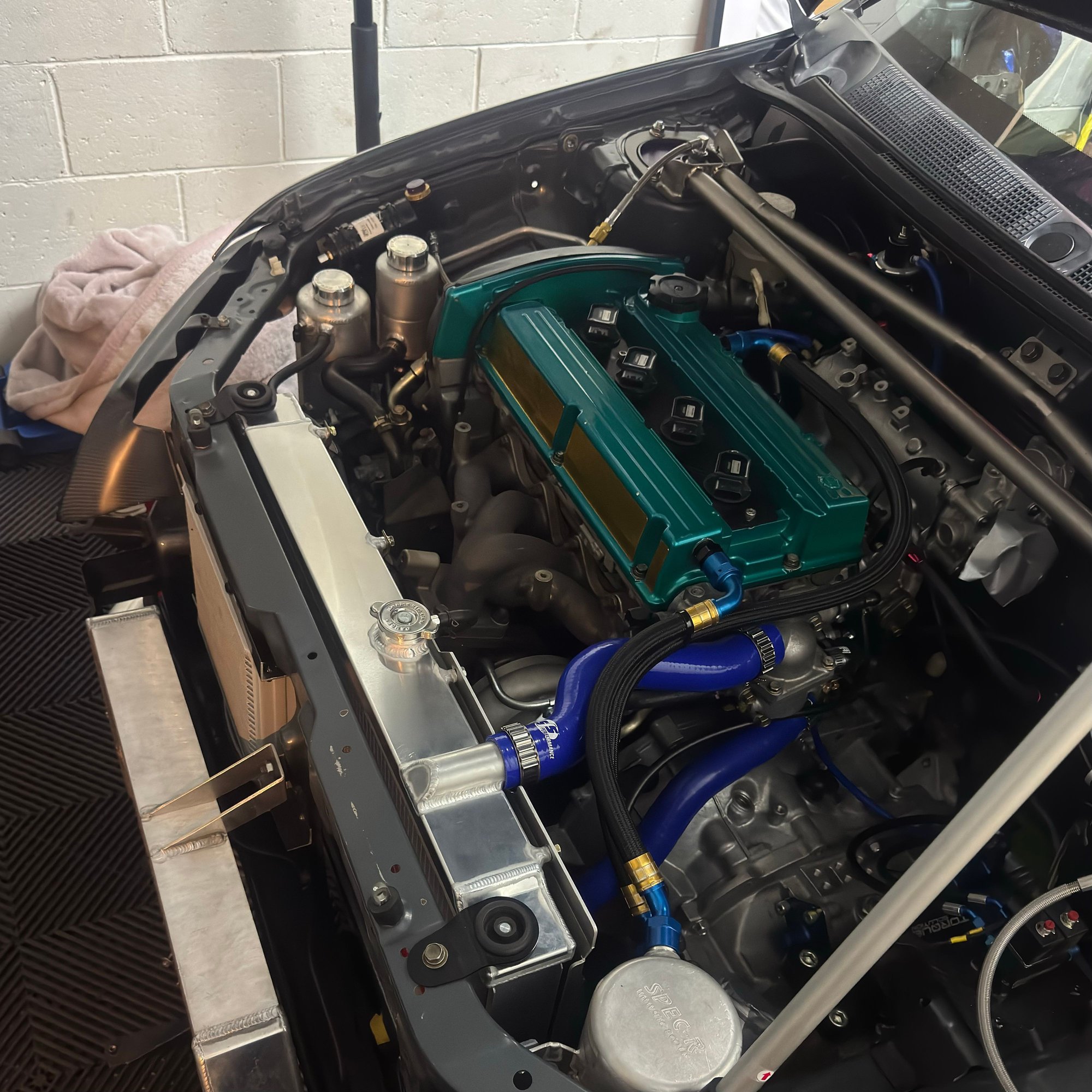

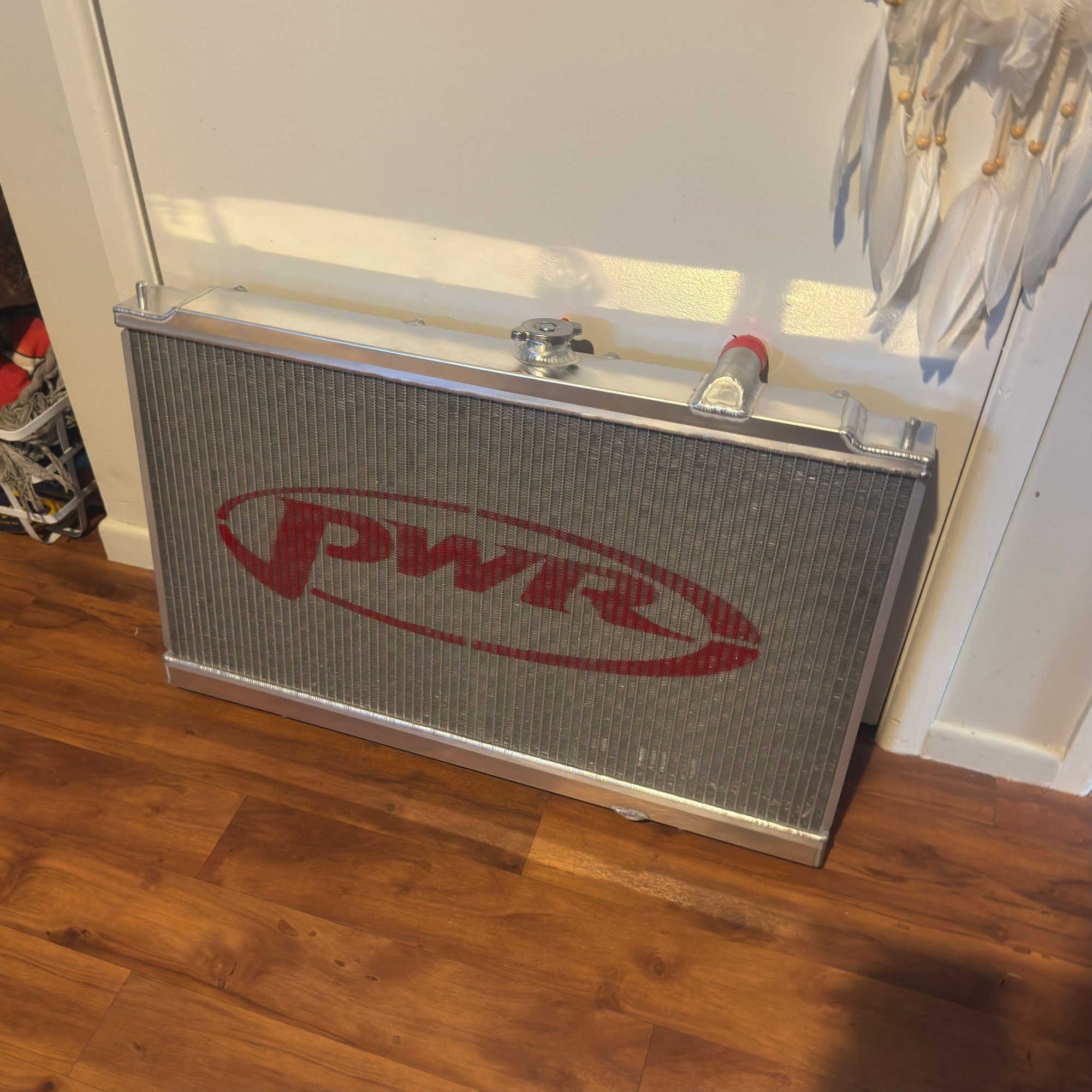

Fitted the front uprights and also fitted the radiator.
Radiator was a super tight fit but it fitted none the less!

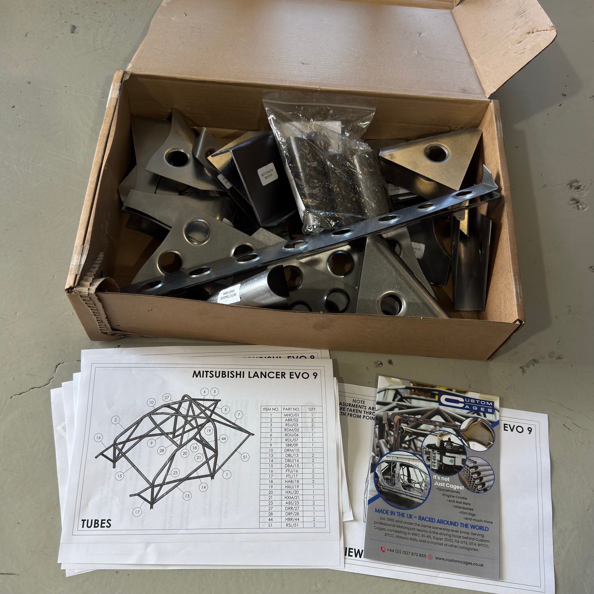

Also my T45 FIA WRC Cage finally turned up from the UK!
Benny

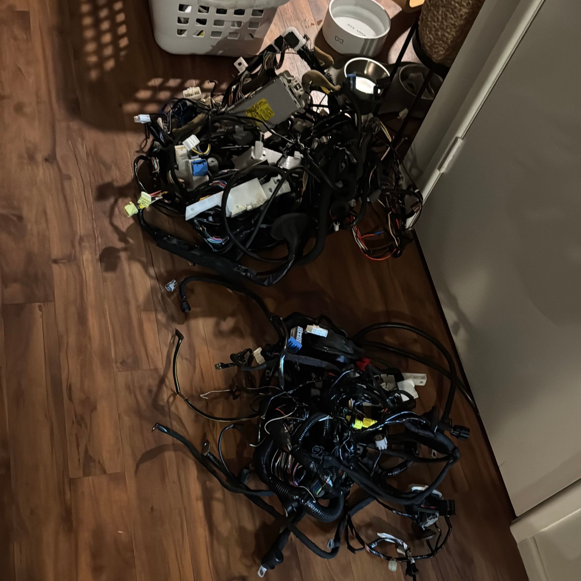

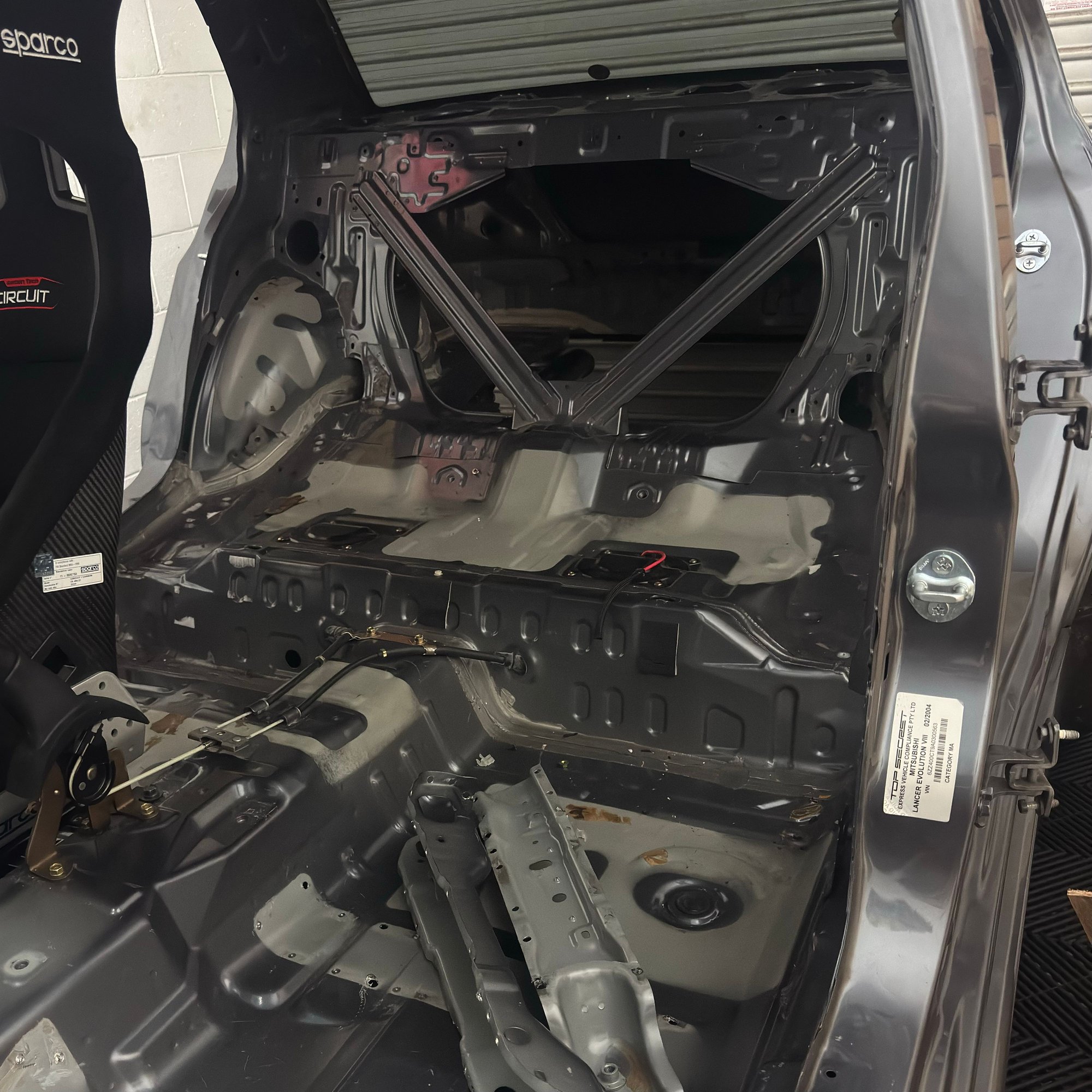

Started stripping the car for the re wire, new brake setup and the roll cage, I removed:
Complete Wiring From The Car
Oem pedals and abs system
All interior bits and pieces
Glass
Engine Bay Firewall Sound Deadening
Benny

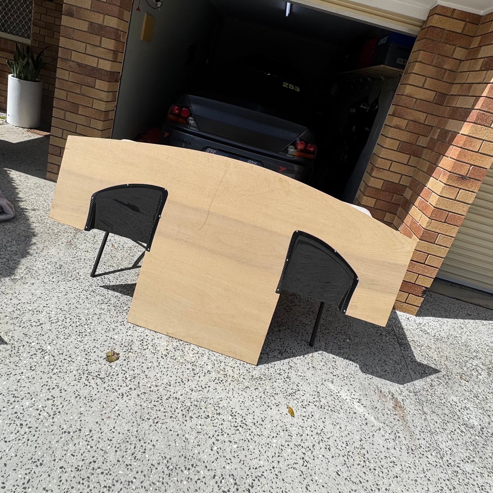

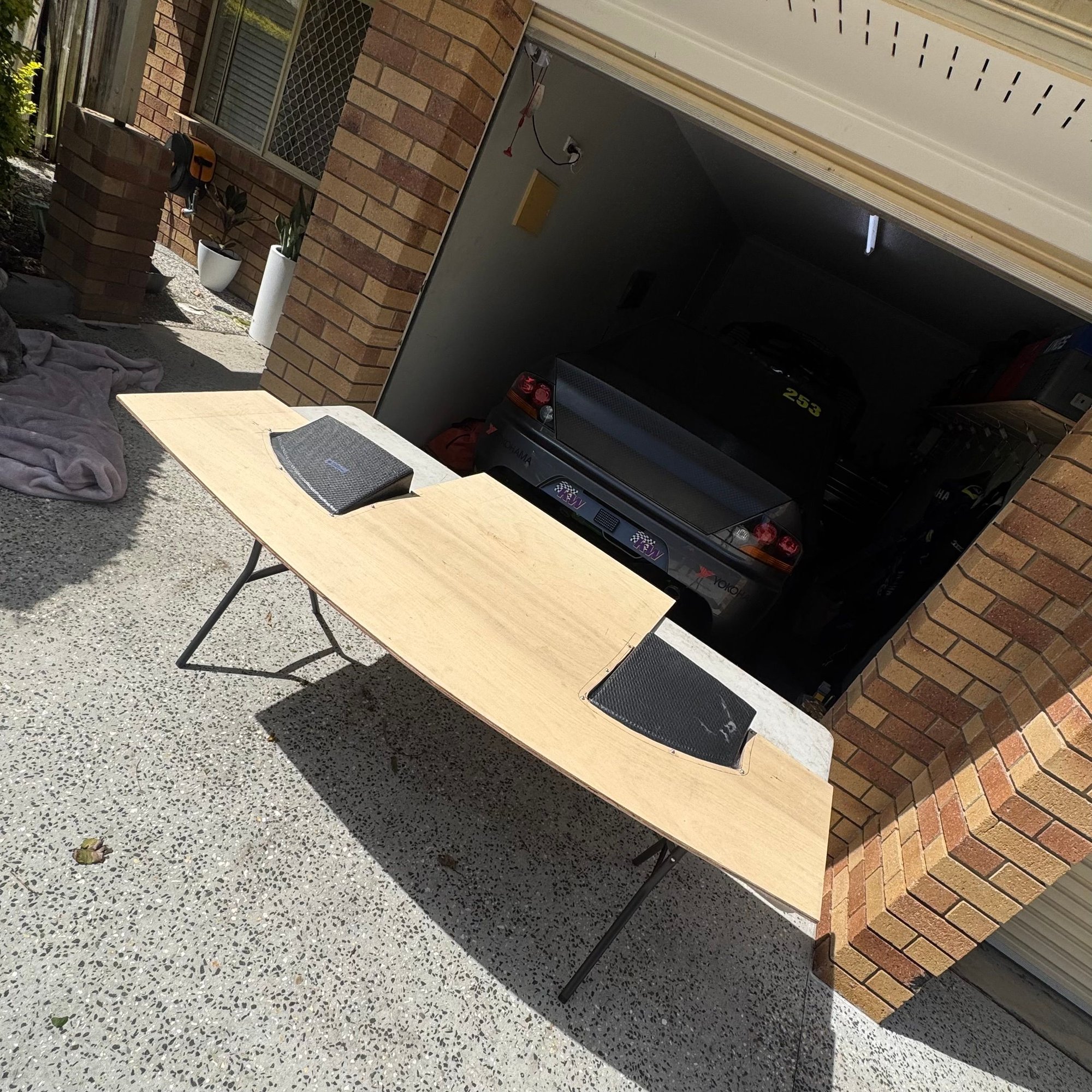

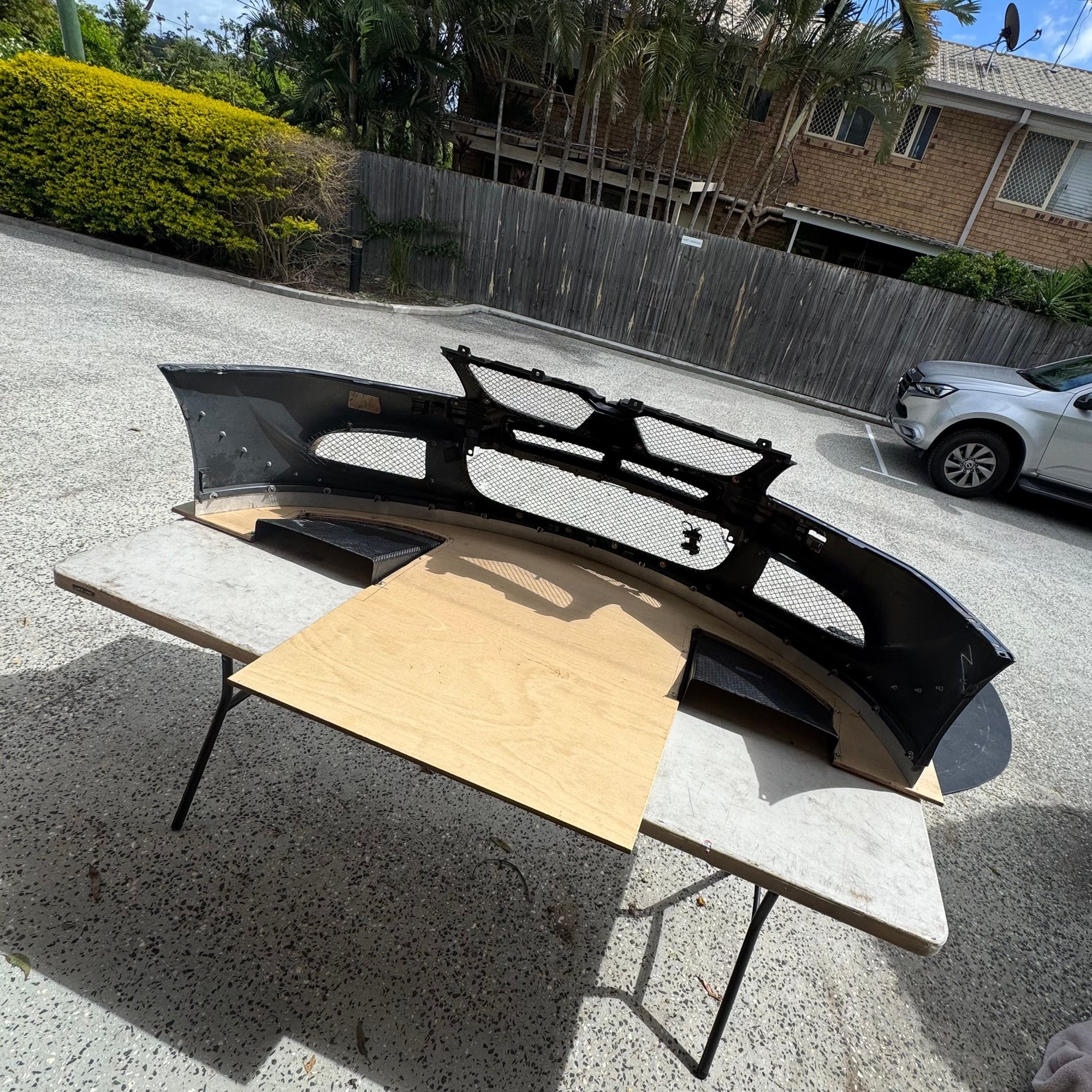

Started making the new splitter and installed the tunnels.
Also test fitted the new carbon bootlid
Benny

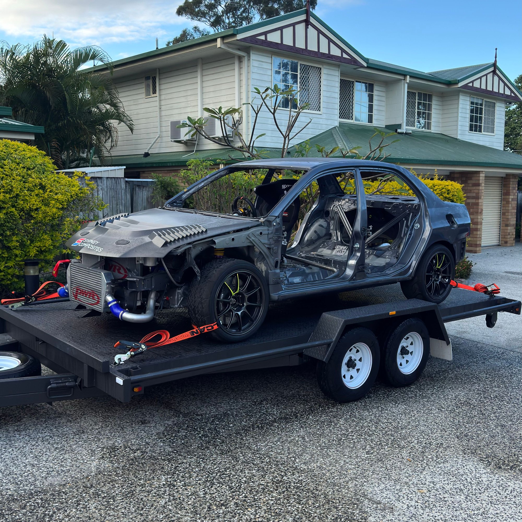

Stripped the car of all the panels, makes it easier for me to paint them whilst the cage is getting done.
loaded the car on the trailer and took it to my fabricator mate to have the cage installed.

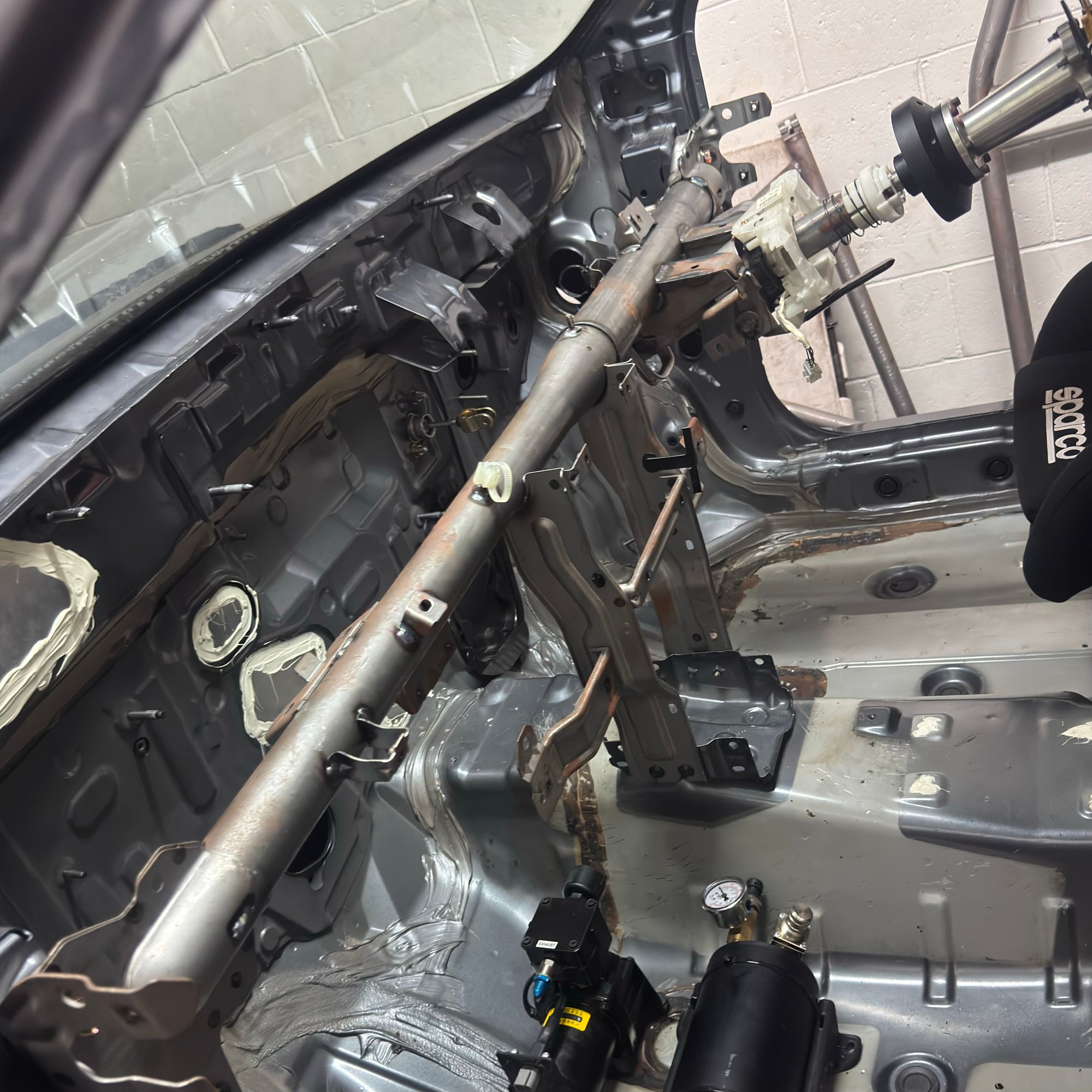

Cage install is going well, I’d say he’s about half way with the cage itself.
Once the cage is done he’ll weld the new seat mounts in & weld the steering column brackets to the dash bar.

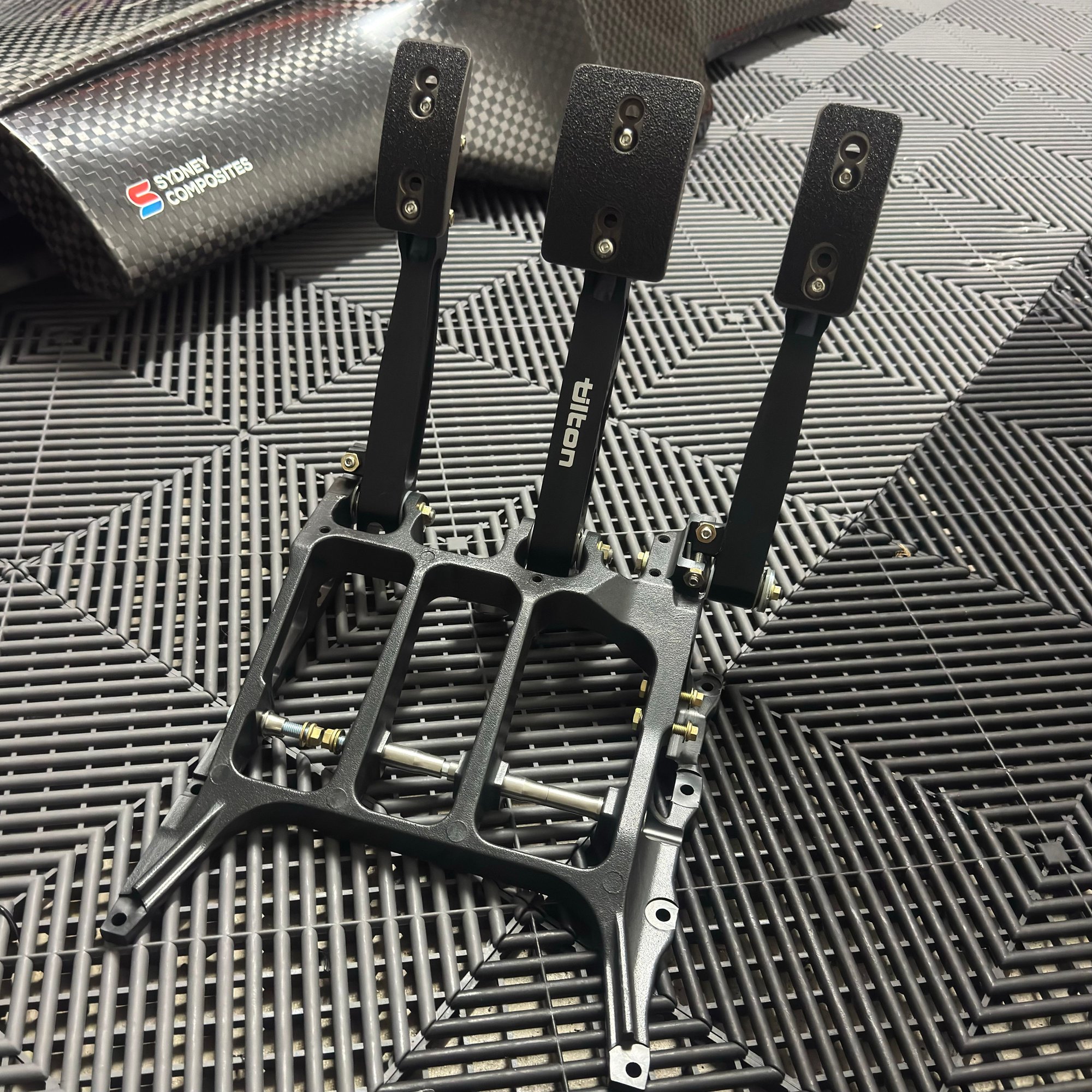

Tilton pedal box turned up, I also went round and starting cutting the dash so it will fit around the cage.
Benny
