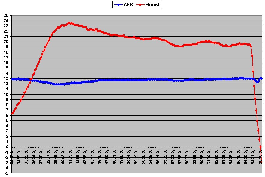

Originally Posted by Spec'd
Might it be possible that Shiv is retarding the timing a bit as to
compensate for the leaner a/f ratios ?
Here's something scary from a 91 base map.
FIRST_LOG SATURDAY 08-05-06 3:00 am
Time,AFR,AFR Lambda,EGT,RPM,Boost
00:01.00,12.9,0.0,744.0,3418.0,6.3
00:01.02,12.9,0.0,746.0,3418.0,6.5
00:01.04,12.9,0.0,746.0,3428.0,6.8
00:01.07,12.9,0.0,747.0,3438.0,7.1
00:01.09,12.9,0.0,748.0,3438.0,7.4
00:01.11,12.9,0.0,749.0,3449.0,7.9
00:01.13,13.0,0.0,750.0,3459.0,8.1
00:01.15,12.9,0.0,750.0,3459.0,8.4
00:01.18,12.9,0.0,752.0,3480.0,8.7
00:01.20,12.9,0.0,753.0,3490.0,9.0
00:01.22,12.9,0.0,754.0,3501.0,9.5
00:01.25,12.9,0.0,756.0,3512.0,9.7
00:01.26,12.8,0.0,758.0,3522.0,10.3
00:01.26,12.8,0.0,758.0,3533.0,10.5
00:01.29,12.8,0.0,760.0,3555.0,11.0
00:01.33,12.8,0.0,761.0,3566.0,11.4
00:01.35,12.7,0.0,762.0,3566.0,11.8
00:01.37,12.7,0.0,765.0,3566.0,12.2
00:01.39,12.7,0.0,766.0,3600.0,12.8
00:01.41,12.6,0.0,768.0,3622.0,13.0
00:01.45,12.6,0.0,769.0,3622.0,13.6
00:01.45,12.6,0.0,772.0,3634.0,13.9
00:01.47,12.6,0.0,773.0,3645.0,14.5
00:01.49,12.6,0.0,774.0,3645.0,14.8
00:01.51,12.6,0.0,777.0,3645.0,15.3
00:01.52,12.5,0.0,778.0,3668.0,15.8
00:01.55,12.4,0.0,779.0,3704.0,16.2
00:01.58,12.4,0.0,781.0,3728.0,16.7
00:01.58,12.4,0.0,782.0,3728.0,17.0
00:01.62,12.3,0.0,784.0,3752.0,17.6
00:01.65,12.3,0.0,786.0,3752.0,18.1
00:01.66,12.3,0.0,787.0,3752.0,18.4
00:01.68,12.3,0.0,788.0,3764.0,19.0
00:01.70,12.3,0.0,790.0,3789.0,19.4
00:01.73,12.2,0.0,792.0,3801.0,19.7
00:01.76,12.2,0.0,793.0,3827.0,20.2
00:01.76,12.2,0.0,794.0,3840.0,20.6
00:01.79,12.1,0.0,797.0,3840.0,20.8
00:01.80,12.1,0.0,798.0,3865.0,21.3
00:01.82,12.0,0.0,799.0,3878.0,21.6
00:01.87,11.9,0.0,801.0,3905.0,21.8
00:01.87,11.9,0.0,803.0,3931.0,22.0
00:01.90,11.9,0.0,804.0,3945.0,22.2
00:01.92,11.9,0.0,806.0,3972.0,22.5
00:01.95,11.9,0.0,807.0,3972.0,22.7
00:01.95,11.9,0.0,809.0,3972.0,22.5
00:01.97,11.9,0.0,810.0,4000.0,22.7
00:01.99,11.9,0.0,811.0,4013.0,23.0
00:02.00,11.9,0.0,812.0,4042.0,23.1
00:02.03,11.9,0.0,813.0,4042.0,23.1
00:02.04,11.9,0.0,815.0,4085.0,23.0
00:02.06,12.0,0.0,817.0,4099.0,23.1
00:02.09,12.0,0.0,818.0,4114.0,23.1
00:02.11,12.0,0.0,819.0,4129.0,23.3
00:02.15,12.0,0.0,822.0,4143.0,23.5
00:02.17,12.0,0.0,823.0,4158.0,23.6
00:02.19,12.1,0.0,824.0,4173.0,23.4
00:02.23,12.2,0.0,825.0,4189.0,23.5
00:02.23,12.2,0.0,826.0,4189.0,23.4
00:02.25,12.2,0.0,829.0,4219.0,23.3
00:02.26,12.2,0.0,830.0,4235.0,23.2
00:02.29,12.2,0.0,831.0,4250.0,23.2
00:02.30,12.2,0.0,832.0,4266.0,23.1
00:02.33,12.2,0.0,834.0,4298.0,23.1
00:02.34,12.2,0.0,835.0,4298.0,23.0
00:02.36,12.2,0.0,836.0,4330.0,23.0
00:02.38,12.2,0.0,838.0,4347.0,23.0
00:02.41,12.3,0.0,838.0,4347.0,23.0
00:02.43,12.3,0.0,839.0,4363.0,22.8
00:02.45,12.3,0.0,841.0,4396.0,22.7
00:02.48,12.4,0.0,842.0,4396.0,22.7
00:02.49,12.4,0.0,842.0,4430.0,22.7
00:02.51,12.4,0.0,843.0,4447.0,22.3
00:02.53,12.4,0.0,844.0,4447.0,22.2
00:02.55,12.4,0.0,845.0,4465.0,22.2
00:02.57,12.4,0.0,847.0,4482.0,22.3
00:02.59,12.4,0.0,849.0,4500.0,22.3
00:02.61,12.5,0.0,849.0,4517.0,22.2
00:02.65,12.5,0.0,850.0,4535.0,22.2
00:02.66,12.5,0.0,851.0,4553.0,22.1
00:02.69,12.6,0.0,853.0,4571.0,22.3
00:02.72,12.6,0.0,854.0,4589.0,22.3
00:02.74,12.6,0.0,855.0,4608.0,22.0
00:02.76,12.7,0.0,856.0,4626.0,22.0
00:02.79,12.7,0.0,858.0,4645.0,22.1
00:02.80,12.7,0.0,860.0,4663.0,22.0
00:02.82,12.7,0.0,861.0,4663.0,21.8
00:02.82,12.7,0.0,863.0,4682.0,21.8
00:02.86,12.7,0.0,864.0,4702.0,21.6
00:02.88,12.7,0.0,866.0,4702.0,21.5
00:02.90,12.7,0.0,867.0,4721.0,21.6
00:02.92,12.7,0.0,867.0,4760.0,21.5
00:02.94,12.7,0.0,868.0,4760.0,21.4
00:02.96,12.7,0.0,869.0,4800.0,21.4
00:02.98,12.7,0.0,870.0,4800.0,21.3
00:03.00,12.7,0.0,872.0,4820.0,21.2
00:03.02,12.7,0.0,872.0,4840.0,21.2
00:03.04,12.7,0.0,873.0,4840.0,21.3
00:03.06,12.7,0.0,873.0,4881.0,21.3
00:03.08,12.7,0.0,874.0,4881.0,21.3
00:03.10,12.7,0.0,875.0,4902.0,21.2
00:03.13,12.7,0.0,876.0,4902.0,21.2
00:03.15,12.7,0.0,876.0,4923.0,21.1
00:03.18,12.7,0.0,877.0,4965.0,21.1
00:03.20,12.7,0.0,879.0,4965.0,21.1
00:03.22,12.7,0.0,880.0,4965.0,21.1
00:03.24,12.7,0.0,880.0,4987.0,21.1
00:03.26,12.7,0.0,881.0,4987.0,21.2
00:03.27,12.7,0.0,881.0,5008.0,20.9
00:03.29,12.7,0.0,882.0,5052.0,20.9
00:03.32,12.7,0.0,883.0,5074.0,20.9
00:03.34,12.8,0.0,883.0,5074.0,20.8
00:03.36,12.7,0.0,885.0,5074.0,20.8
00:03.38,12.7,0.0,886.0,5097.0,20.8
00:03.41,12.7,0.0,886.0,5097.0,20.8
00:03.43,12.7,0.0,886.0,5120.0,20.8
00:03.45,12.7,0.0,887.0,5142.0,20.8
00:03.48,12.7,0.0,887.0,5165.0,20.9
00:03.50,12.7,0.0,888.0,5189.0,20.8
00:03.52,12.7,0.0,888.0,5212.0,20.6
00:03.53,12.7,0.0,888.0,5212.0,20.6
00:03.55,12.7,0.0,889.0,5212.0,20.7
00:03.57,12.7,0.0,891.0,5236.0,20.6
00:03.61,12.7,0.0,891.0,5260.0,20.5
00:03.63,12.7,0.0,891.0,5284.0,20.5
00:03.65,12.7,0.0,892.0,5308.0,20.5
00:03.67,12.7,0.0,893.0,5308.0,20.4
00:03.69,12.7,0.0,894.0,5308.0,20.5
00:03.71,12.7,0.0,895.0,5333.0,20.5
00:03.73,12.7,0.0,896.0,5333.0,20.5
00:04.26,12.8,0.0,896.0,5333.0,20.5
00:04.26,12.8,0.0,899.0,5358.0,20.5
00:04.26,12.8,0.0,899.0,5383.0,20.5
00:04.26,12.8,0.0,900.0,5408.0,20.5
00:04.26,12.8,0.0,901.0,5433.0,20.6
00:04.26,12.8,0.0,902.0,5433.0,20.6
00:04.26,12.8,0.0,904.0,5459.0,20.7
00:04.26,12.8,0.0,906.0,5459.0,20.8
00:04.26,12.8,0.0,907.0,5485.0,20.6
00:04.26,12.8,0.0,908.0,5485.0,20.6
00:04.26,12.8,0.0,910.0,5511.0,20.6
00:04.26,12.8,0.0,911.0,5511.0,20.5
00:04.26,12.8,0.0,912.0,5511.0,20.5
00:04.26,12.8,0.0,913.0,5538.0,20.4
00:04.26,12.8,0.0,915.0,5565.0,20.3
00:04.26,12.8,0.0,917.0,5592.0,20.3
00:04.26,12.8,0.0,918.0,5592.0,20.2
00:04.26,12.8,0.0,918.0,5619.0,20.1
00:04.26,12.8,0.0,918.0,5647.0,20.0
00:04.26,12.7,0.0,919.0,5619.0,19.8
00:04.26,12.7,0.0,920.0,5647.0,19.7
00:04.26,12.7,0.0,921.0,5647.0,19.6
00:04.26,12.7,0.0,921.0,5674.0,19.5
00:04.28,12.6,0.0,921.0,5702.0,19.4
00:04.28,12.6,0.0,921.0,5702.0,19.3
00:04.32,12.6,0.0,921.0,5731.0,19.2
00:04.34,12.6,0.0,923.0,5731.0,19.2
00:04.34,12.6,0.0,923.0,5760.0,19.2
00:04.36,12.6,0.0,924.0,5788.0,19.2
00:04.38,12.6,0.0,924.0,5788.0,19.1
00:04.42,12.6,0.0,924.0,5788.0,19.1
00:04.44,12.6,0.0,925.0,5788.0,19.1
00:04.46,12.6,0.0,925.0,5818.0,19.1
00:04.48,12.6,0.0,926.0,5818.0,19.2
00:04.50,12.7,0.0,927.0,5877.0,19.3
00:04.52,12.7,0.0,927.0,5877.0,19.4
00:04.53,12.7,0.0,929.0,5877.0,19.4
00:04.57,12.7,0.0,929.0,5877.0,19.4
00:04.59,12.7,0.0,930.0,5907.0,19.4
00:04.61,12.8,0.0,930.0,5907.0,19.4
00:04.63,12.8,0.0,931.0,5938.0,19.4
00:04.65,12.8,0.0,931.0,5968.0,19.4
00:04.67,12.8,0.0,931.0,6000.0,19.5
00:04.69,12.8,0.0,932.0,6000.0,19.5
00:04.72,12.7,0.0,932.0,5968.0,19.5
00:04.73,12.7,0.0,932.0,6000.0,19.5
00:04.76,12.7,0.0,932.0,6000.0,19.6
00:04.77,12.7,0.0,933.0,6031.0,19.8
00:04.80,12.7,0.0,934.0,6063.0,19.8
00:04.82,12.7,0.0,934.0,6063.0,19.8
00:04.84,12.7,0.0,934.0,6063.0,19.9
00:04.86,12.7,0.0,934.0,6095.0,20.0
00:04.88,12.7,0.0,936.0,6127.0,20.0
00:04.90,12.8,0.0,937.0,6095.0,20.0
00:04.92,12.8,0.0,938.0,6127.0,20.0
00:04.94,12.8,0.0,938.0,6095.0,20.1
00:04.97,12.9,0.0,939.0,6127.0,20.0
00:05.00,12.9,0.0,939.0,6160.0,20.0
00:05.01,12.8,0.0,940.0,6160.0,20.1
00:05.03,12.8,0.0,940.0,6193.0,20.0
00:05.05,12.8,0.0,940.0,6193.0,19.9
00:05.07,12.9,0.0,942.0,6227.0,19.8
00:05.11,12.9,0.0,943.0,6227.0,19.8
00:05.11,12.9,0.0,943.0,6227.0,19.7
00:05.13,12.9,0.0,944.0,6260.0,19.8
00:05.17,12.9,0.0,944.0,6260.0,19.7
00:05.19,12.9,0.0,945.0,6295.0,19.7
00:05.21,12.9,0.0,945.0,6295.0,19.7
00:05.23,12.9,0.0,946.0,6295.0,19.5
00:05.25,12.9,0.0,948.0,6295.0,19.4
00:05.26,12.9,0.0,949.0,6329.0,19.4
00:05.28,13.0,0.0,950.0,6364.0,19.2
00:05.32,13.0,0.0,950.0,6329.0,19.2
00:05.34,13.0,0.0,950.0,6400.0,19.2
00:05.36,12.9,0.0,951.0,6400.0,19.3
00:05.38,12.9,0.0,951.0,6400.0,19.2
00:05.40,12.9,0.0,951.0,6435.0,19.1
00:05.42,12.9,0.0,951.0,6435.0,19.1
00:05.44,12.9,0.0,952.0,6435.0,19.1
00:05.46,12.9,0.0,953.0,6435.0,19.2
00:05.48,13.0,0.0,955.0,6471.0,19.3
00:05.52,13.0,0.0,957.0,6471.0,19.4
00:05.53,13.0,0.0,958.0,6508.0,19.4
00:05.55,13.0,0.0,959.0,6508.0,19.4
00:05.57,13.0,0.0,961.0,6508.0,19.4
00:05.59,13.0,0.0,962.0,6508.0,19.5
00:05.61,13.0,0.0,963.0,6545.0,19.5
00:05.63,13.1,0.0,964.0,6545.0,19.7
00:05.65,13.1,0.0,964.0,6545.0,19.5
00:05.67,13.1,0.0,965.0,6582.0,19.5
00:05.69,13.1,0.0,968.0,6582.0,19.5
00:05.72,13.0,0.0,968.0,6582.0,19.6
00:05.75,13.0,0.0,969.0,6620.0,19.6
00:05.77,13.0,0.0,970.0,6620.0,19.6
00:05.79,13.0,0.0,971.0,6658.0,19.5
00:05.80,13.0,0.0,971.0,6658.0,19.4
00:05.82,13.0,0.0,971.0,6658.0,19.5
00:05.84,13.0,0.0,972.0,6658.0,19.4
00:05.86,13.0,0.0,972.0,6658.0,19.1
00:05.88,13.0,0.0,972.0,6658.0,17.3
00:05.92,13.0,0.0,971.0,6471.0,14.3
00:05.94,12.9,0.0,968.0,6329.0,11.5
00:05.97,12.7,0.0,962.0,6295.0,9.1
00:06.00,12.4,0.0,955.0,6364.0,6.9
00:06.03,12.3,0.0,948.0,6545.0,4.9
00:06.03,12.5,0.0,944.0,6816.0,3.1
00:06.05,12.9,0.0,939.0,6816.0,1.4
00:06.09,13.1,0.0,933.0,6816.0,0.0
00:06.11,13.0,0.0,927.0,6776.0,-2.9
wow friend you are very lean was this a 3erd gear pull???
That pull was an off the shelf 91 map on a cool night.
I've since added about a point of fuel.
Did you back off the boost a bit? Your hitting 23.6 and only tapering to 19 by redline. That MIGHT be too high on 91 pisstane gas.
I love pisstane gas. But seriously, I turned the boost down and enrichend
the mixture.
I put Spec'd data in an Excel graph to make it easier to see.
That looks real good, I need to find my Excel disc.

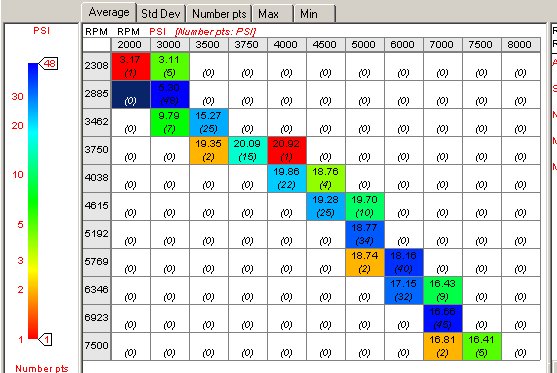

Originally Posted by Jeff_Jeske
It doesn't matter what maps you download they are all very aggressive.

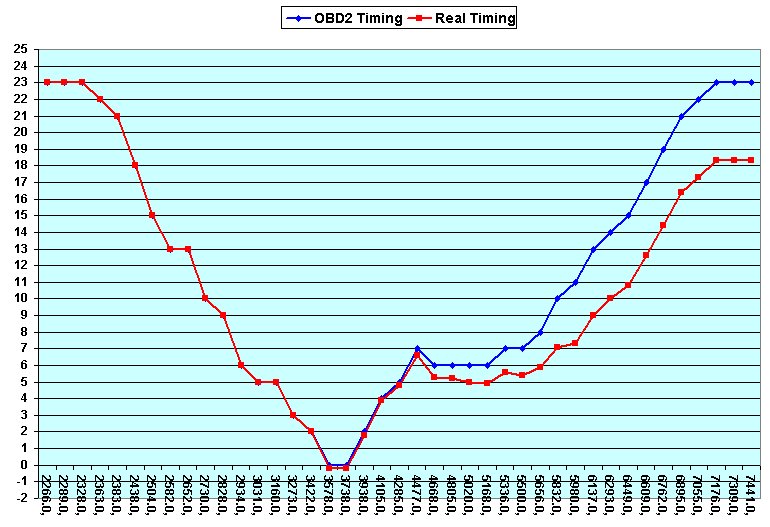

That is too general a statement. It depends on what you look at. If you look at the AFR by itself, then it does look too lean. But if you look at the timing and the boost, then the settings are tame compared to other tuners out there. I have now done enough logs to see the real timing and boost on the TBE maps.
Below is a table of five boost logs in 3rd gear. These are the boost logs before I changed. These are averages and not max and min. As you can see the boost is very tame. It is stock like boost.
I have also logged enough timing maps to tell that the timing is also tame compared to the timing that I have seen others post on the forums. Below is a typical timing map with the off-the-shelf maps.
I think it is possible with this retarded timing and the tame boost to run an AFR at 12:1. But you would need constant monitering and using all the protective features in the Xede.
Attached Thumbnails Isn't That Lean?-shiv_boost_5.jpg   Isn't That Lean?-93_timing_9.jpg   Isn't That Lean?-93_timing_14.jpg

You should be able to run more timing at 3600 rpm then that. With a very nice torque increase. Espically if your boost is only 20psi.
Ahhh...But that defeats the MTBT approach to tuning The whole idea is to retard the timing, back down the boost, and run your AFR at close to optimum burn as possible.
Right now I have upped the boost on my car and I am peaking around 22-23 psi. But this is only because I am running 11.4-11.5:1 AFR. Once I get my EGT gauge installed and logging, I will back down the boost to a max of 21 psi at peak, lean the mix to 12:1 and make sure that the EGTs are around 850*C.
