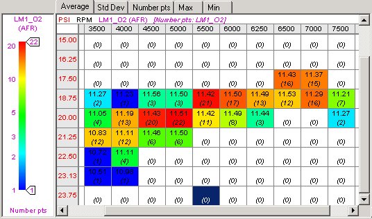

This is the latest compilation of four AFR/PSI logs. Logworks allows you to compile as many logs as you want and make a neat table that shows you where your AFR is in relation to any other variable. In this case the AFR is in relation to rpm and PSI.
For example, @ 5K rpm and 20 psi there are 22 AFR data points whose Average 11.51:1. You can also show this table in max, min, number points, and Std Dev. This one is in Avg. You can also add and remove rows/columns as you wish. I made the columns similar to those of the Xede Fuel columns.
That is what I love about Logworks/Innovate it has so many features and is very expandable.
To my eyes, this is the best yet. The large majority of AFR points are in the 11.40-11.53 range.
I also made the AFR taper to 11:30ish @ 7k. Is that too much or too little? What do you think.
The only thing I do not like is that the car is boosting to 23.xx psi. I want to make sure not to boost above 22 psi or 21.5 psi even.

I would say you have nearly a perfect tune right there.

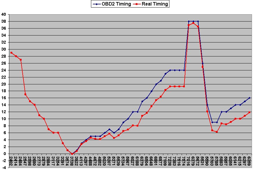

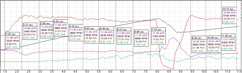

Some of you have asked me to do a full 3rd gear and 4th gear WOT runs. Well I almost pulled it off on a very nice long on ramp close to where I live. I went to 7500 rpm in 3rd and 6400 rpm in 4th. I ran out of room towards the end. One of these dyas I will get a chance to do a full run in both gears. Here is the image of the run:
I also did the timing during the same run and the curve looks very nice to my eyes.

NJ..... by looking at the timing on the 3/4 run.....you can add a few more * up top. If its holding at 18 you should try to get 20.
yeah thats true in my case iam getting 22* at redline, but the funny thing is that i used to get 20* but after adding more fuel to my map the timing went up 2*,maybe my car had a bit of knock acceptable i would say cause it was only 2* of timing.
