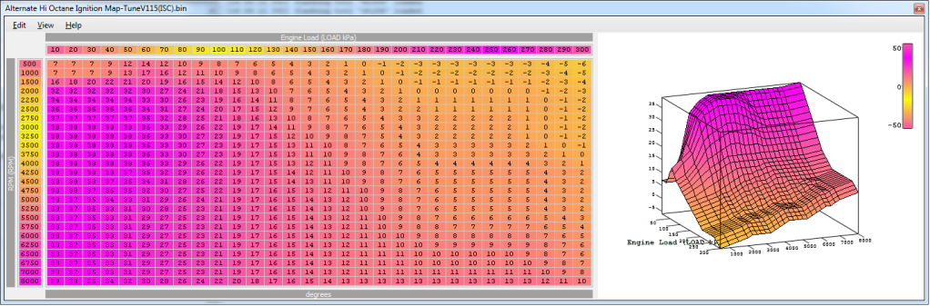

Let's post some timing maps guys. Here is my current one to revive the thread
There is A LOT of work in this map, as I got the car in July 2010. I spent about 2000hours on these forums ... I decided to transfer my tuning knowledge from my celica and learn more about evos.
My car seem satisfied with this current one :
-Street tune, 91 octane, IX turbo, bolt-ons, stock cams.
-AFR: 12.5@Spoolup and steady 11.5, then leaning it a little bit up to redline.
-23psi taper to 21psi, ~265 load taper to ~245.
-7500 redline.
Still some minor things to adjust, but I'm waiting for summer up here in Canada

thats a good looking map

Looks smooth and fine.

Nice map. Any numbers with that set up?

No I haven't any updated Vdyno numbers. Around 320 maybe. Stock cams are holding the car like a parachute

That's fine very good job.
Btw i think that on 91 octane we can run with stock ignition sistem about 10/11/12 degree up top.
On 93 i'm looking for a solid 14* . Hoping is possible.
My timing map which i'm working on, is about the same , minor differences but that's all.
Mods are nearly identical.
I wanna try to peak @25psi and tape to 20/21psi, spoolin up with target of 12.5 afr and then tape to 11.5 to 6500 and 11.3 to 7500.
Afr tune is 99% done. Timing needs a lot more skills
