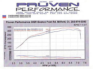

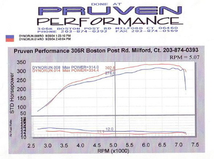

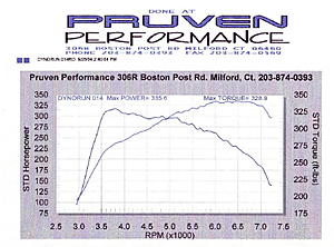

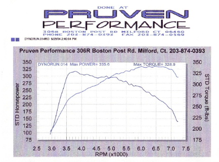

I went back to Pruven today to get retuned after getting the TT flash and having an issue with it. I will post more details later when I have time, but basically here it is. I baselined with the TT custom tune at 314 whp and 308 ft-lbs of torque. We did 2 baseline runs and that was the higher one. The AFR was at 12.0 until redline when it hit 11.8. Pretty lean. The car also slightly pulled some timing out up top. After Al retuned the car totally, I left there with 335 whp and 328 ft lbs of torque with an AFR of 11.0. Much safer tune, and alot more power. Exact same mods, custom tune vs. custom tune. When I have some more time, I will explain what happend in greater detail. Until then maybe Al can chime in with what he found.
Here is the before and after, and the final result. The second sheet has the smoothing turned off.
Attached Thumbnails Official "I got DynoFlashed!" Thread-dynoflash1.jpg   Official "I got DynoFlashed!" Thread-dynoflash2.jpg
