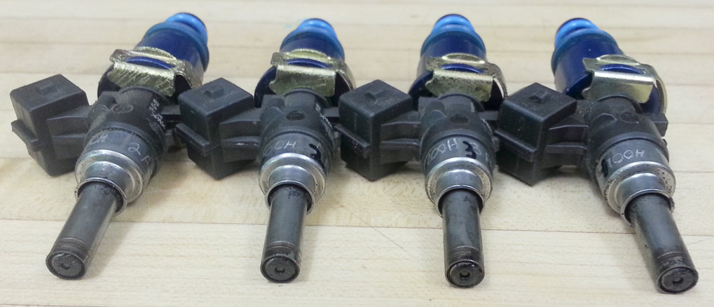

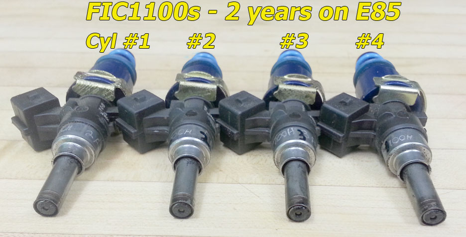

here are my fic1100s after ~2 years on nothing but e85. about a year of that has been on vta crankcase setup. lookin' pretty good. they are at a local shop now being flow tested before and after cleaning.

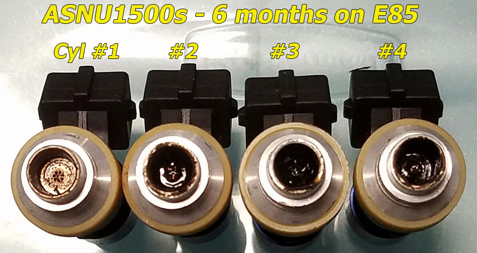

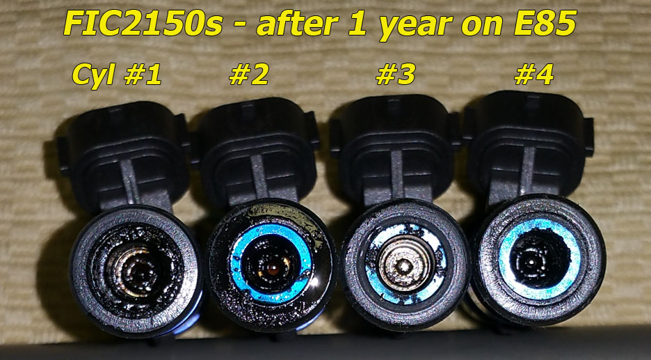

Well, I had minimal gunk issues after few years on E85 with FIC1100s (first picture), but the gunk issue has been hitting my Evo pretty consistently in the last few years. My FIC2150s did not fare too well after maybe a year and 5K miles on E85 (second picture). The issue has been even worse for my ASNU1500s after maybe 6 months and 2.5K miles on E85 (third picture). For FIC2150s and ASNU1500s, its fascinating that one injector in each set was not appreciably gunked up. It was a different cylinder each time too. I have no explanation for it. All three sets of injectors only saw E85 was from Jay's garage in downtown Portland.

The key questions for long term regular usage are whether any of these products are soluble in E85 and whether there are any long term usage compatibility issues. Amsoil says that while Performance Improver is soluble in E85, but if used in every tank, it will cause any seals to degrade. Presumably this is means rubber and synthetic rubber. 3M also said that their cleaner will also cause seal damage if used regularly. I just got off phone with Redline, and they said that SI-1 has insoluble elements that will plate out a gooey substance on the bottom of the fuel tank. Its unfortunate for the SI-1 because its one of the few additives that is made for continual usage. UPDATE: After a bit more research, I have found that Royal Purple and Champion both have PEA-containing products that are safe for continual usage and are either compatible with or made for ethanol. Champion tech did however note that PEA will cause motor oil to thicken. So perhaps these latter two products will provide an additive-based solution to this issue.

Interestingly, it ran fine under light load. Trims were just going strongly positive, and it was misfiring when transitioning into boost. My FIC1100s got gunked up once, and in that case there was no high load misfire, but trims went somewhat positive, and it would miss on cold start. So very important to routinely check fuel trims.
