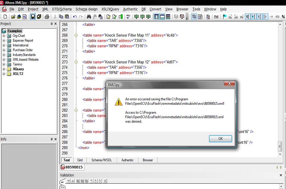

I'm getting this error, why am I getting this?

Because vista is security conscious you need to save it to somewhere else and the copy it back..
you may even need to save it as a .txt and then copy it back and then rename it back to .xml...

So then I just edit it through wordpad when I change it to txt? Then rename it basically right?

yup and stick it (overwrite) the old file in the ecuflash directory...

Still won't let me, it says I dont have permission to write in the folder...
i took out the old rom, copied the new one in as a txt doc, then tried to save the old one as a xml doc and didn't work, it gave me the above mentioned error

you got admin rights on you box?
try deleting the file first?
closed EcuFlash just incase?

I didn't delete the original 88590015 file, i just cut it and paste it into the documents folder; i do have admin rights, i mean its my personal laptop; so you're suggesting to delete the original 88590015 alltogether?
Sorry for making this more difficult then it should be, just a little slow with this "detailed/expert" adjusting on the comp

hallelujah!! Finally got it, thanks for helping me tephra, I REALLY APPRECIATE IT!!!!
