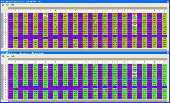

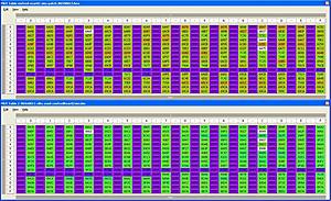

Old Mar 15, 2008 | 08:19 PM
  #194
l2r99gst's Avatar
Posts: 3,499
From: CA
mrfred,
OK, as promised, here is what I have for my ROM, 96940011. Here are some screenshots comparing your ROM, before and after, and my ROM, before and after. Let me know if this looks like it is correct or what I would have to do to tell if it is correct. I read what you wrote above, but once you got into the ADC lookups, I'm lost at that point.
OK, here is a screenshot of the changes you made to your ROM. I'm sure you are very familiar with this, but for reference and comparison to my ROM. The screenshot shows the 'sim hook' location in the original ROM, the patched code, and the new subroutine:
Next, here is a screenshot showing my ROM (96940011) showing what I think is the same code reference as you used for your sim hook. Again, the first code is the stock ROM, then the patched code, then the new subroutine.
Here are the MUT tables, just to show that I am using the same addresses (the low byte) as you have used in your subroutine.
So, does it look like I am doing this right? I'm guessing that the location that I am using for the sim hook needs to be verified if it is a redundant ADC lookup? I think that is where I'm not sure what to do.
Anyway, thanks for helping and let me know where I should go from here or if this looks right, as far as you can tell.
Thanks,
Eric
Attached Thumbnails Want to remove/disable your rear O2 sensor without a CEL? Here's how..-mrfred-88590015-rearo2sim-idapro-changes2.jpg   Want to remove/disable your rear O2 sensor without a CEL? Here's how..-96940011rear02simpatch2.jpg   Want to remove/disable your rear O2 sensor without a CEL? Here's how..-muttables2.jpg

Originally Posted by l2r99gst
Where is your revised code?...
Thanks,
Eric
Revised code is in my post where I first showed the code.
