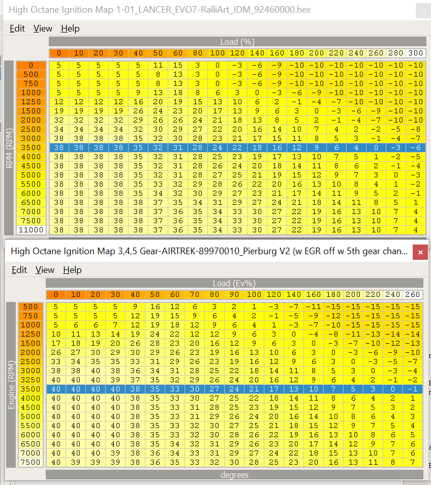

Old Nov 9, 2020 | 08:16 PM
  #2906
OzAirtrek's Avatar
Joined: Oct 2017
Posts: 108
Likes: 11
From: Perth, Australia
Question
Folllowing from #2903 can anyone help explain to me the difference in timming between these two maps? Just trying to understand the relationship
Top map is Evo 7 Ralliart rom, bottom map is Airtrek with 8 MR cams, smaller turbo with 14 psi (rest is same).
The raliart timing map is basically shifted to the right to towards the higher load limit.
However if i ran that timing i would be getting knock in the lower in the lower load (160-200) axis..
Is the td05 and the way it delivers peak torque later in the the rpm the difference?
Old Nov 9, 2020 | 08:43 PM
  #2907
Biggiesacks's Avatar
Posts: 5,690
Likes: 708
From: West Coast
Not too sure about the airtrek map but afaik the reason JDM has more timing is because their market has higher octane fuel.
Old Nov 9, 2020 | 09:30 PM
  #2908
OzAirtrek's Avatar
Joined: Oct 2017
Posts: 108
Likes: 11
Thanks for the reply - they are both JDM though..
Old Nov 9, 2020 | 09:51 PM
  #2909
Posts: 5,690
Likes: 708
From: West Coast
Ahh IC, I don't really know anything about airtrek. I'm just use to seeing different market evo maps. Hopefully someone who has a clue will chime in.
