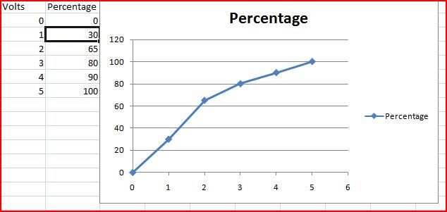

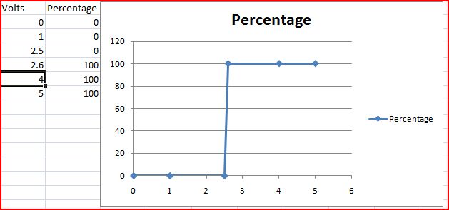

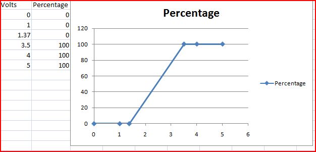

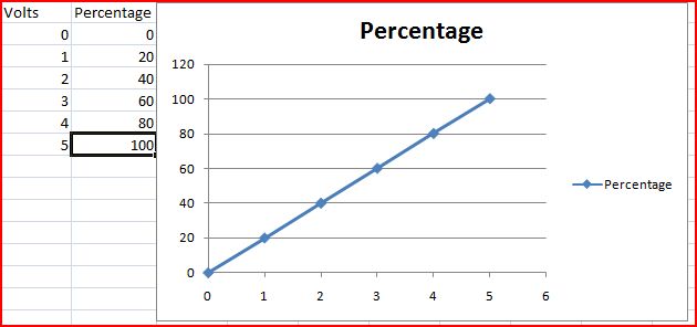

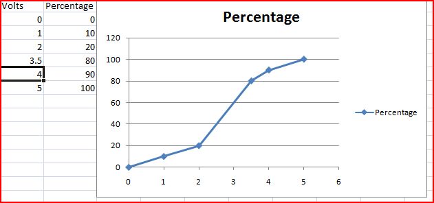

Here's what I was thinking with the 2d map for interpolation. While doing the 2d map you be able to implement your switch points as well as have the option manipulate the curve entirely with both voltage and percentage simply by changing the values. On ADC Curve 2 the vertical cut between the 0% and 100% is realisticly not at the same voltage but only .1 volts difference between full off and full on, or whatever tephra makes the increment value.
Attached Thumbnails PATCH: KNOCKCEL+NLTS+AltMap (V4)-adc_curve1.jpg   PATCH: KNOCKCEL+NLTS+AltMap (V4)-adc_curve2.jpg   PATCH: KNOCKCEL+NLTS+AltMap (V4)-adc_curve3.jpg   PATCH: KNOCKCEL+NLTS+AltMap (V4)-adc_curve4.jpg   PATCH: KNOCKCEL+NLTS+AltMap (V4)-adc_curve5.jpg

  #334
Jack_of_Trades's Avatar
Posts: 3,523
From: Opelika,AL
I see what you mean. Currently, its adjustable from 1 to 255 which is roughly .02v per increment. It all depends on what Tephra can accomplish at this point. If he does do this, as a default, you'd want it set to be less aggressive as it interpolates from map-to-map. That way people can push the limits slowly before the onset of knock, rather than having to adjusting to remove knock.
The straight line slope/curves can be implemented on either:
- ECU/ROM - User definable: but it will require a bit of computer skills.
- External device: a bit more user friendly, just a matter of trimming a few potentiometers. As long as the interpolation is defined linearily.
The idea needs further refinement for real work is carried out.
