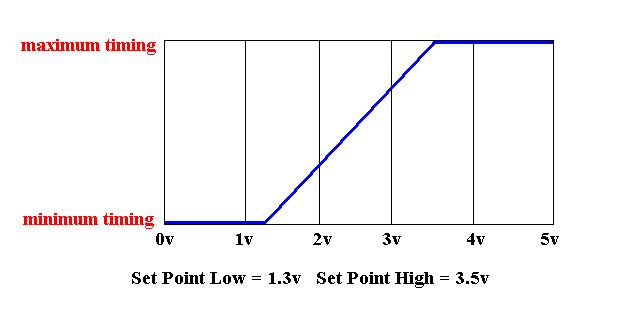

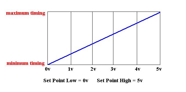

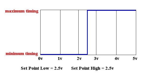

Old Feb 6, 2008 | 02:55 PM
  #313
Jack_of_Trades's Avatar
Posts: 3,523
From: Opelika,AL
So set the LOW point and the HIGH point and have it just interpolate between those values? Kind of like a S-AFC? If you wanted it to be a simple on/off switch like it is now, all you would need to do is set both points to the same value so anything below that point is one map and anything above that point is the other map.
Here are some examples of what I think you mean in the attached pics.
Attached Thumbnails PATCH: KNOCKCEL+NLTS+AltMap (V4)-adc_curve1.jpg   PATCH: KNOCKCEL+NLTS+AltMap (V4)-adc-curve2.jpg   PATCH: KNOCKCEL+NLTS+AltMap (V4)-adc-curve3.jpg
