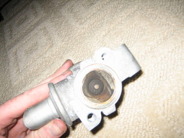

Old Apr 28, 2009 | 09:44 AM
  #117
Maikumaru's Avatar
Posts: 286
From: Laguna Hills
nevermind about the above...I guess I was tired last night...
tried fitting it before work...just to see if I was insane...
and what do you know the pipe will bolt up...
and looking at the install on the SAS install sheet...it bolts up directly above cam position sensor and below the vacuum tubing for BOV.
on a side note...if anyone wanted to make some serious anti lag check out how big the valve is...holy crap. It could move a lot of air.
