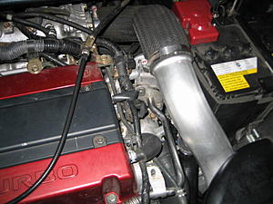

Last night we were working late to try to get the piping and valve mounted...ended in failure.
After a quick fit this morning and looking exhaustively at SAS setups, I was confident I could mount my hardware...
Learned a lesson about SAS.
Evo 7 SAS systems will not cleanly/completely mount to an evo 9.
my piping and valve will only work with the 03 evo 8s as those cars possess the mounting point on the intake side of the head and possess no cam position sensors.
I got mine mounted, but did not install the IC piping or try the wiring...it was just to jacked up and did not fit cleanly. intake cam position sensor blocked any mounting
Therefore I need a different set to continue on the sickness...
I need an SAS system off of an evo 9 or off of a 8 that possess the intake cam position sensor.
sigh...this sucks...lol

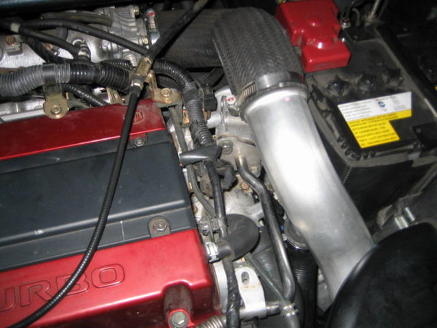

pics...
1078-->looks like success
1079-->failure:-(
but success if I had an 03 8...lol
