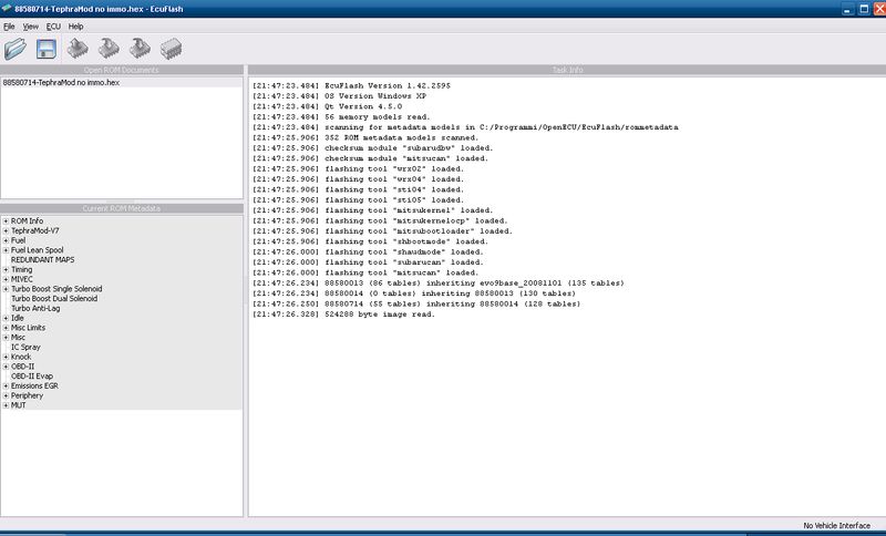

Sorry another thing...this is my ecuflash v7 screen turbo boost dual solenoid and some other maps are not able to be changed....
Attached Thumbnails **Need Help setting up V7???**  Here is your answer-ecuflash.jpg

Originally Posted by Diego 10
This evening I try the same rom with immo disabled in periphery...the car starts well and it seems drive well too,the only thing is that i saw a little differences on turbo pressure and some oscillations during full throttle...(talk about stock map) do you see something like this dparrish??
I had seen similar things when I first moved to 96530706 from my 9626 stock ROM. It was just a matter of tuning it. You can't just drop in a new ROM and expect it to run the same. There are quite a lot of tables to modify.
Specifically, I think fixing injector scaling and injector battery voltage latency compensation fixed my "oscillations" and copying across (and smoothing) my fuel and ignition maps as well as fixing the WGDC map fixed the turbo pressure.
