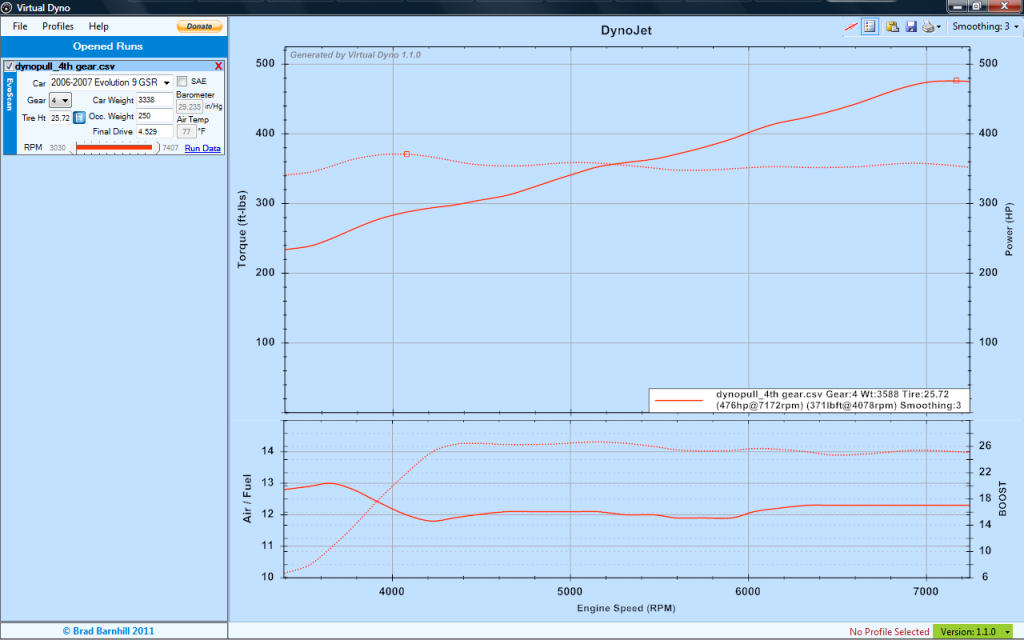

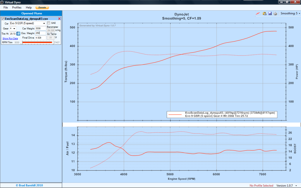

Just installed 1.1. I got a few errors upon loading up of the program, as well as a couple errors upon loading the log...
I loaded up the log, set the smoothing to 3, and log seems to be reading fine, accept the "ramp up" (spool) to full tq is kinda different...
heres a SS
1.1
1.0.7

Is it because one is set to smoothing 3 and the other to 5?

remember that smoothing 3 is more like smoothing 8 compared to 1.0.7 brad changed the smoothing quite a bit. normally peak tq never occurs before peak boost atleast on a manual controller with no boost creep occurring.

the smoothing was changed due to a problem with drop offs at the end of runs. It had to do with the way RPM and Time were smoothed prior to HP/TQ calculations were done. It has been a bug in there since the beginning. I would love to know what errors were popping up when you first installed it so may be I could correct it. Please make note of the error number and the error message.
