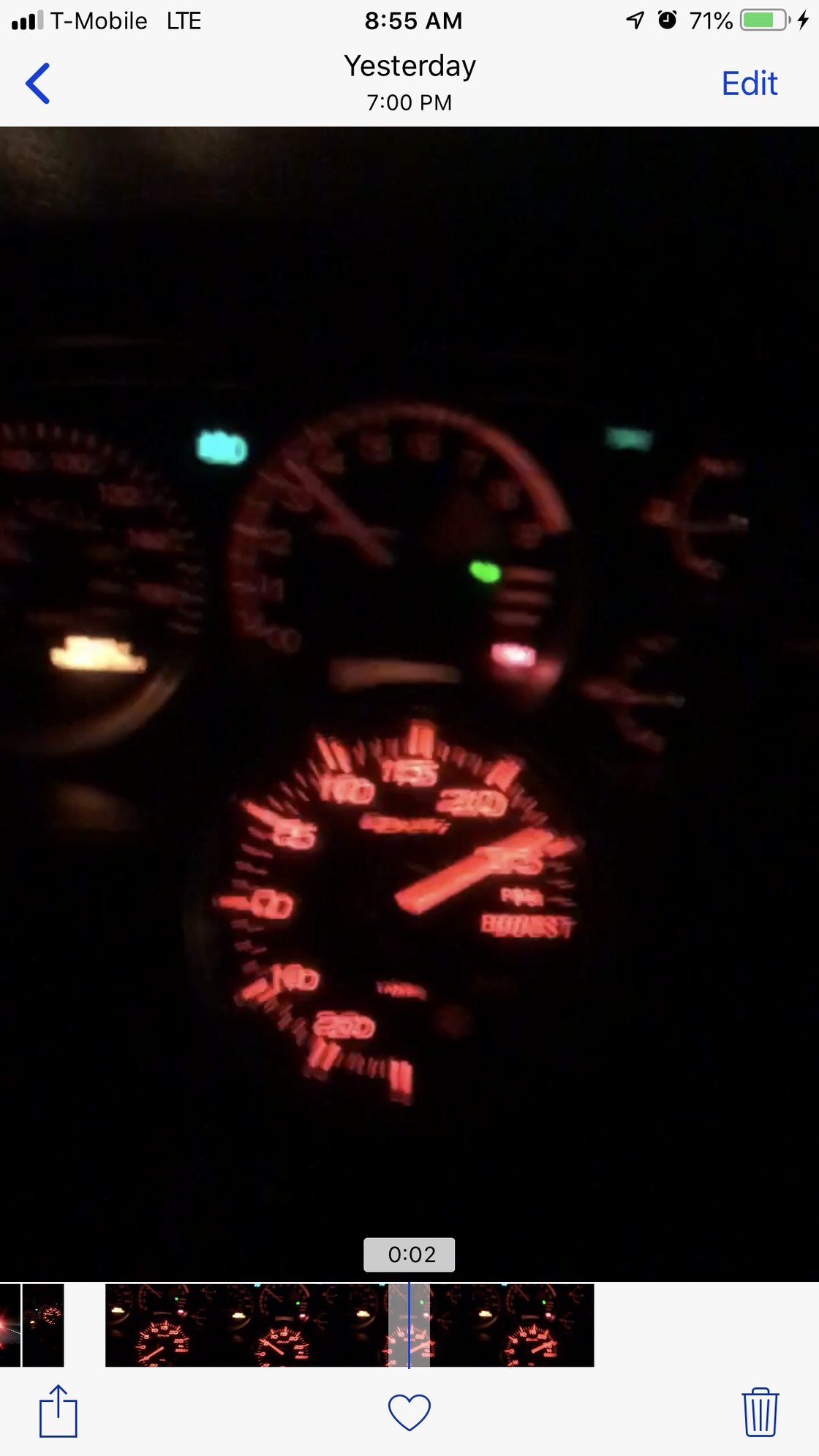

Just for Verification, i tested my spool again last night, the turbo is an HTA71 i bought from Tyler last winter, 4th gear pull i see 25psi at about 3200-3400rpms.
Old Nov 27, 2018 | 05:58 AM
  #155
Gtimportfanatic's Avatar
5 Year Member
Joined: Feb 2017
Posts: 97
Likes: 8
From: CT
Screenshot from my vid
In 3rd gear and a 2.0L? Even a stock turbo can't do that.
that was a 4th gear photo i uploaded, i can do a 3rd gear attempt and post that too lol i dunno what to tell you lol, the proof is right there tho with the 4th
Old Nov 27, 2018 | 07:36 AM
  #158
I would think i could duplicate the same run. If you lug it, in any gear, & go WOT, the boost spikes to max setting
