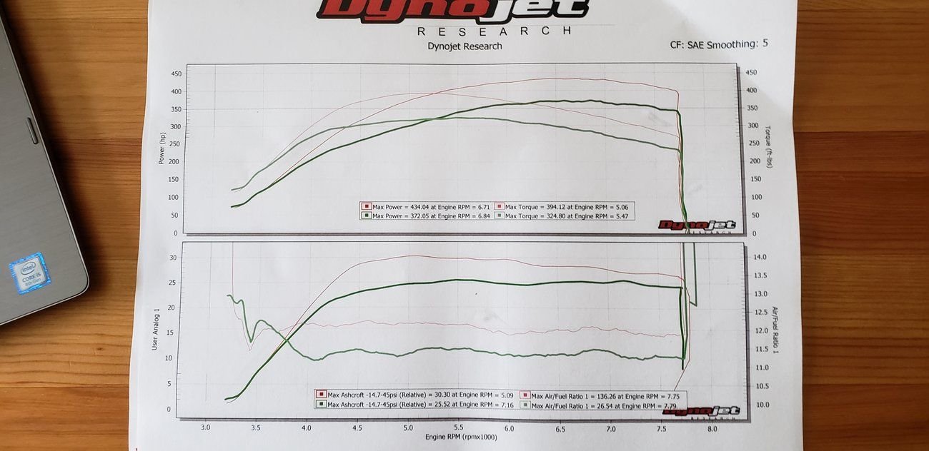

434/394 on E85 with S1s & 9.8 hotside @ 30psi tapering to 28. I was hoping for more HP but whatever, I know I have some limiting factors in the setup but right now it's not worth messing with it too much. I also wish I just went with S2s from the start.

Kinda looks like you have a boost leak from reading that graph. Spool and torque look late for this turbo. Did you check for leaks?

He doesn't have mivec to help with spool.

20psi @ 4200 rpm seems kinda late.

If he has a leak, how is he holding 26-28 psi up top?

The turbo would be working extra hard. The tuner would have seen abnormally high load values, though, unless it's tuned on SD.

Mine drops to 22-23 psi with oem WGA. Unless he has aftermaket 18 - 22psi WGA, I can't see 71 pushing that much boost especially with 9.8 housing.

Good point, he is definitely holding boost. Just seems late. But most of the HTA 71 graphs I read have MIVEC.

And have 10.8 housing. I'm not sure how he got 9.8 to fit. I only see 71hta for IX on FP site.
