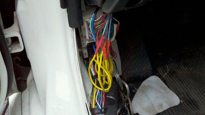

OK I have the dash lights one and car cranks but no ignition. Sometimes when it does start it won't shut-off unless i disconnect the battery.
Well I just got done hard wireing a connection and IT WAS CORRODED. So I sodered and everything. I only did hardwiring on the wires that were corroded but not the entire connection.
Thinking I have solved the problems it is still occuring. I can't start the car. It cranks but no ignition. And all the dash lights are still on. Seriously I dunno what else to do? Should I have hardwired the entire connection and not just the corroded ones?
Electrical Gremlins - symptoms and how to fix-164347_1554857999853_1487295959_31153445_4128584_n.jpg
Electrical Gremlins - symptoms and how to fix-167655_1554857679845_1487295959_31153444_2668103_n.jpg
*update* so i decided to do the whole connection and now I have no problems. Like new again.

That is a good way of puttin it but in my case they were so corroded that the pins on the other side broke off as soon as it was unplugged. I guess if you don't have broken pins that would work but in my case it wouldn't have.
