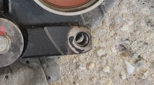

My Evo is a mix match of various 8/9 parts. I'm running a 8 Block and a 9 Head + Timing Parts (9 Belt, Water Pump, etc).
How can I tell which one is the newer revision? Kinda looks like the one I had painted black looks closer to it. My car had 1000 miles and wasn't making noise but reading through the thread I saw people who had that noise come up at 10-20,000 miles and want to avoid it

One on the left actually looks like the newer version. See on STM for reference: https://stmtuned.com/collections/mit...-block-bracket It matches the part of the bracket that looks machined.

Yeah it's just the lower section here that's throwing me off. On the revised part it looks thinner. The upper bolt hole looks identical though. I wish someone could point out exactly the differences between the new and old part (where exactly it was rubbing) to just take a angle grinder to it + flap wheel and clearance it instead of dropping $170-200 on a new bracket.

Looking at the extended part that the 3 studs thread into. You can see how much skinnier it is where it extends out from the bracket compared to that area on the painted bracket. I would guess thats the area that was causing issues but idk for sure. Thats the major difference I notice.
