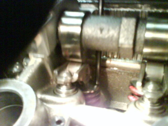

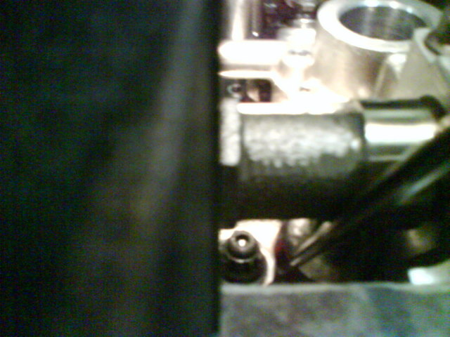

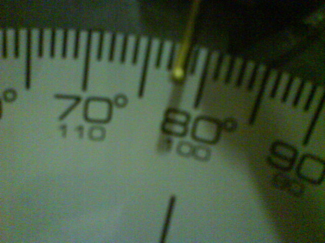

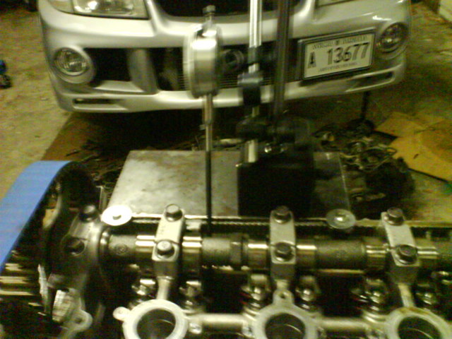

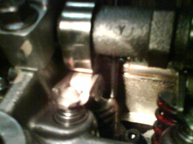

Yes I'm sorry I lost my temper I asked 3 or 4 times same question.
Originally Posted by Martin@AMS
My settings on the BC STG 3's was 4 degrees retarded on the exhaust and 2 degrees advanced on the intake to be at 0/0. All other cams I tested where withing 1 degree.
Your talking cam degrees not crank degrees right?[/quote]
You should make fixtures and a custom tip to hold a dial indicator on the retainer, get a degree wheel on the crank, figure out cam specs, find CL and adjust the cams. Not to mention the cams specs on the BC cams card are not correct, so if you go off that you'll be off anyways. You have to find the valve events on your own, figure out CL and then interpret where they wanted it. I have hours and hours into this and to be honest, since your setup can be different than mine (different deck height, head thickness, cam gears, ect), you really should degree it on your car. If the cams I measured were that far off, who knows if other batches are the different.
I know setups are different, I asked the question to get an idea of quality control on the cams being produced.
Did you use a solid lifter when degreeing them?
Any pics of the custom tip? We found the top seemed to sit on the retainer ok but I can see how a custom tip would help a lot. Here was pics from when we did my friends revolvers and other friends 272's.
